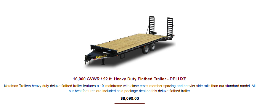

I am in the market for a trailer to haul my tractor, DK40 HST, the longest the tractor will be is almost exactly 22ft with the loader and bush hog, although 98% of the time I wouldn't be hauling it with the bush hog, and with any other attachment I'm only between 17-19ft. I was ORIGINALLY looking for a 20ft 14k but the more I thought about it I figured I'd enjoy the room of a 22ft. I called a local dealer and they actually didn't have a 22 but they do have a 24ft in stock. I haven't gotten a chance to look at the trailer yet (to check for Quality of build) but what is your opinion on a 24ft bumper pull? I will be pulling it with a RAM 2500. It seems like a lot of trailer to me but then again I'd have no worry of needing extra space.
Another question would be, is anyone familiar with Currahee trailers? That is the brand of the trailer (24ft 14k) and this dealer has quoted me almost $600 less for this 24ft than another dealer had quoted me for a 22ft GPS brand trailer.
I know that better quality comes at higher prices and I haven't gone to look at either trailer (neither dealer is super close to me and of course they are in opposite directions from me), just curious if anyone on here was familiar with either the Currahee or GPS Brand(s)
People (including me until a few years ago) pull 30 foot, bumper hitch travel trailers all the time with 3/4 ton pick-ups. I don’t see any reason why a 24 foot flat trailer would be any problem at all.
