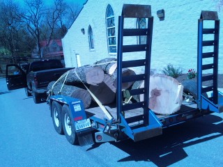

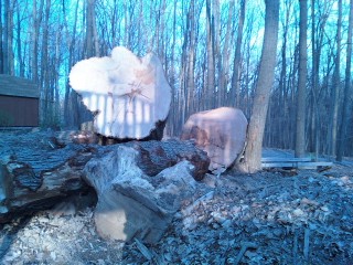

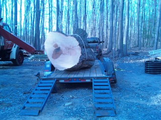

you know i just brought home a bunch of logs like that yesterday myself. they ranged from 5k to 10.5k! there is no way i would put that on a 1/2 ton. i too two trips with my 3/4 ton and then used a tandem axle log truck to bring the biggies...it was still an effort to get them home safeley.

the trailer in the pic is 5 bolt axles. 3500lb'rs
while the trailer may take more weight (if loaded right) the axles wouldnt. with a trailer weight of 2000lbs your looking at a rated playload of only 5K lbs.
could you stretch that shure. but my guess is that log was over 10K lbs.
had you had a 10K lb deck over trailer, and loaded the log right, my guess is you wouldnt have had any problems. (but 1200lbs is a lot of tong weight for a 1/2 ton pickup)
