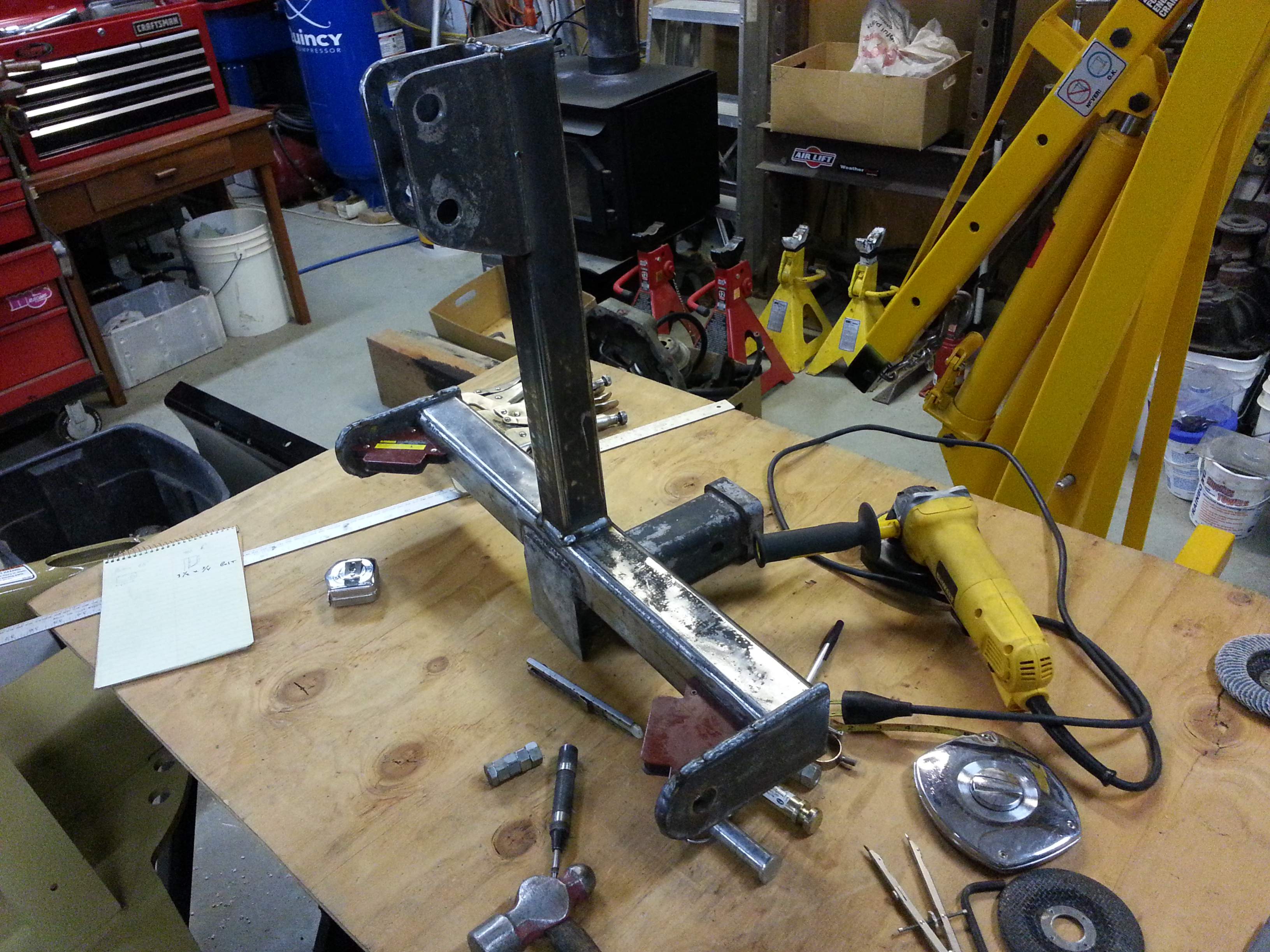

I am building a 3-point trailer hitch out of scrap iron that laying around. The main 2" receiver part I picked up at a metal drive I was part of years ago.
Anyway I am building it to attach to a quick hitch and I am looking for a bushing to go from 3/4" inside to 1 1/4" outside 2" long. Any idea where I can buy one? I don't have a 1" drill bit or I could drill out the bottom hole and use a Cat 2 to Cat 3 bushing.

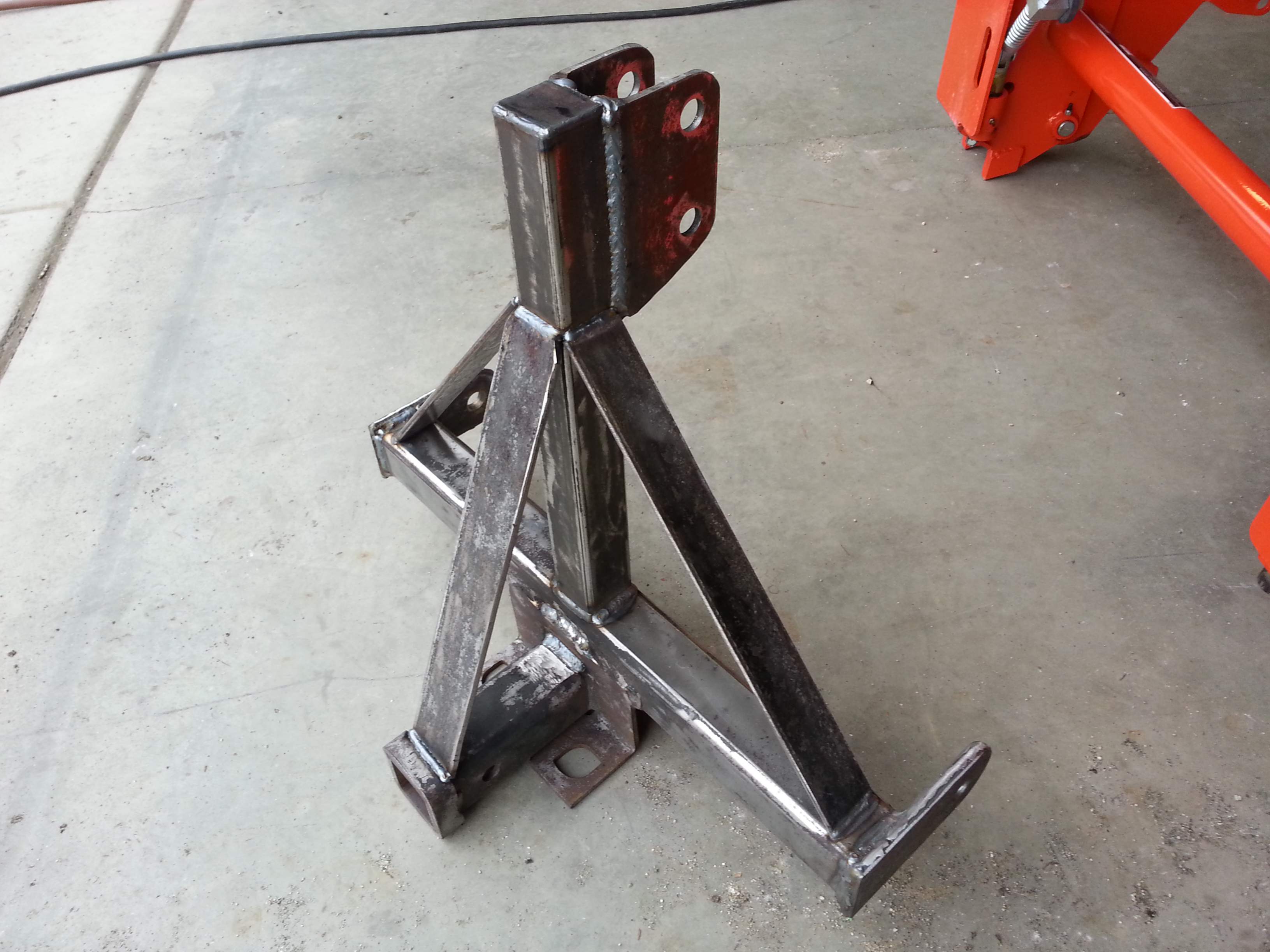

Believe it or not I have checked with both tractor dealers, parts houses, farm stores, bearing supply and two hardware stores. I found the cat 1 to cat 2 in the hardware store in town. The problem is the 2"length, I should have made it 1.75. The local farm store (50 miles away) has both in the 1.75" length. I'm going to use a couple of washers for now, to narrow the gap. I copied the design of my Landpride rear blade instead of doing a little more research. I have to chock it up to inexperience in fabricating.

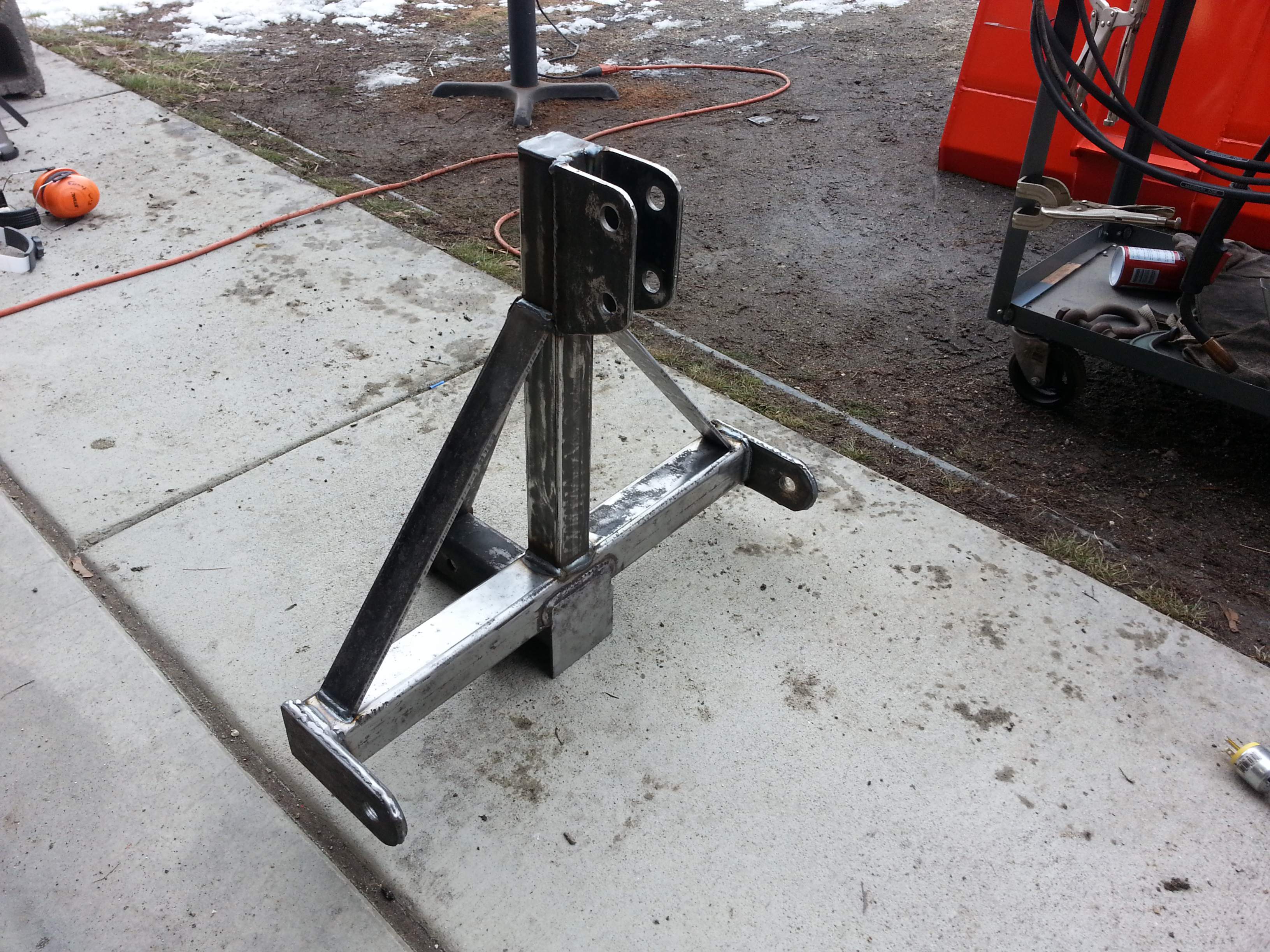

I got it done all it needs is paint now. I found the 2" top link bushings at a farm store, geeze. Anyway my first tractor project is almost done. Now for a ballast box.
