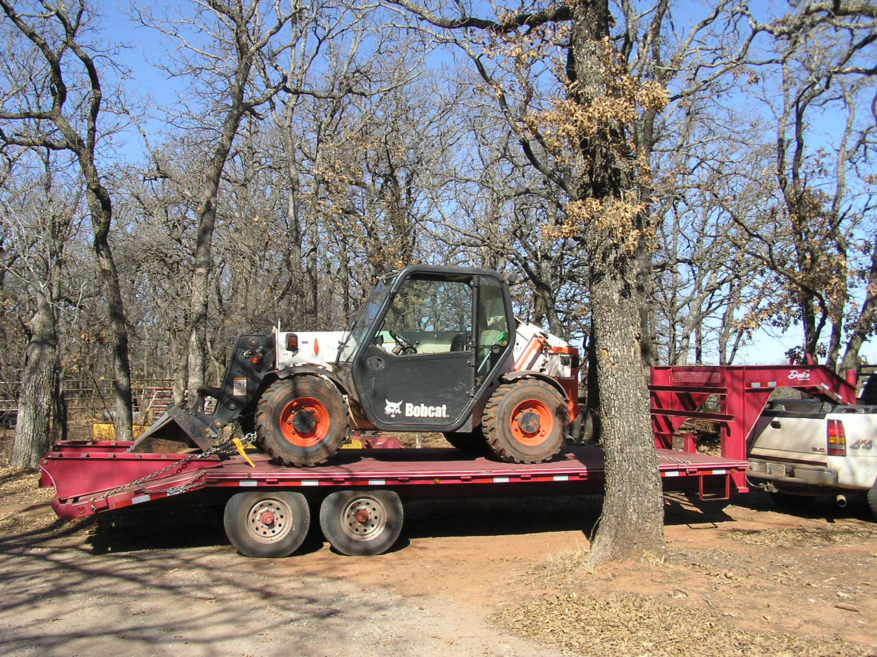

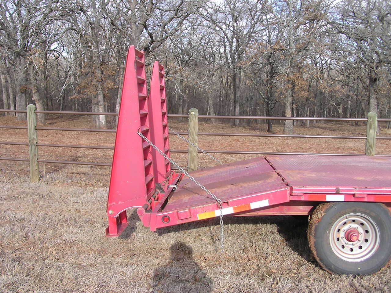

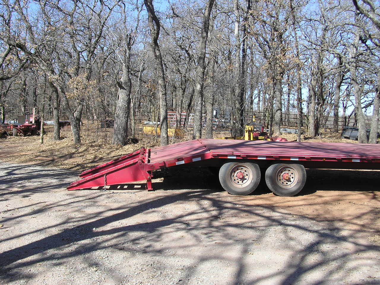

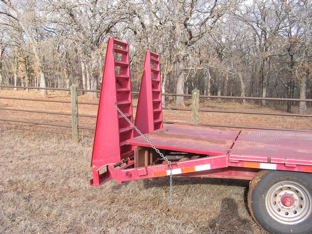

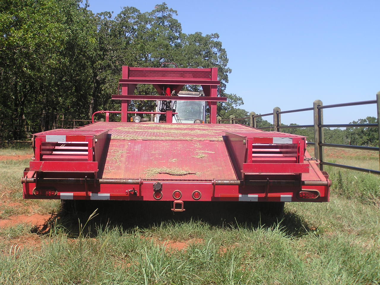

I tow with a 3/4 ton truck, have owned more trailers of all types over the last 30 years than I can remember, but this is the best one, got it in 2006.
18' steel deck plus the 4' pop up dovetail 14K gooseneck from: Welcome to Delta Trailers
Removable flip over ramps with hinged loading support legs.
Led lights and receiver hitch.
Use it this way to haul round bales.
Use it with the pop up up for square bales.
