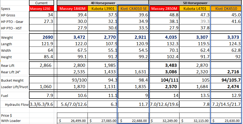

I had the same dilemma upgrading from a MF1250, which I had for 27 years. After doing a lot of research on this forum I went with the DK4510MS, I didn't want cab or HST. The only difference in scenario is the trailer which was not a factor in my decision. I am very happy with my choice.
Prices are from around this time last year.

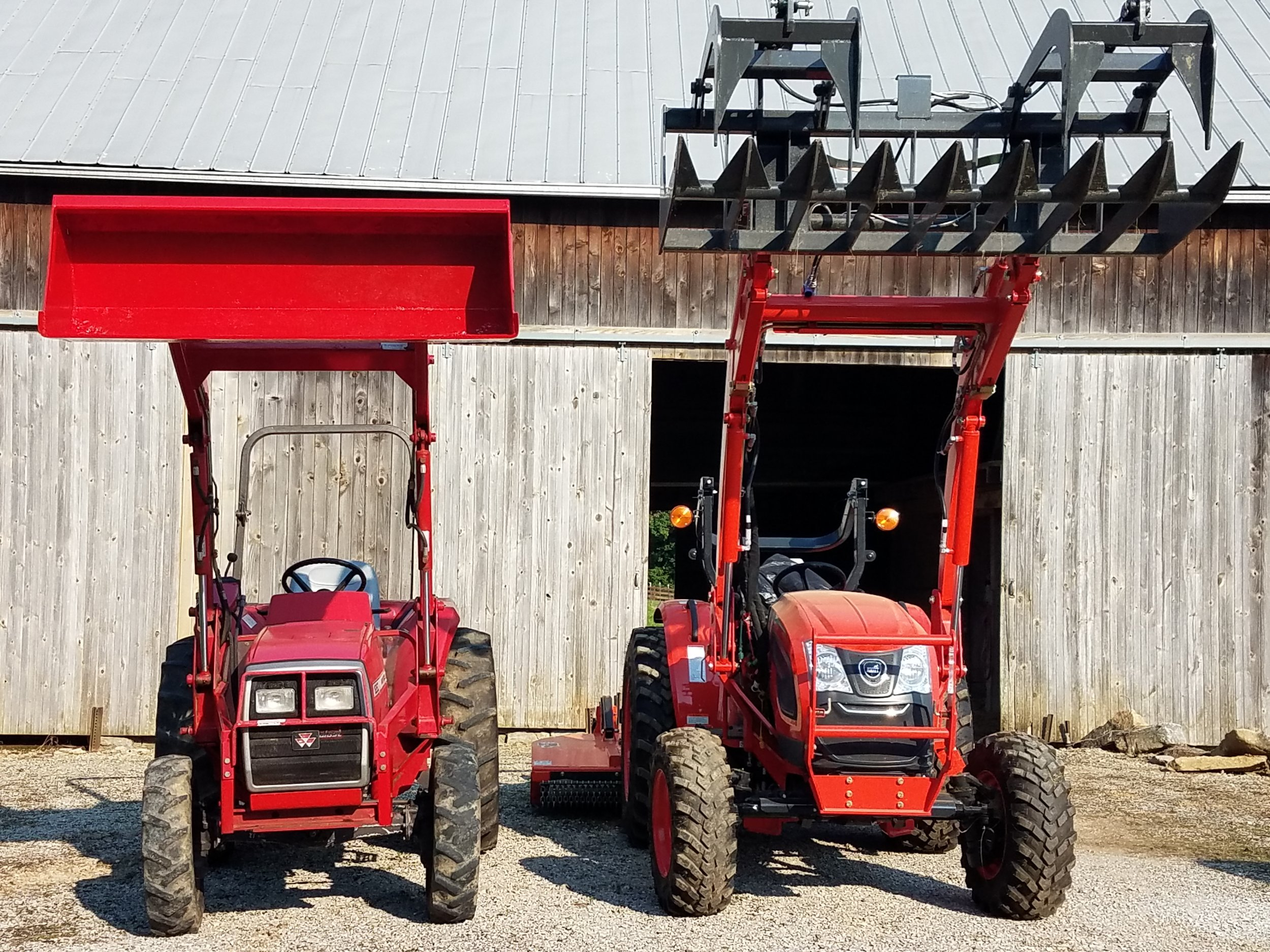

Thanks for the price comparison, most of the models I was also comparing! The photo is invaluable! How ironic for me to have a 1240 and you the 1250, essentially same thing. This is a great side by side comparison, and the DK while bigger does not seem to be enormous. The CK on paper is about an inch longer in wheelbase. It should be wider than my 1240 too (going from Ag to R4/R14 tires), and front axles isn't narrower than the rear or at least by not as much. The CK though just "looks" small. I had a dealer and measure overall length with loader and it was about 6" shorter than my 1240.
Now if I had to guess, being you didn't need the HST, the DK4510 was a no brainer for roughly $1000 over the CK. In my position HST is a no compromise. I have one on my garden tractor and have been spoiled with it's efficiency. Also wanted to have more features. I'll tell you though that price comparison between DK4510 and Kubota L4701 is astonishing.
