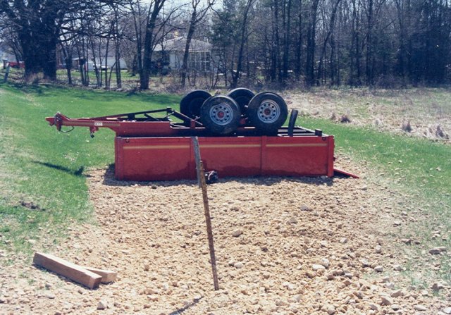

I bought a new dump trailer about 10 years ago. The dealer said it had a 2" ball and he connected it to my RAM diesel. I was too dumb to check the ball size and didn't know a whole lot about ball sizes at the time since I had never owned a trailer with bigger than 2".
I towed the trailer about 100 miles home with no problem. I left it on the truck and the next moring I got a 3 yard load of gravel. The gravel pit is about 5 miles from home. About a mile from home, doing about 35mph I hit a bump and the trailer (2 5/16 ball hitch) came loose. It rolled the truck up on two wheels before the chains snapped and the trailer went into the ditch. It took out a farmers mailbox. I think the seat is a bit puckered too. I thought I was going over.
I put a stop on the check and called the dealer. My lawyer said since he hooked it up it was his responsibility. I ended up having the trailer fixed, replaced the rear bumper on my truck, and deducted it from the price and sent him the difference. It was quite a learning experience.
