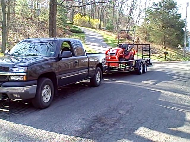

My neighbor loaned me his 18-ft Big Tex Trailer to transport my BX25. He uses this trailer to transport his Kubota L-35 Backhoe. Here's a pic of my BX on it.
