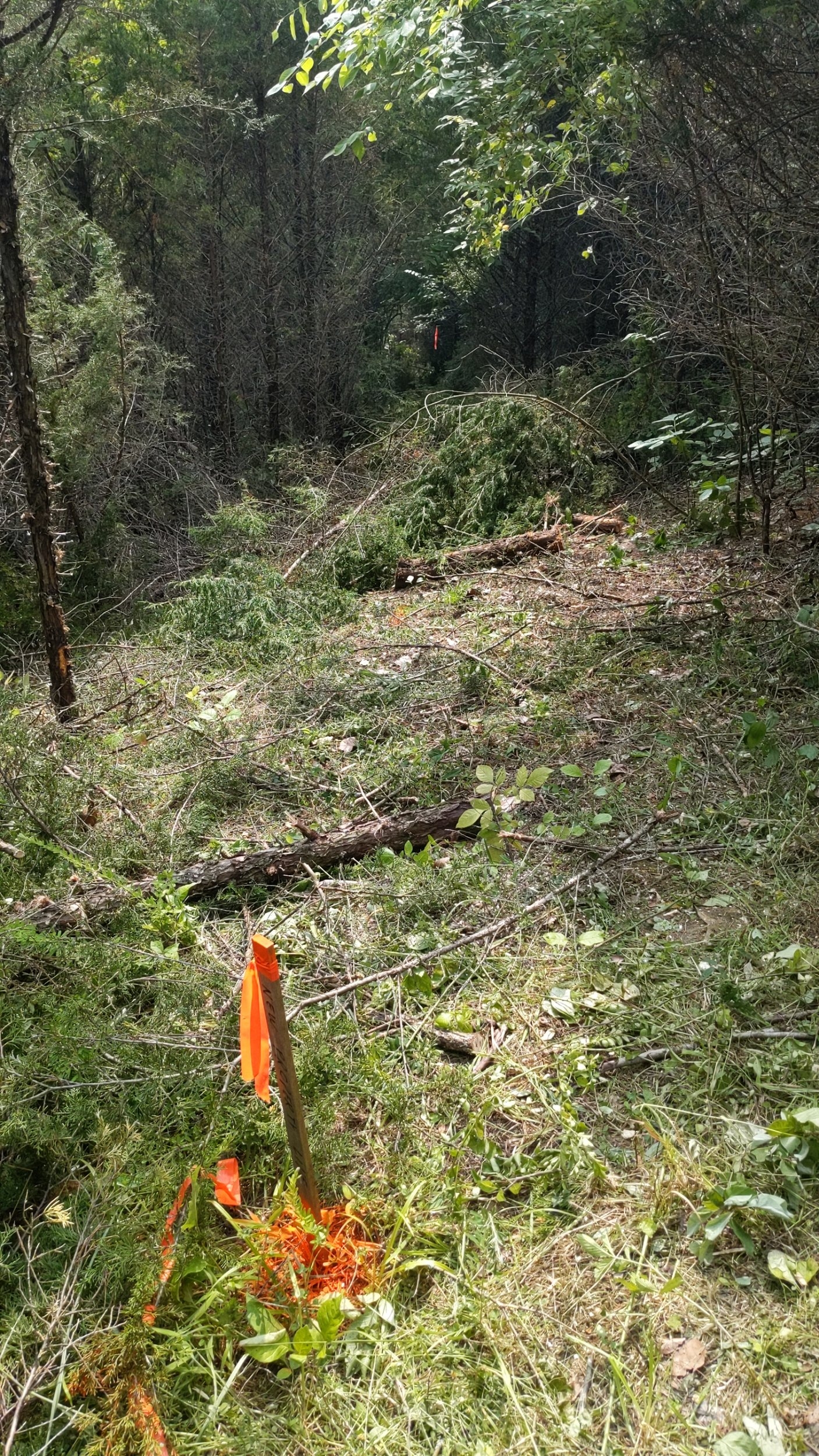

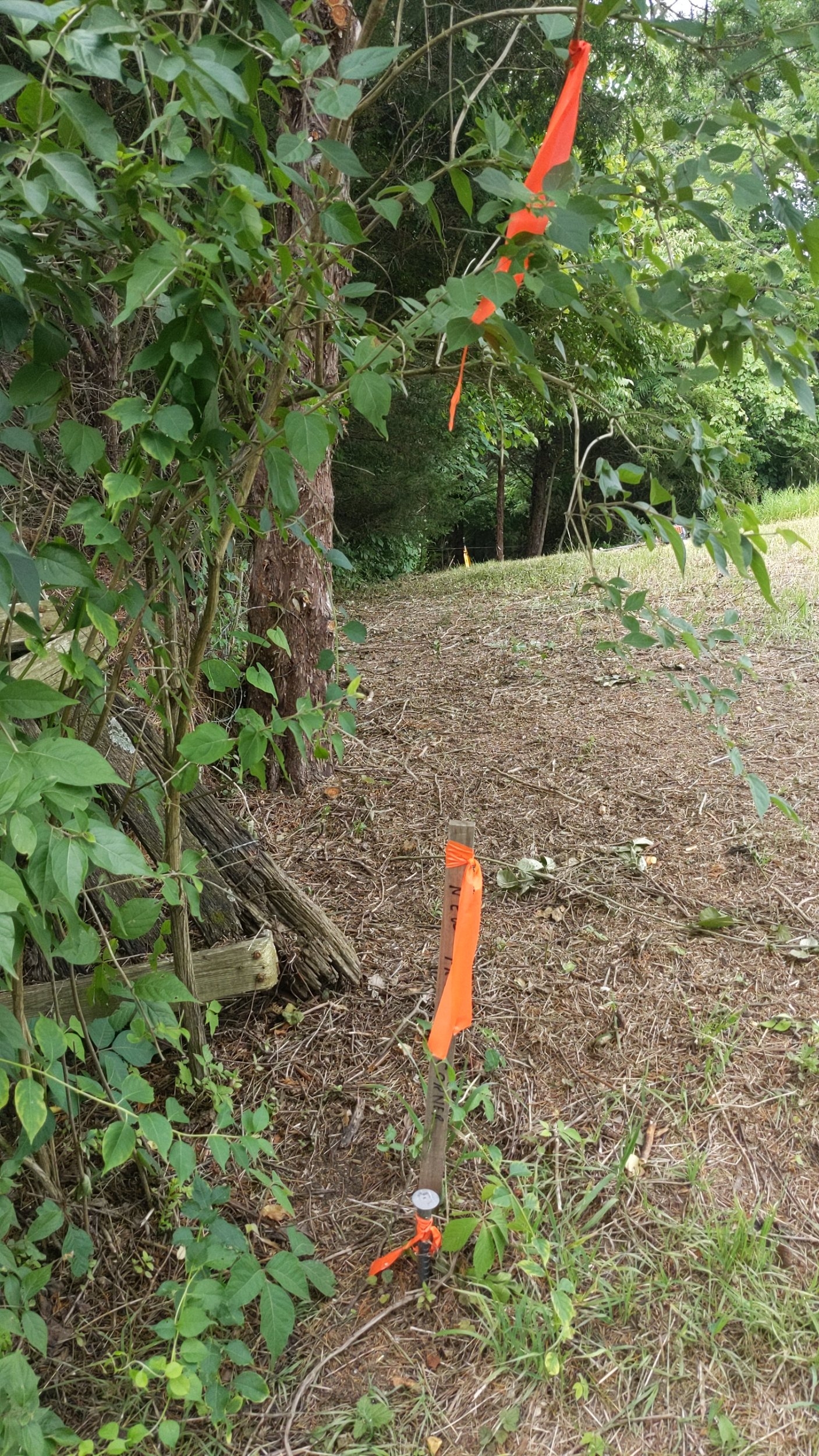

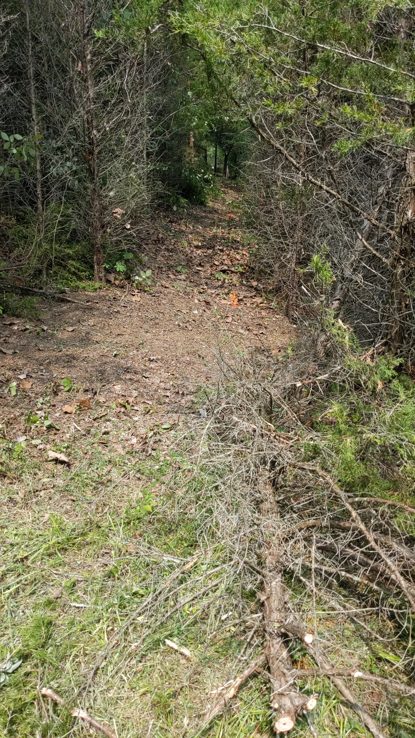

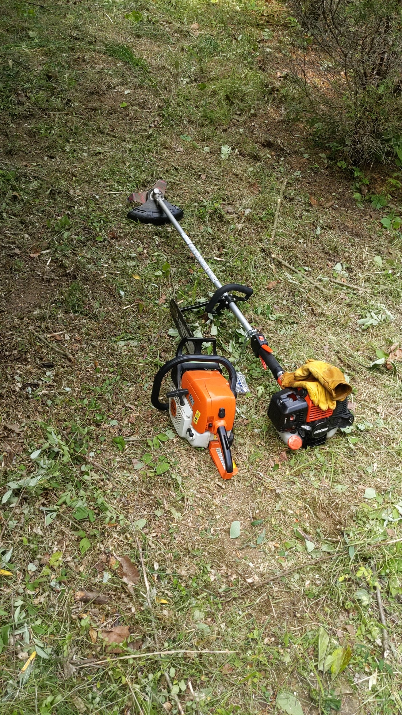

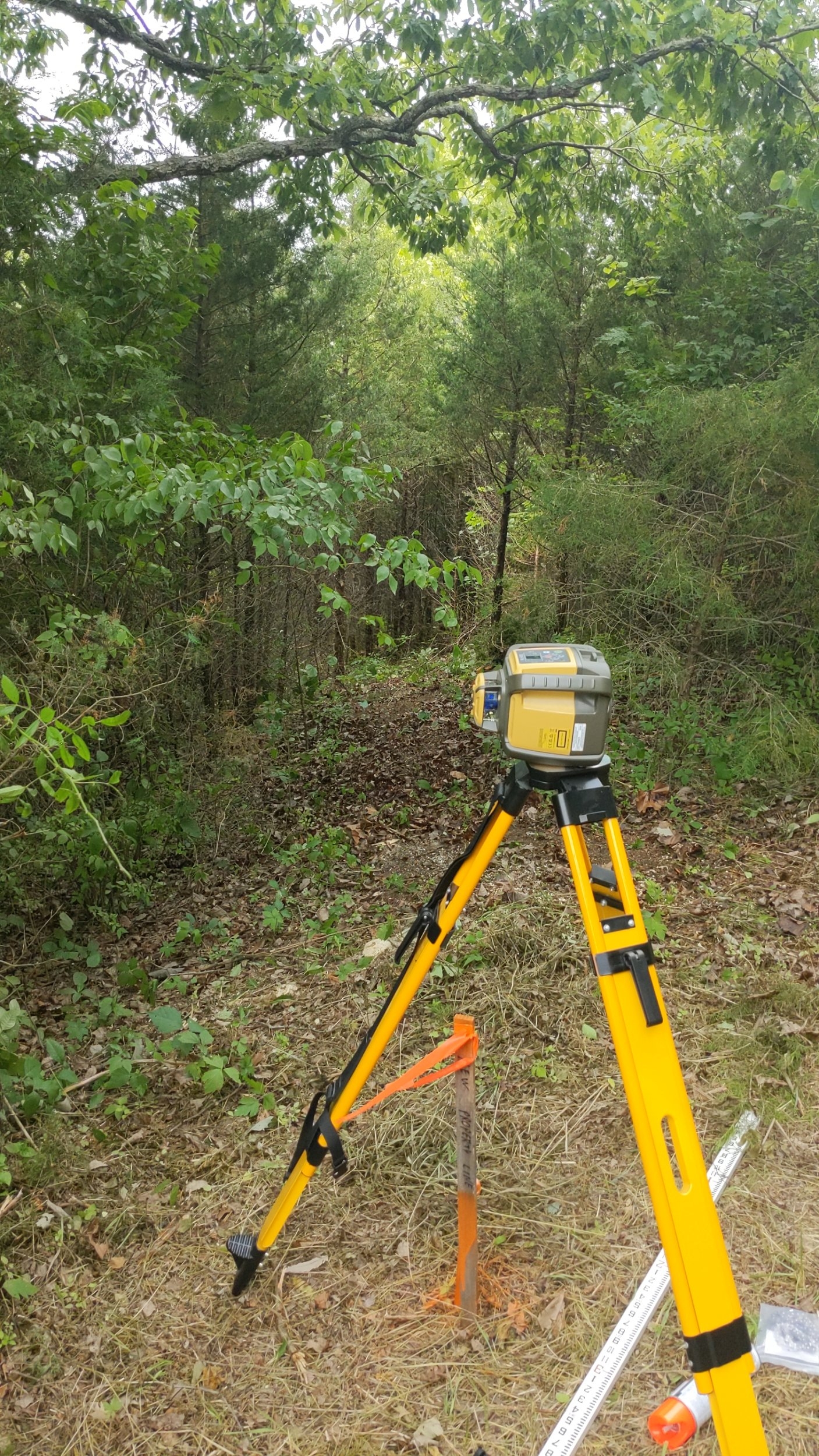

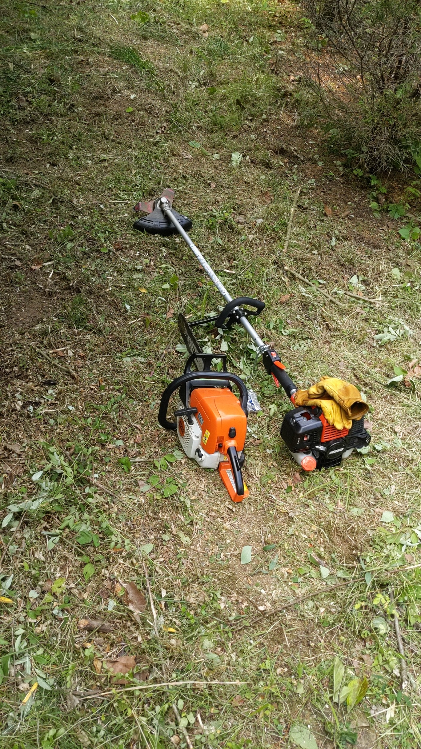

I'm working to clear a new property boundary through heavy woods on 6 to 20% slopes. I'm impressed that the surveyors got into some of these spots to drive a stake.
I'm using a Topcon grade laser to follow the path. The stakes, some of which I didn't know were placed, all are falling dead-on to the path. You don't know they're there until you're within about 10-15 feet sometimes. I'm using a chainsaw and a large Echo trimmer with a steel, triple-blade head to cut the path. There is LOTS of surface rock around, and the steel trimmer head, though making regular contact with it, is holding up very well. It is incredible how well it cuts small trees and of course the thorns and brush.
Here are a few pictures.
View attachment 808168View attachment 808169View attachment 808170View attachment 808171

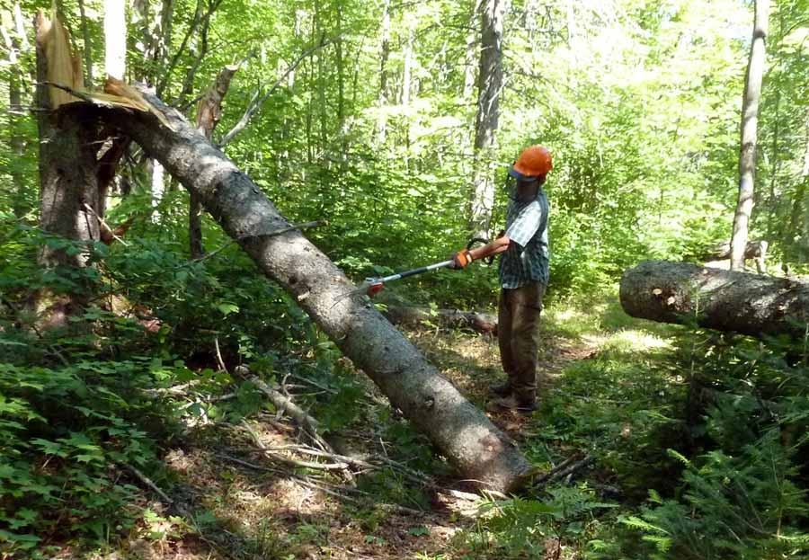

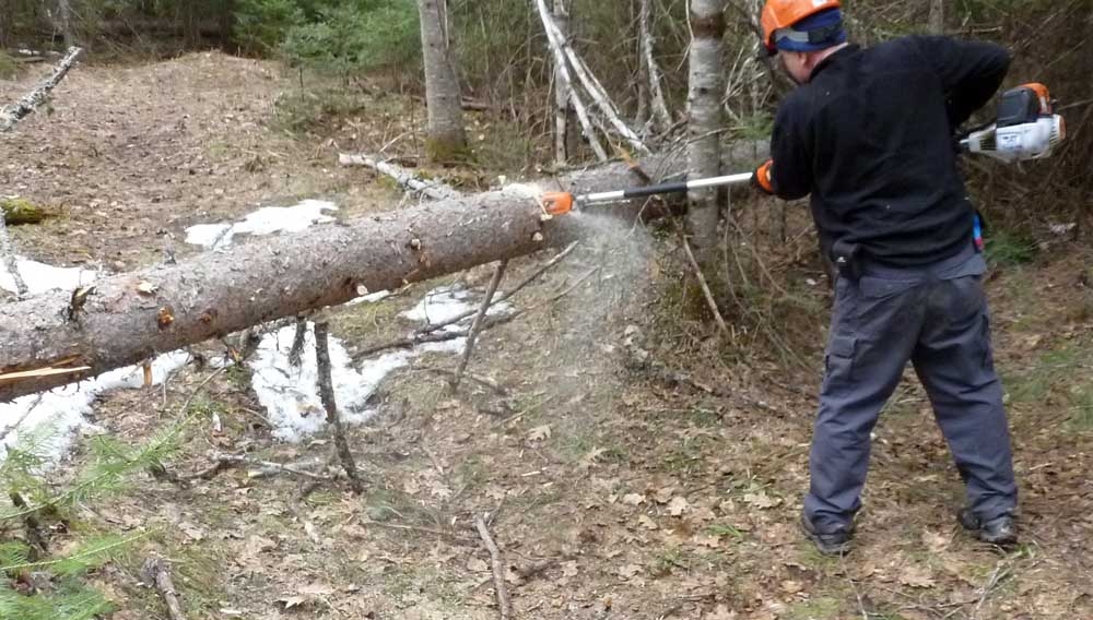

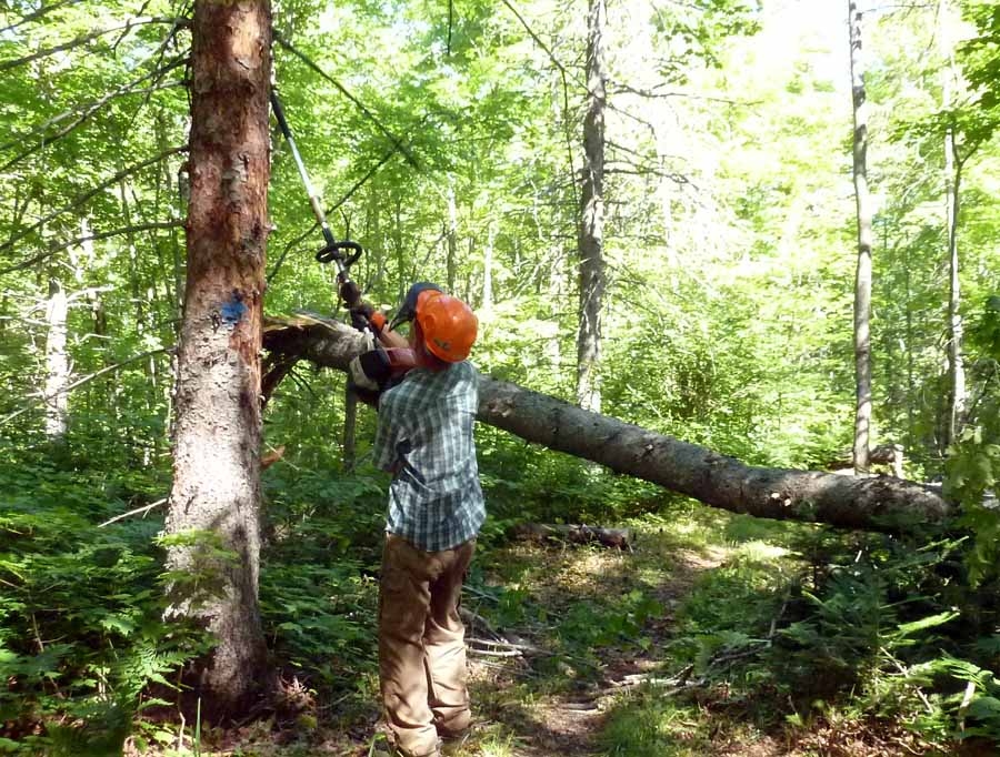

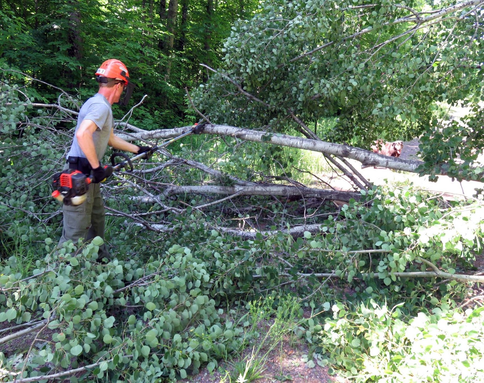

Looking at these pics, I'd suggest getting a pole saw. Not a telescoping type.

I second Arly's recommendation to get a pole saw. It's a very useful tool in its own right, but it also gets you further away from the brush when cutting than a chainsaw. That could be very valuable when clearing a dense area that probably has some rattlesnakes in it.

Rather than cut those trees in the middle, which can pinch the saw, we place short pieces under the tree perpendicular, drop tree on short pieces, then cut it up.
Also, the pole saws aren’t really designed for large logs. The tiny driveshafts in my Stihls Kombis are too light for large diameter logs.
Better off with a standard design chain saw.
