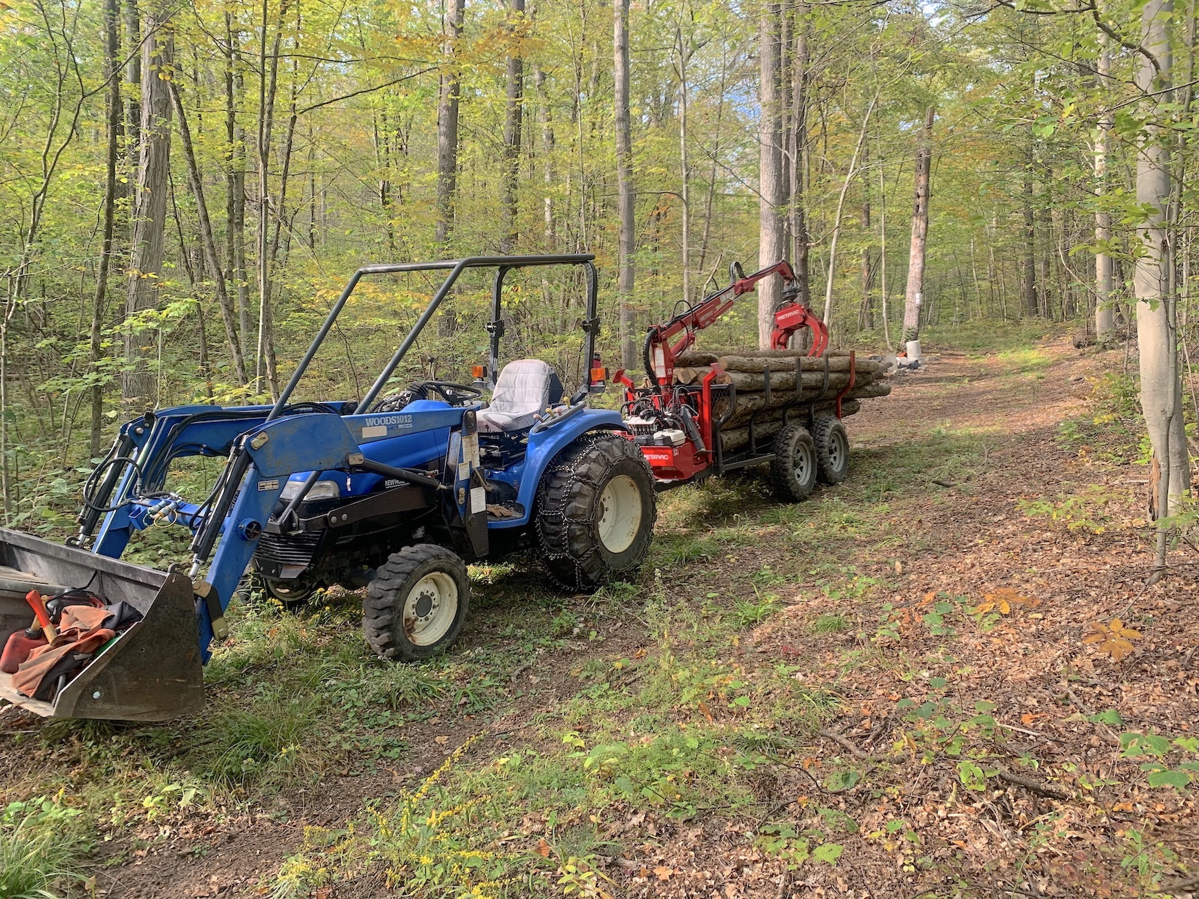

I own a forwarding trailer, but it's on the heavy side for use behind an ATV or SXS: it's probably close to 1500# empty, and can carry a 6000# payload. Mine is too small to be of interest for a commercial logger, and too expensive for a typical landowner to consider just for personal use (I got it used with only about 50 hours on it for a good price). Mine has the optional hydraulic winch. It's much slower than the 3 Pt Hitch logging winch on my tractor, but it is handy reaching logs that are not right on the trail. Given the limited reach of the boom, I would not own one of these trailers without a winch.
There seems to be a big gap between the lighter models intended for use behind a 4-wheeler: about $3000, rated for 1 ton with the boom manually operated (swing by hand, hoist with a hand cranked winch or a small electric winch) and those designed for use behind a tractor ($20,000 & up). There are a few on eBay in the middle ground, around $8000 with a 3000# rating. Pictures show them in use behind an ATV/UTV, but I imaging the load would exceed the tow rating of the ATV. Some have an optional hydraulic drive on the trailer wheels: helpful to get moving again when stuck, and also act as a brake when going down hill (movement is rather slow then the hydraulic drive is engaged).
Here is mine hauling some firewood home after doing wildlife mast tree release and trail cleanup:

That looks like a pretty hefty investment. You must be doing a lot of work with your forwarding trailer?
/ trail clearing technique and tools #665
Way too expensive for me to buy new. I had been wanting one for years, but just could not justify the price. The used ones which came up for sale were far too big for my needs and/or beat to death. I got it for a little over half what a new one ran at the time. If I had to pay full price, I'd still be wishing for one while using my home built, run-of-the-mill woods trailer made form an old mobile home axle. I'm afraid to even look at what they cost new today.
I use it on my own property, and helping out abutting landowners, at another wooded parcel owned cooperatively by 16 families in the area, and in support of of our local firewood donation program. I don't own a sawmill, but a neighbor does, which creates opportunities for barter. I'd guess the use is split roughly evenly between firewood and sawlogs, though most recently, it's been heavily slanted toward firewood - between storm damage and clearing culled trees from some crop tree release I'm doing on my property.
I don't work in the woods professionally. I bought it more to make my life easier than for financial gain (which is pretty much the same reason I bought my tractor). I'm sure if I ran the numbers, it would still be hard to justify financially. If I sold all of the logs and firewood I brought out of the woods rather than giving it to friends or bartering it, it would probably be justifiable. However, if I didn't own it, I'd find another way to get the wood out.

Do you drag trees out of the forest with a winch or something to get them close enough to the forwarder trailer to pick up? Or do you cut an area like in the photo where there is room to use the forwarder without any winching?

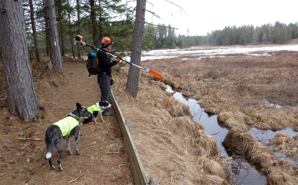

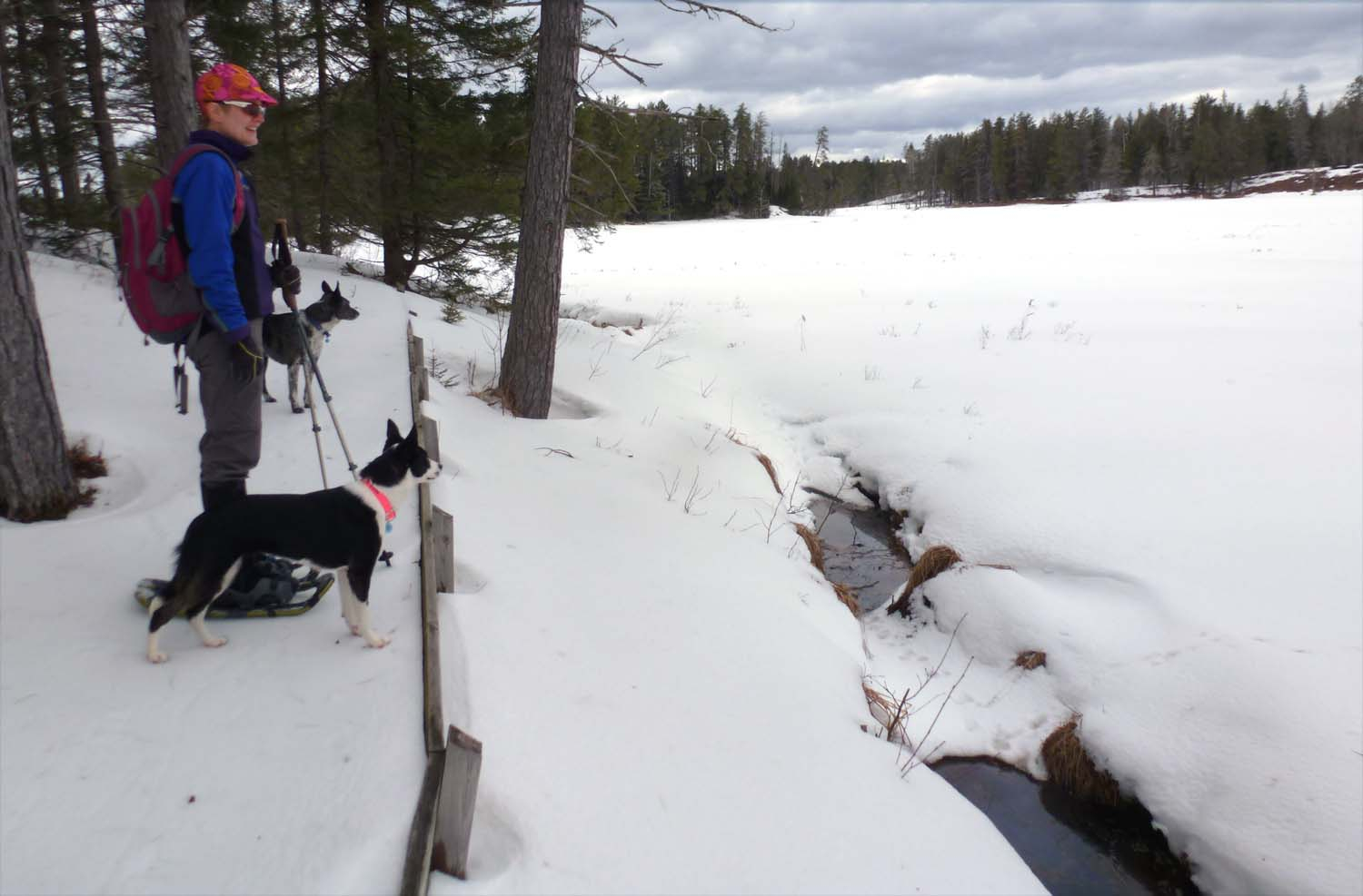

We are still in snow here but thinking about trail work this summer. Looks like we'll have an spring early here. These photos are recently taken of bridges on our trail. What will you be doing to yours?
The first photo was one of my trails. The second was a clearing I made in the woods behind our local elementary school for an outdoor classroom area that was part of my daughter's Girl Scout Gold project (similar to an Eagle project in Boy Scouts). That's not my normal mode. I do very little clear-cutting, unless I'm making an opening for wildlife such as when creating early successional forest habitat.
Most of the time I'm working in fairly dense forest stands, thinning to favor targeted trees/species either to improve timber value or to encourage greater food production from mast trees (my current Crop Tree Release project). I enjoy the challenge of figuring out how to get the cull trees down in crowded conditions without damaging the trees I'm trying to promote.
Since I don't want to build a trail up to every tree I'm taking out, I generally use my 3 Pt Hitch logging winch to get the trees/logs out the the edge of the trail. My winch has 230 ft of cable on it, but it's rare that I use all of it. (When a log is 200'+ from the tractor, with intervening the hills and the trees I often need a spotter to see what's going on at the other end of the cable.)
Once they are trailside, I'll generally load them on the forwarding trailer to bring them home. If it's firewood, sometimes it comes home as long logs, other times I cut and split it trailside and load it into a trailer right off the splitter.
If the trees are already near the trail, I might just use the winch on the forwarding trailer. It's limited to 100' of cable and a LOT slower than my logging winch, but it beats taking two steps for something that is only a few feet out of reach.
