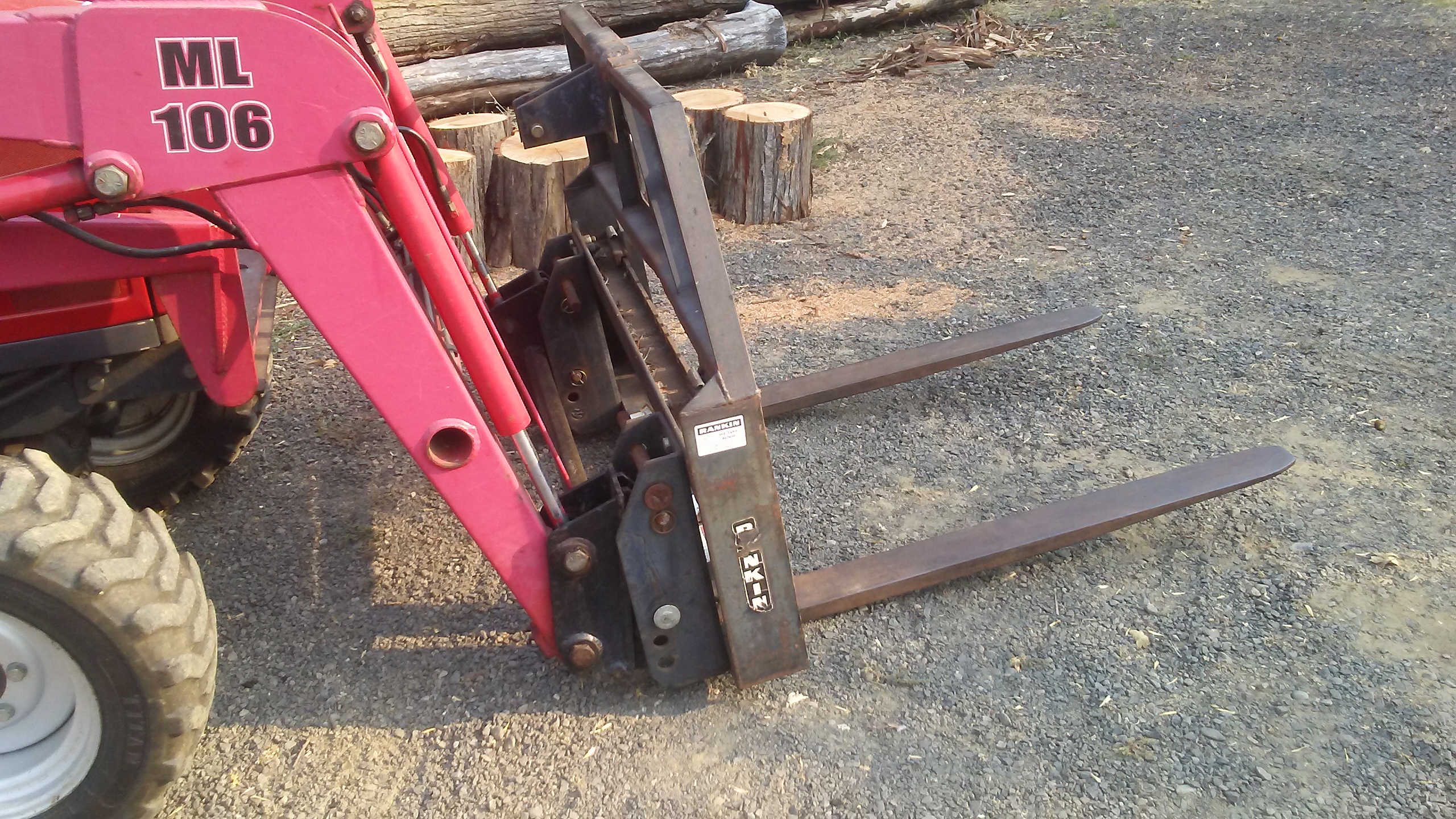

My ever faithful, 2003, Mahindra 2615 in action.
   / Tractors and wood! Show your pics #6,664
That's a hefty looking set of forks that you have on that!!!
   / Tractors and wood! Show your pics #6,665
Those are Rankin forks, 3,600 lb. capacity. A bit heavy for than I need for most jobs, but when lifting logs from the pile, I wouldn't want a lighter duty set. My dealer had these for $700.00.
I have them set up to go on the 3 point hitch, too.
