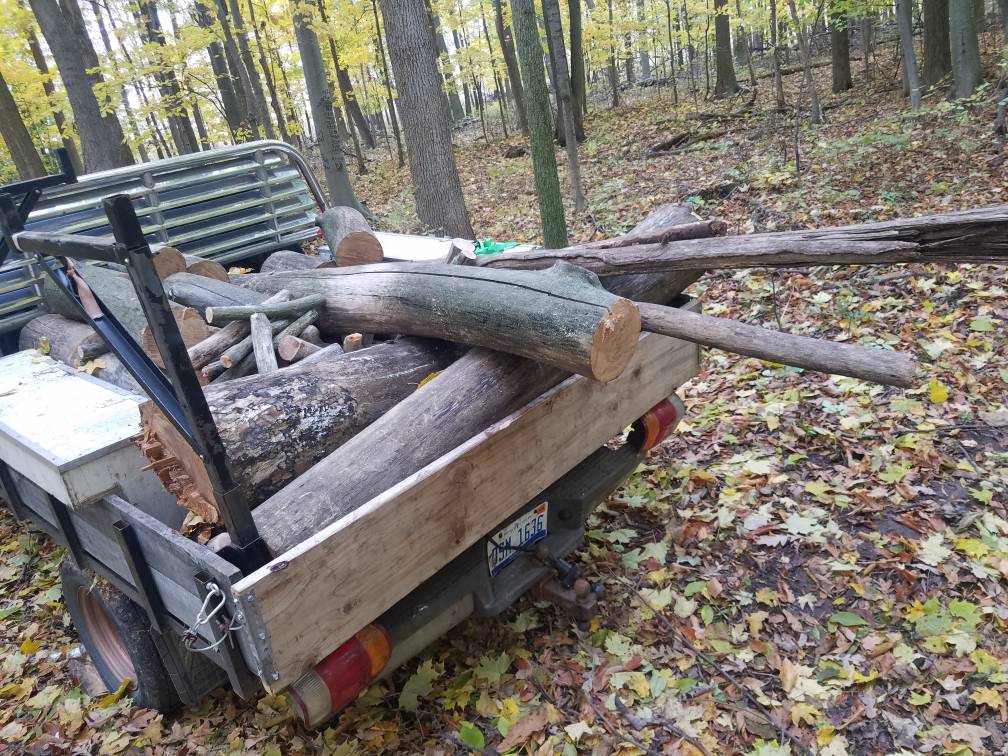

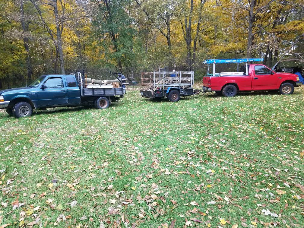

No tractors yet in the woods but I figured I would show off our loads.
The ranger is all from one dead elm tree and trailer is a mix of ash and cherry. Would have loaded the trailer more but was in a wet spot and truck is only 2wd and frame is not great. Had one more load earlier in the ranger and a ranger bed as a trailer but no pictures. Chainsaw got dull and didnt have the right file and the other chainsaw snapped a chain. 20181027_161458.jpeg20181027_161315.jpeg
