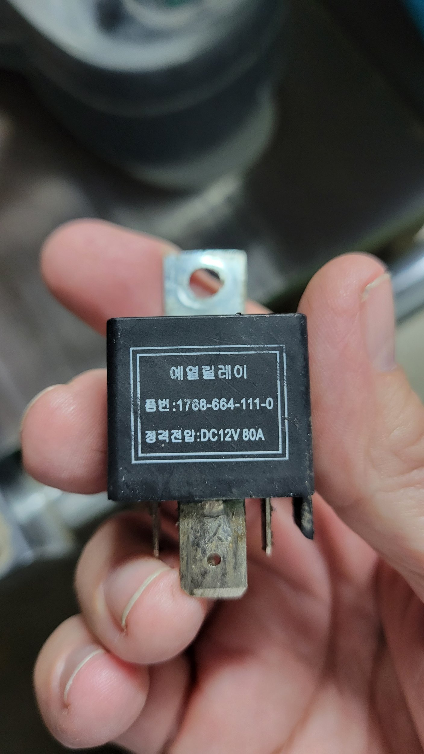

I had an issue with my 3550 with the key switch, which would allow crank, but intermittent start - because it would lose power to the middle pin when you rotated the key further to the start position. So sometimes right as you let go to stop cranking, it would fire up as it made contact again.
Not the exact same symptoms, but you have definitely narrowed it down to an electrical issue. Whether that's a relay, bad key switch (like mine, just broken in a different way), broken wire, corroded contact - you can find by checking one part at a time with a meter.
   / Tractor won’t start tonight.
#32
Do you have a starter relay? The one on my 2538 failed and had to be replaced. Mine is on the left hand side just behind the battery. Edit: it bench tested fine but would not engage the starter.View attachment 775731
I have three or four of those behind the battery but up high enuf to reach. They’re basically right in front of the radiator. I dont know which one is which because the elderly widow who I bought the tractor from did not know where the manual was.
