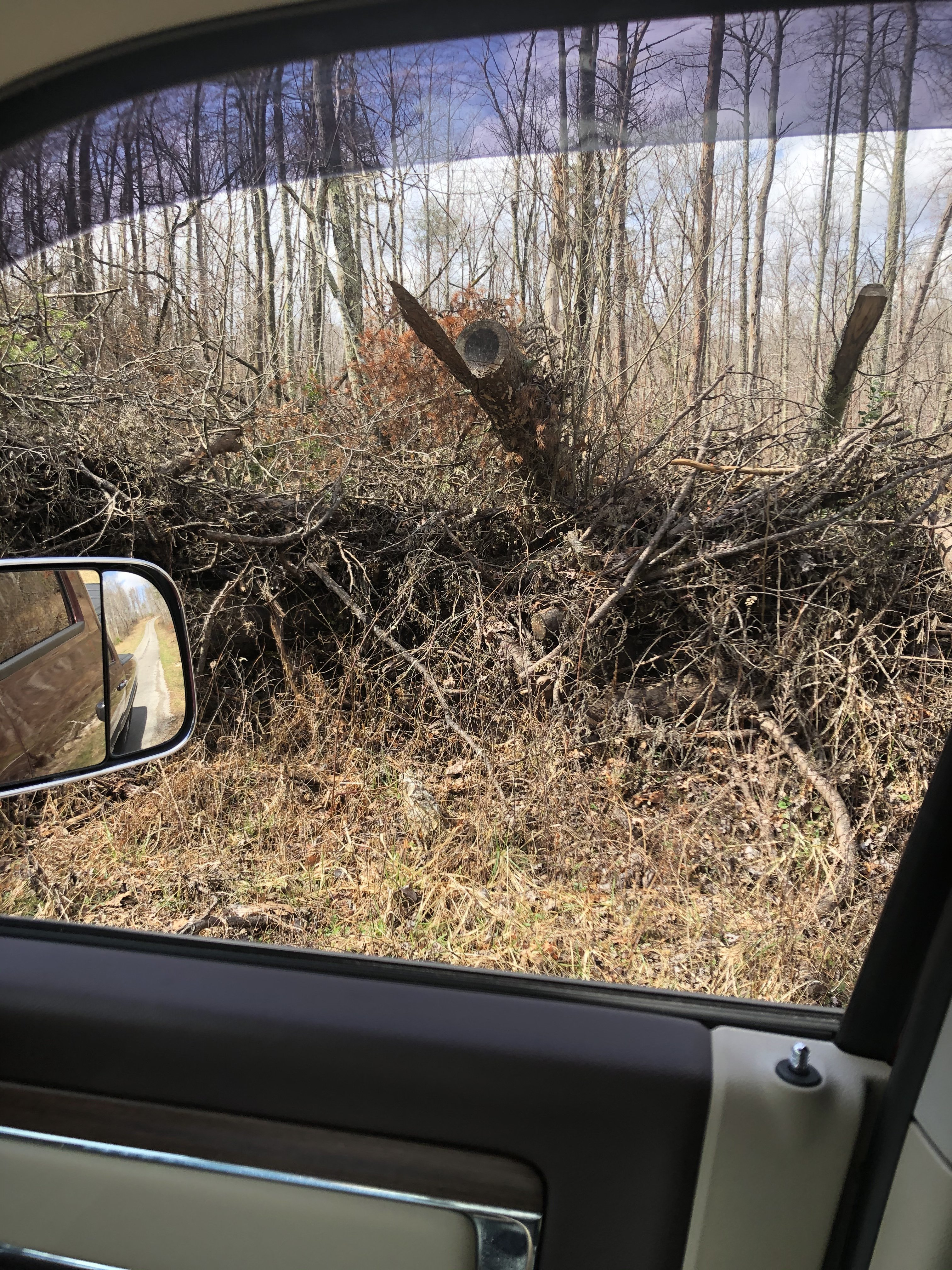

From the responses I have been getting, I figured I would go and snap some pics with my cell today. Plus, its not pouring rain today!

Yes as you have figured out bigger is not always better !! Smaller tractor cut trees into smaller pieces I use pallet forks to haul trees and branches. BH very debatable on forum I have BH 92 on L4701 very impressed with its performance on my 20 acres 100s of tree stumps dug out.I spent over 25 years running Excavators and full size BH JD 410 was the last one I ran my Kubota pound for pound is excellent for home -property owner.I’ve rented excavator when I burned my trees up Ex 85 Bob cat with thumb did not want to use tractor on very large pile getting to close to heat my personal preference.I have a neighbor who does food plots mowing of trails he went with Kubota 3901 for narrowness it tight places and he’s been happy with size.If one takes there time and knows limits of there machine the job will get done and operator and machine stay intact.Good luck with new tractor purchase Kioti or Branson should serve you well keep us posted when you pull trigger.
Thanks for sharing. Impressive resume. Yeah, if I wanted I could just drive up and get my bigger tractor. Would save me $25K. Plus, my wife wants a smaller tractor to help me out.
I have watched lots of videos and have read this and other forums and I am convinced a 25hp tractor could get the jobs done. I just dont have any experience with smaller tractors and there are so many manufacturers. I had never even heard of TYM, Branson, Yanmar, LS, Fendi until I started looking. My observation is that it really doesn't matter which one of these I go with. The engines are Yanmar or Mitsubishi, all from South Korea. Weight, hydraulics and customer service are whats important in this class of tractor.
