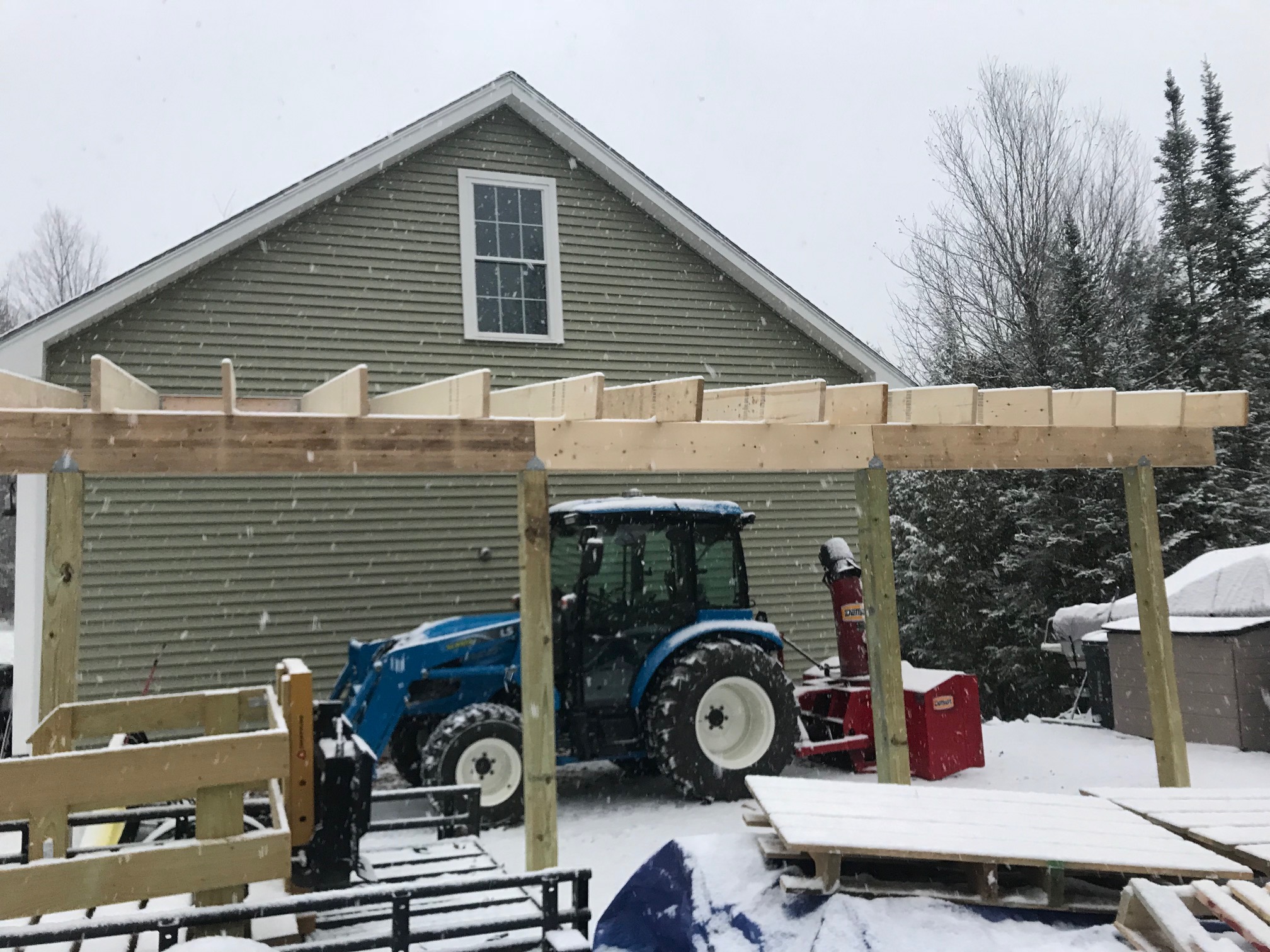

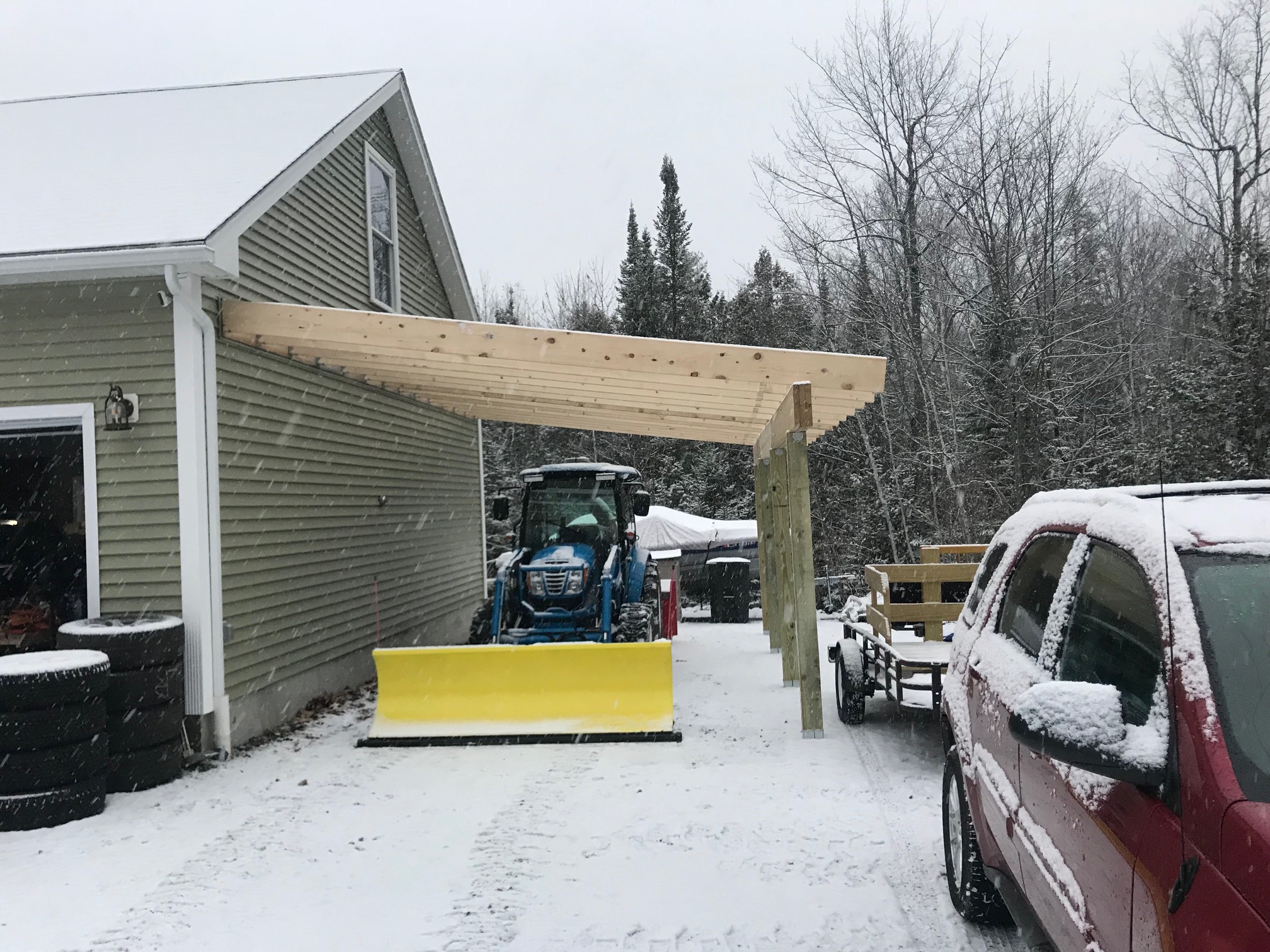

I was somewhat in your shoes. I plowed my private road (3/4 mile) for years with beater yards trucks. I got sick of buying/fixing/selling the trucks so I bought a Tractor with a cab. I ended up with a LS 4140HSC. I used one of the 7.5' plows from one of my old trucks and mounted it to a QA setup. I ran the hydraulics from the rear remotes to pivot the blade from side to side, I also found a rear mount blower 72" with an additional 6" of wings. I normally use the mid gear and find it works well, but is no where near 9-10MPH, maybe 3-4MPH. The snow doesn't roll off like the truck did. I had to change the way I plow. I wouldn't go back to a truck at this point. I can get the road MUCH wider with the tractor. What I have found myself doing with any snow over 6-7" is to plow the snow into the center of the road, then blow it into the woods on my last trip. IMG_9779.jpgIMG_9781.jpg
