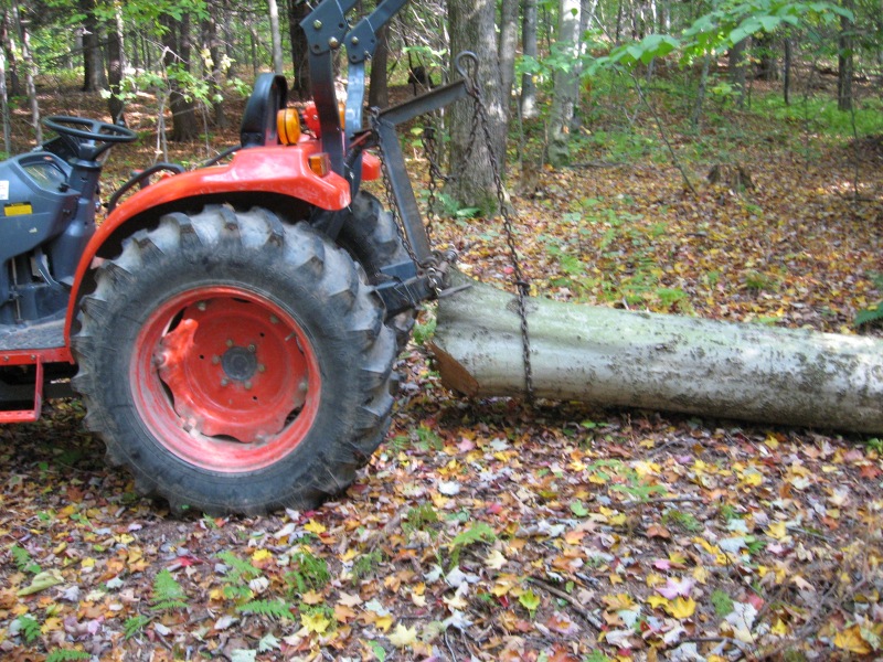

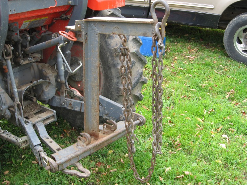

I've been using this setup for about 5 years now. Depending on the size of the log I can haul up to 3 of then at a time. It's not a wench so I have to back up to the log to get it lifted to drag, but it works just fine.
I use low range second or third gear to get the log out to a logging road then switch to high range second gear to take them to the landing.
Been using it to clean out beech.

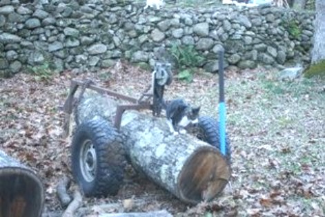

A log arch does keep the logs cleaner, I made mine 30 years ago for about $60.00.
The other option you have is to buck the trees in the wwods and then carry them out in a trailer.
Here is a picture of the trailer I made and the arch.

If your logs are not too big (no more than 24" dia. and 16' long), and the ground is fairly level, an ATV with a logging arch works fairly well.
I logged and milled enough lumber for my retirement house using just that setup.
Here is a link to some pics of my setup.
But you will have to join to see the pics.
