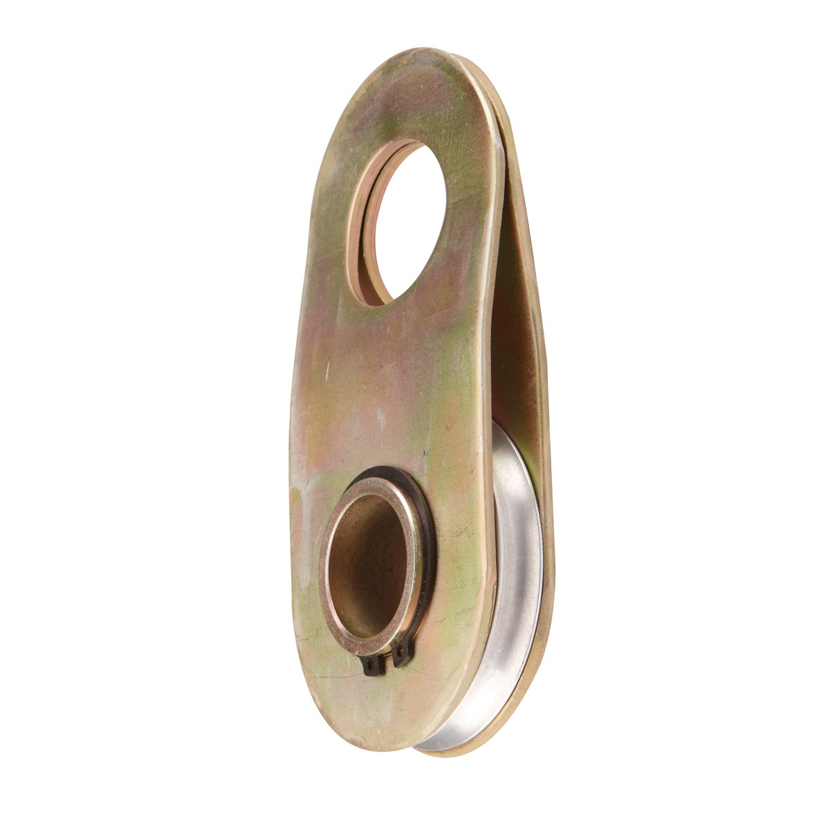

Any tractor loggers here know who makes a decent snatch block / pulley that can handle logs. .
I know I've seen recommendations here, but most pulley and block searches are about engine parts.
Will ones like this at Tractor Supply Champion Power Equipment™ Single Pulley Snatch Block, 8,000 lb. Capacity - Tractor Supply Co. really hold to their rated 8000lb? At $30 bucks should I just grab one, and hold/out shop around for a self-releasing one? What do they $run? Any good brands? (web) Stores?
Thank you.

Check out the Wes Spur website: 5/8” Pulleys
I got the first one on the list several years ago and it's been good. Might also want to check Bailey's and Labonville websites.

Coyote, that one would not be ideal for logging due to weight and design -- you want a simpler flat rotating plate design if possible, to be robust under dirty/muddy conditions. Plus I'd go with thicker rope capacity. For logging, I recommend either 5/8" or 3/4" ropes.

Of course -- all split plate blocks do. The two halves rotate about the same bearing as the pulley wheel.
Sorry, I disagree. My Igland model 4001 winch (www.igland-as.com) {hit British flag in upper right corner of page for English, unless you speak Norweigan:eek:} came with 150' of 3/8" steel cable, and I have used the exact snatch block I posted to pull twice the winches capacity on many occasions. 4,000# x 2 = 8,000# with block in place. Optional larger diameter steel rope cables can be ordered, but are not necessary. The snatch block is designed to be attached to a tree above ground level, out of the mud, etc. and works perfectly. I've cleared huge logs with my winch, and on one occasion even snapped the swaged end when pulling too hard and fast against an immovable stump, without the block in use. (Operator error, no fault of winch). YMMV.
/ Tractor loggers: Who knows snatch? #12
I'm not questioning the capacity or function of that block, just that it is more complex/bulky/heavy than normally used for logging and tree work. Ultimately, it will work just fine, but you can certainly find more compact, more robust blocks for logging. This is the type most commonly used for tree work:
No pins or parts to lose or get gunked up. Side plates pivot about the common pin/axle.

I've used a Jet brand, 2 ton, for years. Nice thing about it is it opens so you can put the winch cable in/out easy. I don't think I'd want a snatch block that didn't open.
That one Coyote showed looks good and tough...and again, you can open it to put the cable in. Most snatch blocks that don't open are only designed to pull a cable with NO end on it.....if you have a hook or something on the end of your cable, it won't fit thru the block.

In case it's not obvious, the block I posted from Wes Spur opens fully. The side plates pivot apart about the axle shaft to expose the pulley. It doesn't take more than a couple seconds to unhook the eye and pivot the plates. After using this type of block, I'd never go back to the old cast style with all the extra parts.
I get that people like to recommend what they have, but I have used all types of blocks over the years, and it became very obvious to me which ones were better for tree work. I've used the plate style blocks for pulling, for setting up fairleads, and for setting up yarder lines. Even used one to setup a zip line to manually move log sections across a creek, where the block rode along a tensioned logging line and another block/tackle hung below to raise the logs. It's that kind of versatility that makes the plate style blocks better in my opinion.
