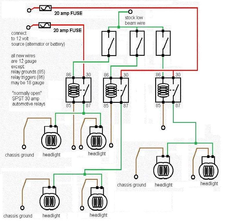

Here's the way I wired mine in using relays and the existing light switch, I liked that the ignition switch turns off the factory headlights and also shuts off the new Aux lights. This way if somebody forgets to shut them off or accidently bumps a switch I don't end up with a dead battery.

Wow DonT...that's a great idea!
...and simple too with my modest two lamp single switch set up!
