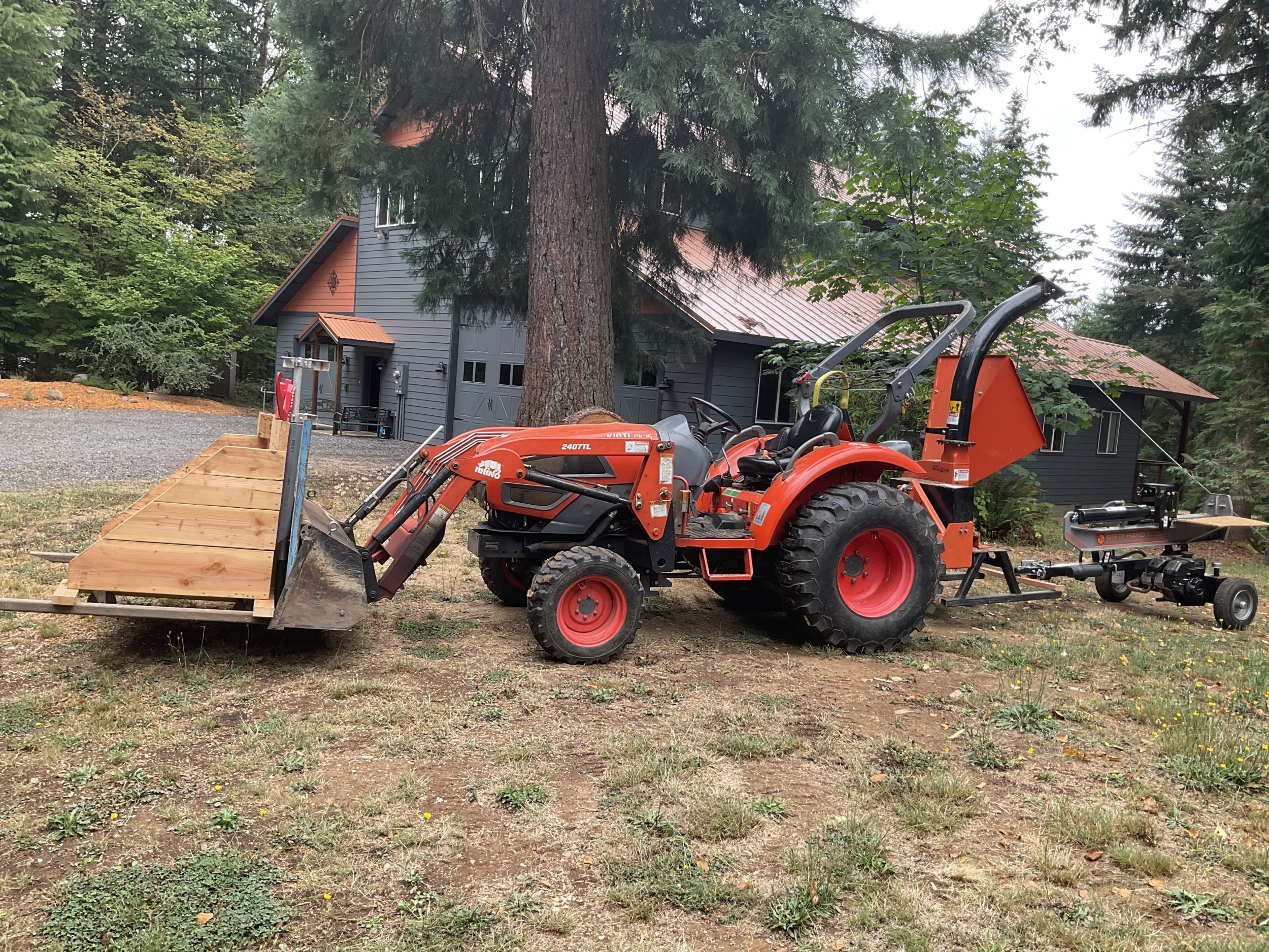

Hi all,
I was wondering what is the norm for letting my Kioti 3 cylinder diesel idle between using and then doing some hand work, say for 5 to 10 minutes. Would you shut it down or let it idle? Thanks as always for the expert advice!👍🏻 IMG_3691.jpeg
