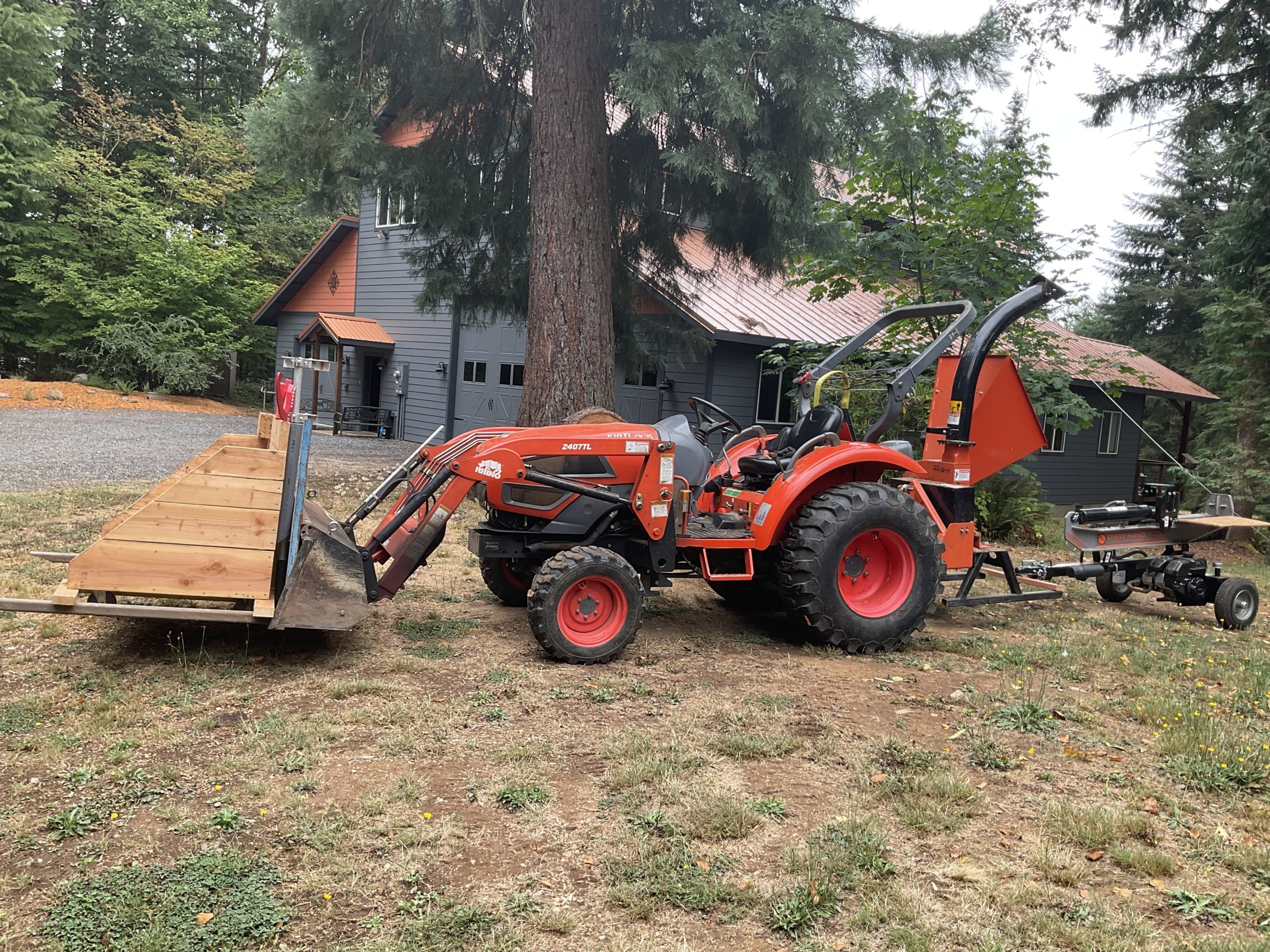

Hi all,
I was wondering what is the norm for letting my Kioti 3 cylinder diesel idle between using and then doing some hand work, say for 5 to 10 minutes. Would you shut it down or let it idle? Thanks as always for the expert advice!👍🏻View attachment 807535
In my early working life (70's), I had a couple of jobs with fussy owner operators driving ten wheelers, Two of the rules were Never shut down an engine that had been working hard (just pulled a long hill) without idling a while to let it cool and never let the truck idle while you went for coffee etc without setting it up to high idle which involved putting a stick behind behind the brake treadle and twisting it to press on the throttle. The first is still true but the second may not apply any more.
I have a 3 cyl New Holland with no emissions tricks, and set that up to a modest high idle while off the machine for a bit. A lot of each to their own.
