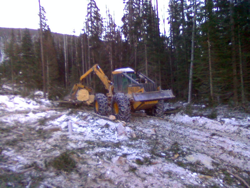

Best "tractor" for cordwood, John Deere 648-GIII, 150HP, 24.5-32 16ply tires, 100in easco swing boom grapple, 7 foot blade, heat and a/c. Oh,I am a 3rd generation farmer/logger. This IS the tractor for cordwood. "Thats a four foot across bug kill spruce tree in the grapple".
