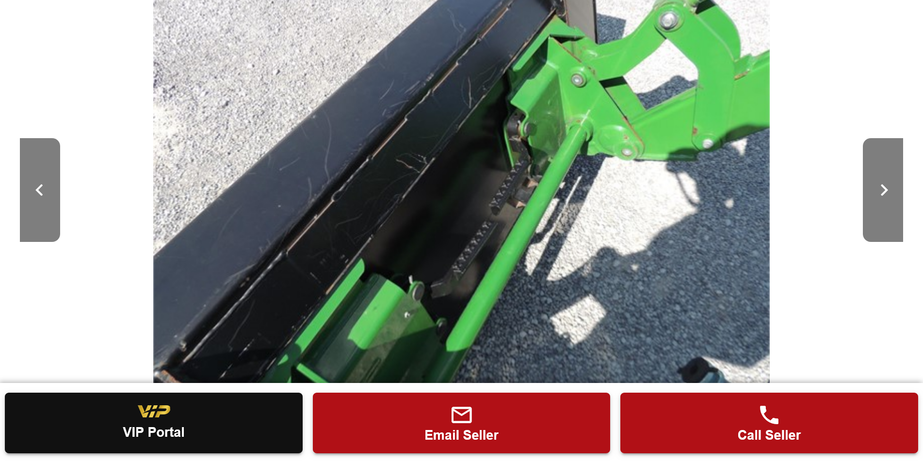

Nope. To get SSQA, you have the JDQA, plus another add-on. Not the same as others who use SSQA. You can get adapters to go SSQA to JD, too.
Soooo, this SSQA is connected to the proprietary JD quick hitch? :unsure:
I can't make it out.:rolleyes: The picture is of a JD 5075e.
Maybe on the smaller tractors?

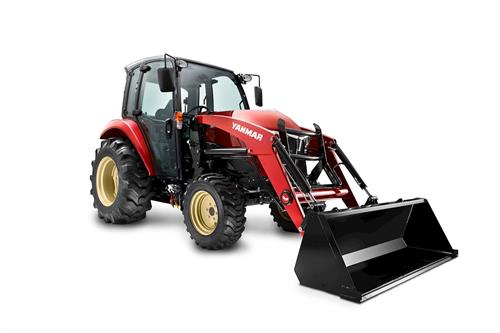

Just for your peace of mind I would sujest that you try out
a Yanmar Yt359C
  • 58.9 horsepower
  • 2,500 lbs front lift capacity
  • Cab with heat & air
  • the transmission is like two tranys in one
  • 10 year warranty
  • now have rebates
willy
   / Tractor choice? Share your wisdom! #37
a Yanmar Yt359C
  • 58.9 horsepower
  • 10 year warranty
  • now have rebates
willy
Willy, the OP said that he had only JD and Kubota dealers in his area.
