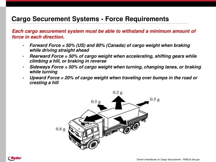

Whatever it takes to get at least the required minimums in each direction. I thought here was one of these diagrams for wheeled loads that had 1g forward but I can’t find it.
Things not fixed to the frame like the FEL, a brush hog, etc must be strapped down as well.

Chocking is not an acceptable primary method of restraint per the Federal Motor Carrier Safety Administration, the rule making body for commercial on road transportation.
Come on guys... the questions was How to chock - The biggest tires x2, diagonals 2x, all four corners 1x?
Straps or chains are considered the main method of securing a load. @sea2summit posted excellent information on load securing. You can chock, but the chocks must be secured to the trailer or they would fly off potentially leading to an unsecured load fine, and liability for any damage they might cause. The only chocking I normally see is where large coils will have wood chocks on each end and the wood is nailed to the trailer or secured with its own strap. I am not sure if your going to get much information on chocking as it is an unorthodox method of secondary securement that for most situations has more potential for issues than it solves.
If memory serves me right DOT (department of transportation) always liked to see individual chains/binders on each corner, one over the bucket, one over the backhoe and each implement having one or more as well. I prefer chains with ratcheting binders, however that is just a preference as there are pros and cons to each method.
