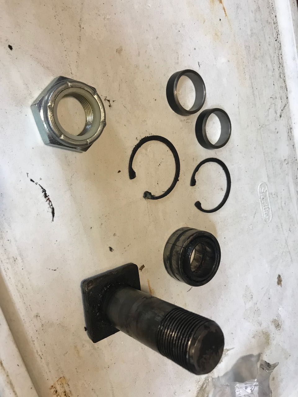

I'm no engineer, but it seemed to me that your old one broke right at the end of the weld. That could be caused by a lack of strength, brittleness from welding, or random. I'm betting it is one of the first two. Adding metal, and then a little post welding heat treatment should help.
Given where it broke last time, I would be tempted to get some E10018 welding rod and build up the perimeter starting at the triangular base, crossing the existing weld and going at least half way around the perimeter of the inset/attached tube. I would work up a couple of passes until you have added another 1/4" of material along the outside of the piece and over the existing welds, which will be (I'm guessing) probably be 3-4 passes. I would also try to add more material at the join to build up the web. (If you think of the perimeter of the part as a keyhole, I would be trying to make the keyhole into more of a triangle by adding material at the sides of the circle/triangle intersection.)
All the best,
Peter
What do you supposed the tolerance is on the bore diameter? Would doing that much welding on it cause a problem?
Kevin
/ Tractor broke in half again #43
Kevin

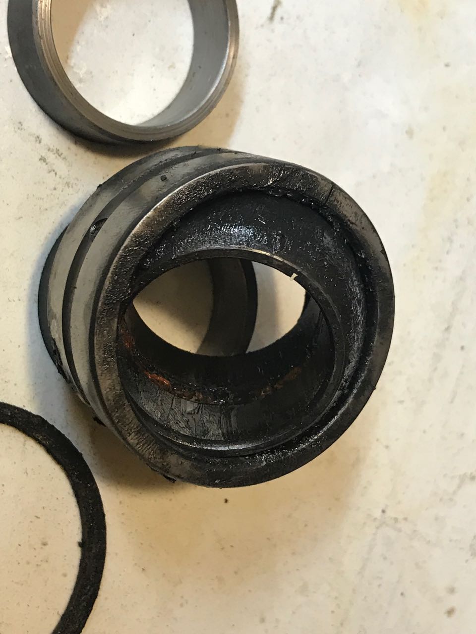

Welding on the tube is going to distort it and shrink it. The ball is called a "spherical plain bearing". It's a ball in an outer housing. It needs to be installed with not much more than a metal to metal fit or it will lock up and not swivel. Those bearings are available in all kinds of sizes, both inch and metric. Any bearing store can get them. If your going to use the new weldment, take a flapper wheel on right angle grinder and blend grind the weld where it ends on the tube. That will minimize the stress riser at that point. If there is room, a new weldment with the plate surrounding the tube would be a major improvement.
I've had a lot of experience with that type of bearing set up repairing heavy equipment. It's used a lot.
