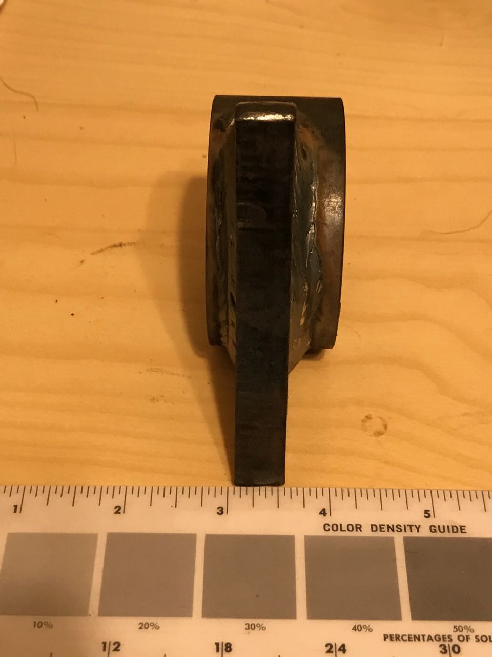

So I am waiting for the parts to show, but thought I would share this with you. This is the pin and its assorted parts.
Basically you have the pin (1-1/4" for you engineers)
Jesus Nut
2 Spacers, one on top and one on the bottom
The ball (which if I remember correctly goes into the piece that is broken) and two circlips to hold the ball in.
Engineering thoughts?

So what exactly broke?
The eye appears to be similar to a 3pt hitch lower link ball end. Anyone else notice that?
Category 1 lower link ball ends are 7/8" diameter.
Category 2 lower link ball ends are 1-1/8" diameter.
Category 3 lower link ball ends are 1-7/16" diameter.
Category 4 lower link ball ends are 2" diameter.
Anyhow, I'd take the broken part to Tractor supply, or some other agri-supply type place and compare it to the 3pt lower arm ball joints and see if they are compatible.
Do not forget that there are top link replacement ends,,, that would increase the number of sizes,,
CAT 2 is 1",,, much easier to work with than 7/8"

What is the diameter of the ball? What is the height of the circle that the ball sits in?
I think Mossroad has the right idea; this is probably a CAT3 or 4 link ball.
I personally would mill a replacement bracket for that ball that is as thick as there is room to fit it. Since this has broken twice, obviously under-designed. But than I have a couple of mills in my garage that make that kind of experimentation easy and cheap. :D
Amazing that the bracket holding it broke before the circlip gave way.

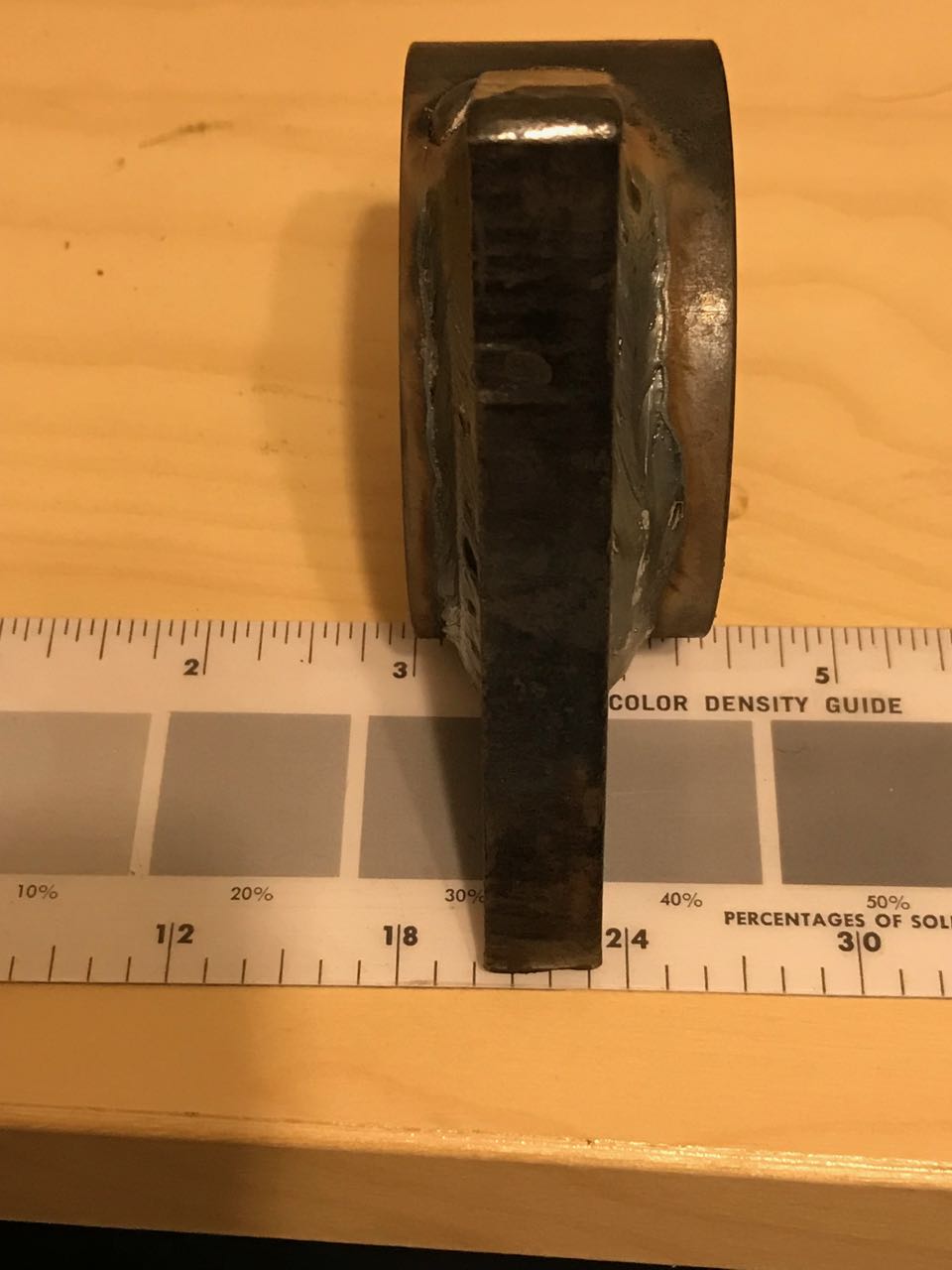

So the new center section arrived today. Over the weekend I am going to devise a few plans to beef this piece up, and Monday will go to the steel shop and see what they have.
Taking all ideas here, if anyone has one.

Carl-
I'm no engineer, but it seemed to me that your old one broke right at the end of the weld. That could be caused by a lack of strength, brittleness from welding, or random. I'm betting it is one of the first two. Adding metal, and then a little post welding heat treatment should help.
Given where it broke last time, I would be tempted to get some E10018 welding rod and build up the perimeter starting at the triangular base, crossing the existing weld and going at least half way around the perimeter of the inset/attached tube. I would work up a couple of passes until you have added another 1/4" of material along the outside of the piece and over the existing welds, which will be (I'm guessing) probably be 3-4 passes. I would also try to add more material at the join to build up the web. (If you think of the perimeter of the part as a keyhole, I would be trying to make the keyhole into more of a triangle by adding material at the sides of the circle/triangle intersection.)
