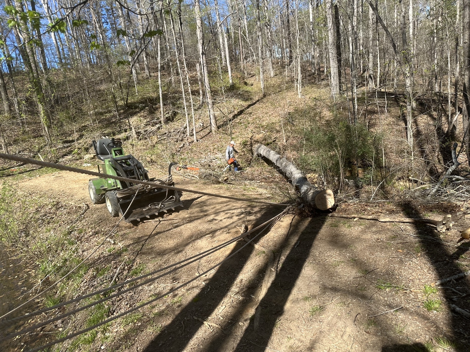

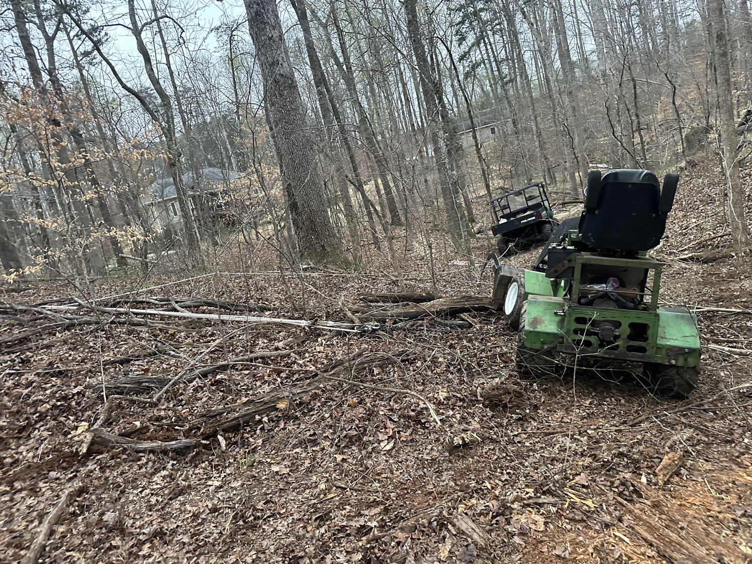

My machine originally was a 2422. Terry told me that if you put the 25 hp in it it becomes a 2425 that’s the only difference between the two, at least I was told that by Terry. Mine is a 2001 year model and has had modifications the seats different the covers different and the batteries put to the outside instead of down in the box behind the engine. I know these have a pretty low center of gravity but when you’re on a slope and you’re turning and you hit a hole, they do tend to get off-balance quick. When I’m working on the slopes, I usually keep my bucket as close to the ground as I can that way in case it does try to tilt I can drop my bucket and keep it from turning over Also, when working on a slope, I put most of my weight in my bucket to the uphill side so it’s pulling my machine towards the uphill instead of the downhill acting as a counterbalance.

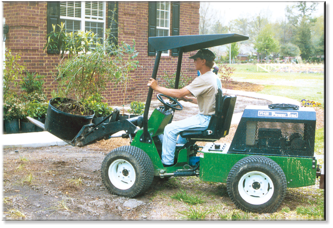

The 425 is shorter, and the driver's seat is attached to the front section of the machine. It has 2' less lift height than your machine. No way to put backhoe on it.

PT-425 Specifications​
•Weight: 1,387 lbs.•Width: 45”•Height: 71”•Length: 90” (from front tire to rear of machine)•Speed: 0-8 mph variable •PTO: 8GPM @ 2,500 PSI•Frame: 3/16” to 3/8” steel plate•Fuel Tank: 5 gallon capacity•Hydraulic Oil Tank: 10 gallon 10W40•Lift Capacity: 800 lbs•Lift Height: 5’•Outside Turning Radius: 95”•Inside Turning Radius: 37”•Wheel Base: 56”•ROPS: standard
2425 Tractor Specifications​
•Weight w/o backhoe: 1,725 lbs.•Weight w/ backhoe: 2,130 lbs.•Speed: 0-8 mph•Tires: 23-10:50x12•Ground Clearance: 8”•Frame: 3/16” to 1/2” Steel Plate•Height: 83”•Width: 45”•Length: 83”•PTO: 8GPM @ 2,500 PSI•Fuel Tank: 5 gallon•Hydraulic Oil Tank: 5 Gallon 10W40•Lift Capacity: 800 lbs.•Lift Height: 7’•Inside Turning Radius: 45”•Outside Turning Radius: 94”•Wheel Base: 56”•ROPS: Standard
2425 Backhoe Specifications​
•Reach: 8’4”•Breakout Force (bucket curl): 2,500 lbs.•Digging Depth: 6’•Bucket Widths: 9”, 12”•Swing: 60° both directions•Outrigger: vertical slide
The 24 series machines do not have a low center of gravity, only the 14 series.
Look at pics of the 425, 1430 through 1460 and you may notice the engine is low and between the wheels. On the 2425 the engine is above the wheels with the operator sitting on top of that, and the loader arms are higher and longer (increases the lift height spec).
Life is short, since you rolled your machine more then once, if it were me I would sell it and take the money and buy the low profile version, you will be amazed on the stability. Or dual wheels will help, but machine will be wider.

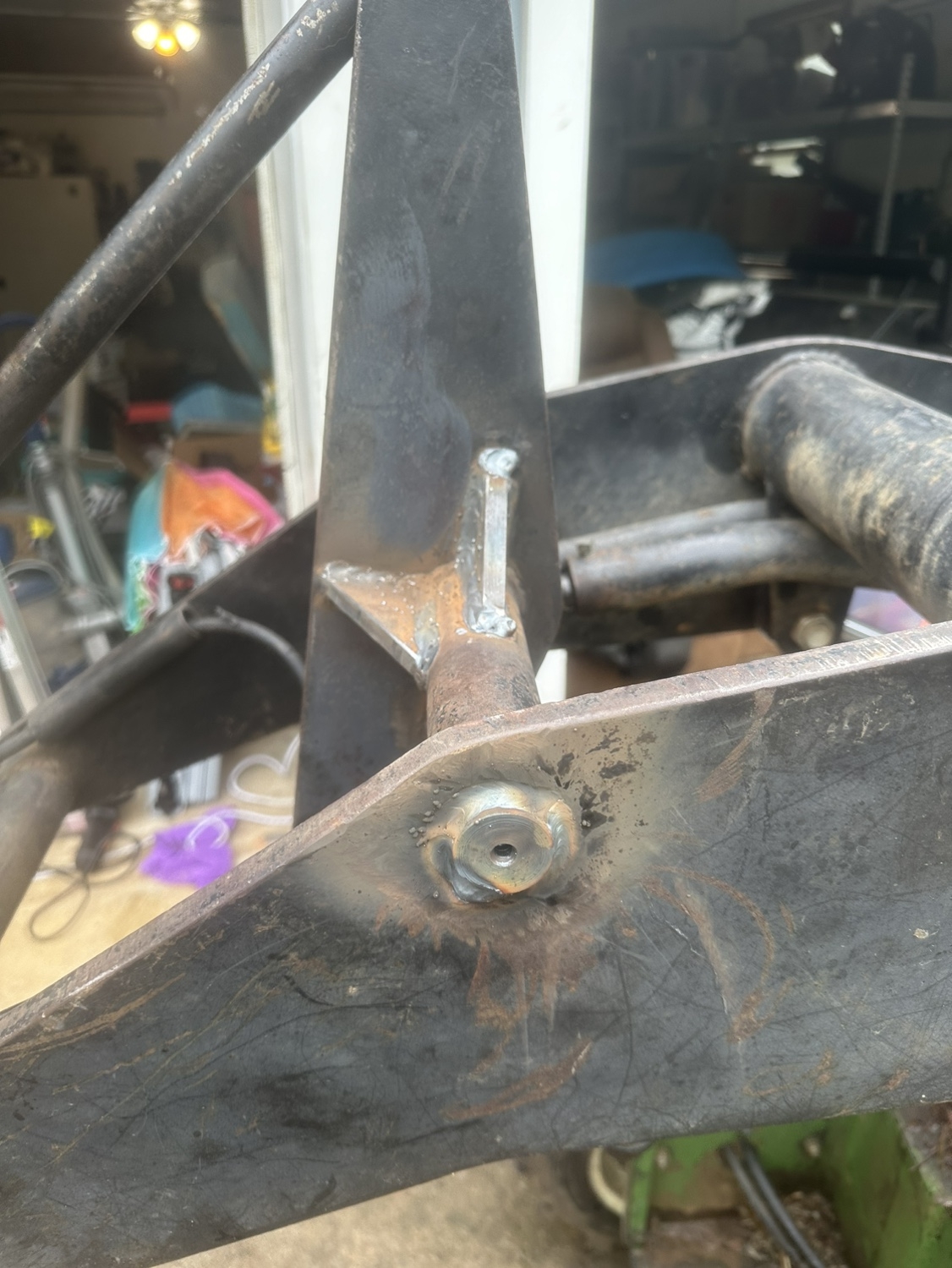

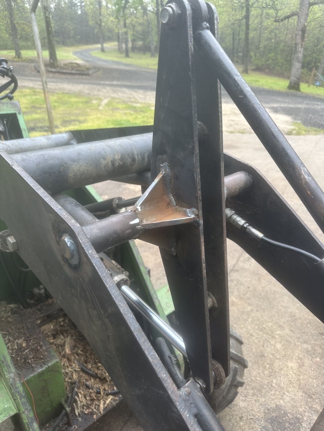

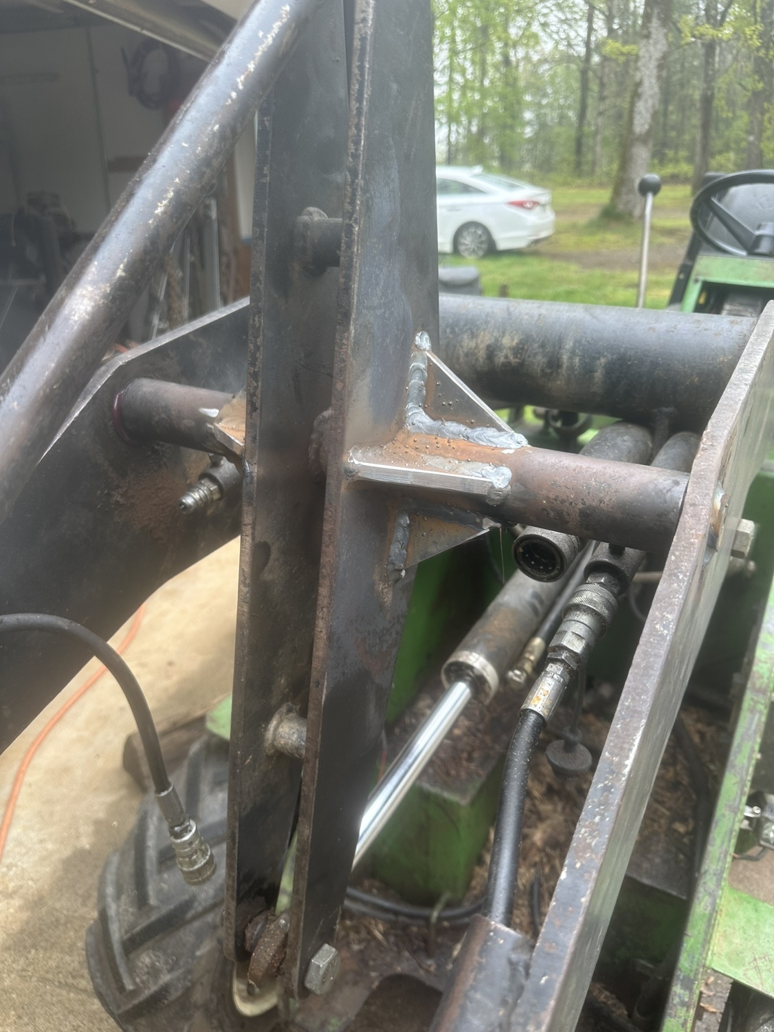

the machinist, measured the inside diameter of the pipe and then turned down the pin to the size of the pipe inside diameter, then welded up the pipe with the pin installed see pics for refrenceView attachment 861764View attachment 861765View attachment 861766
The whole job cost 180 dollars. Not bad.
Am I the only one who thinks that this bracing looks really good but doesn't do much good? There should be metal between the two flat pieces at each brace to tie the two sides together. Otherwise it's just going to break in the same place again. That's my thoughts.

/ I broke it again. #38
In there... (y)
/ I broke it again. #40
Metal reinforcement at the center should help resist future breaks since there may be some metal fatigue after the previous break.
