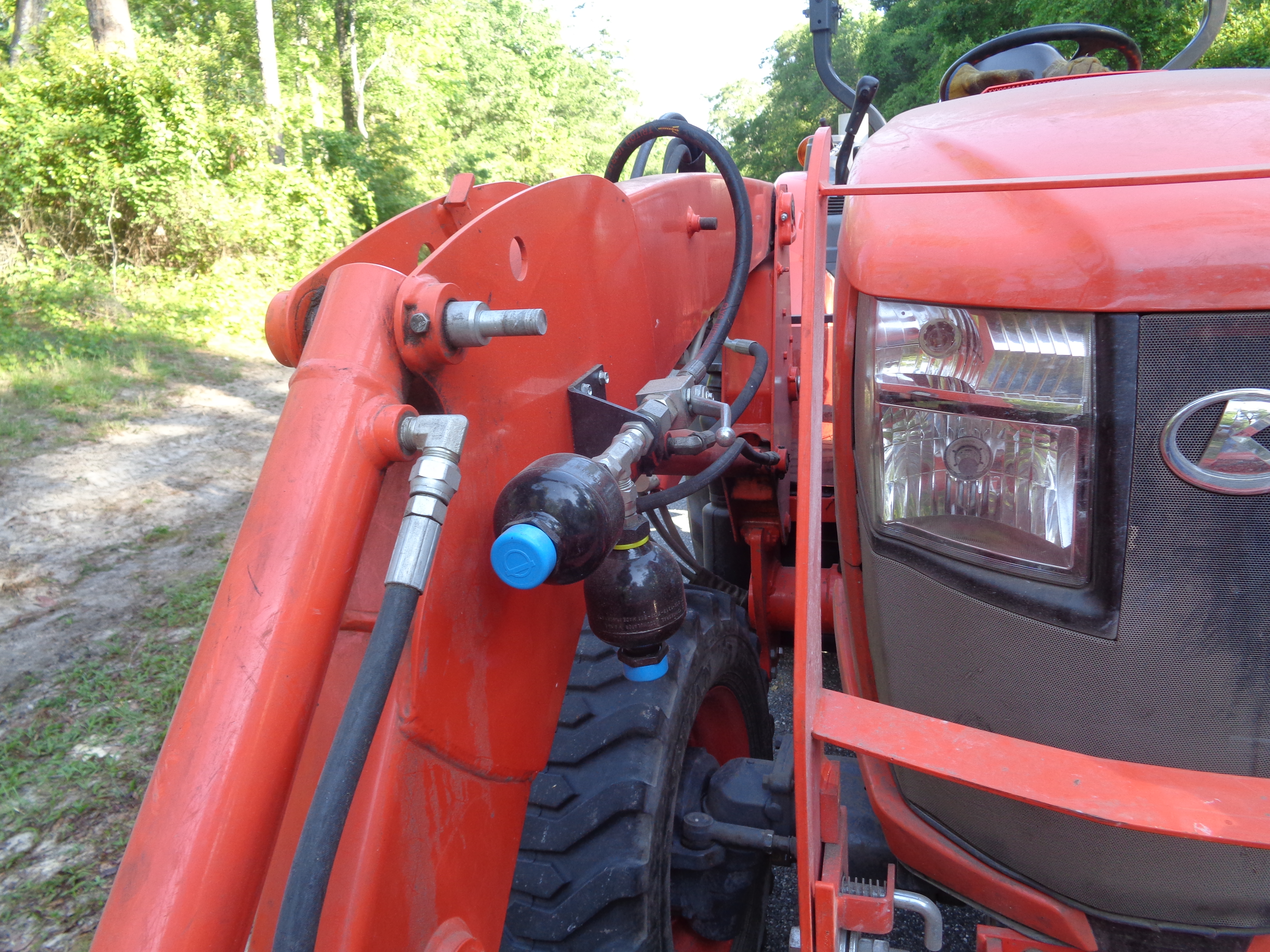

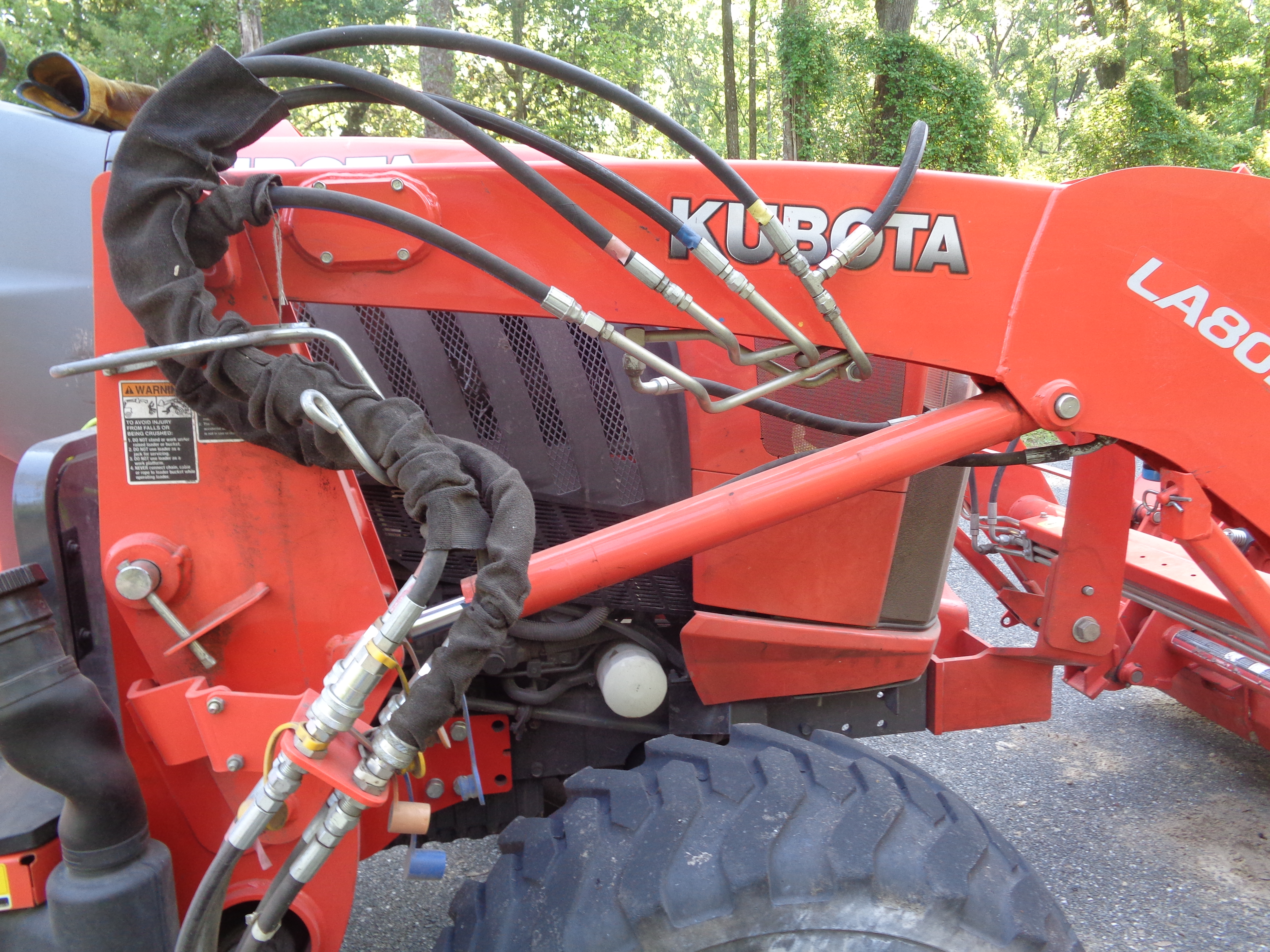

Just wondered what everyone thinks of this new product by W. R. Long. The name is a bit deceptive as it's not something intended to directly improve the "ride" of your tractor, but it dampens the movements of the FEL as you traverse over (uneven) ground. The end result I suppose is that it could reduce the jerky movements of the tractor as you drive it over rough terrain, and help it ride a bit smoother. Their main selling point though seems to be that it reduces the wear and tear on the loader's mechanical joints, and maybe reduces the metal fatigue as well.
I think the theory behind it is good, but it would be nice if they could show a side by side comparison of two identical tractors, one with the system and one without the system, driving over the same terrain. I'm not thinking of buying one, mind you, but the hydraulic dampening technique just peaks my interest a bit. The suggested retail price of the CR10 is $425 and the suggested retail price of the CR20 is $475, if you're interested. :thumbsup:
W.R. Long, Inc. | Tarboro, NC
Kubota dealer installed the Long CR10 on my L3560 with LA805 FEL. Works as advertised. With moderate loads of brush on Debris Forks damping actions eliminate material falling off during transit. Productivity is enhanced.
One hydraulic line had to cross the right loader arm in my ((early)) installation.
With CR10 working, bucket does not pound, burdened or unburdened.
Oak section guesstimate 1,200 to 1,400 pounds. FEL (LA805) lift capacity 1,700+ pounds. I cut large diameter Oak loads to fit in the bucket, near to the tractor, rather than on the forks, where leverage works against stability. Three Point Hitch counterbalance 900 pounds. Much less transient load stress on the tractor with Long's "Comfort Ride" cushion-accumulator installed.
Kubota factory "Shockless Ride" option is available on the Kubota M5660 with LA1154 loader.
Kubota should offer Shockless Ride option on the Grand L series. The proverbial cherry atop whipped cream.
