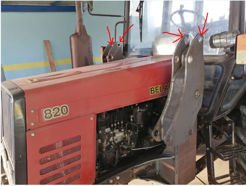

So...the project is not stuck, it just got a new part...I sold my old front loader so now I'm making a new one, my way. In the meantime, rk project is on hold...
So i started with the console:

Welding the boom
/ Tractor backhoe - homemade
#1,249
Thanks :).
Welding some reinforcement plates..
And it fits...gotta wash those windows...sorry, ther's always some dust flying around in the workshop :)

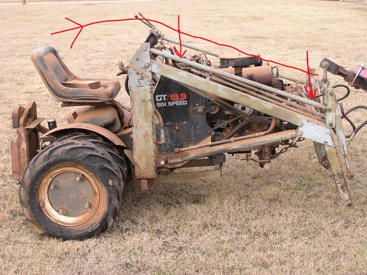

Also depends on what type of hydraulic self leveling is used.
If it's a self leveling valve or a pair of cylinders parallel to the lift cylinders and connected with the curl cylinder as shown in the attached picture.
The first one, I don't know as I've never seen it working in person but I'm aware it can "lose" position. The second style, works pretty good and in my opinion can be slightly superior to the mechanical linkage because it doesn't create that flimsy effect on the bucket due to the leverage on the curl linkage.
Notice the small cylinders above the lift cylinders for the self leveling.
