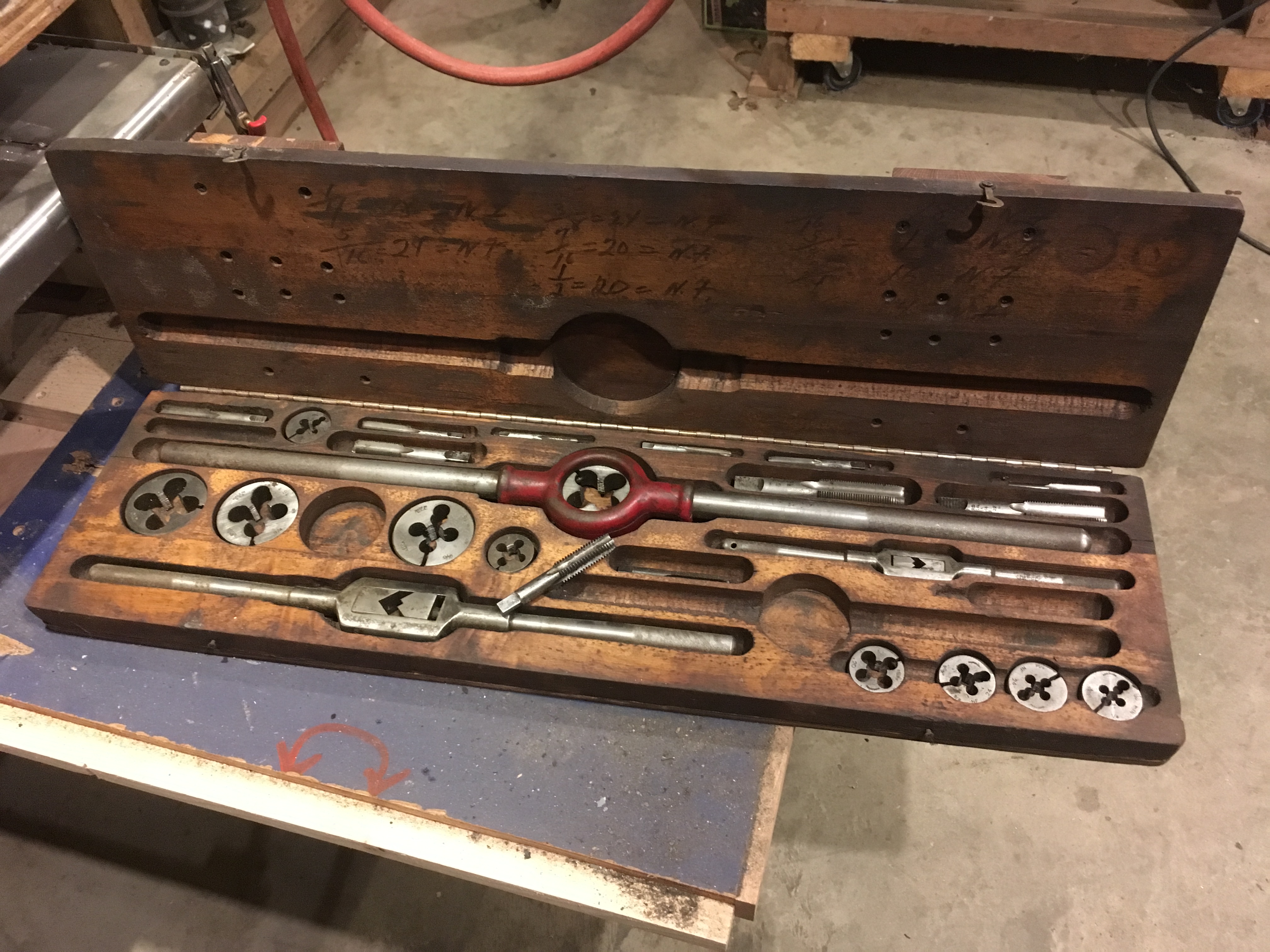

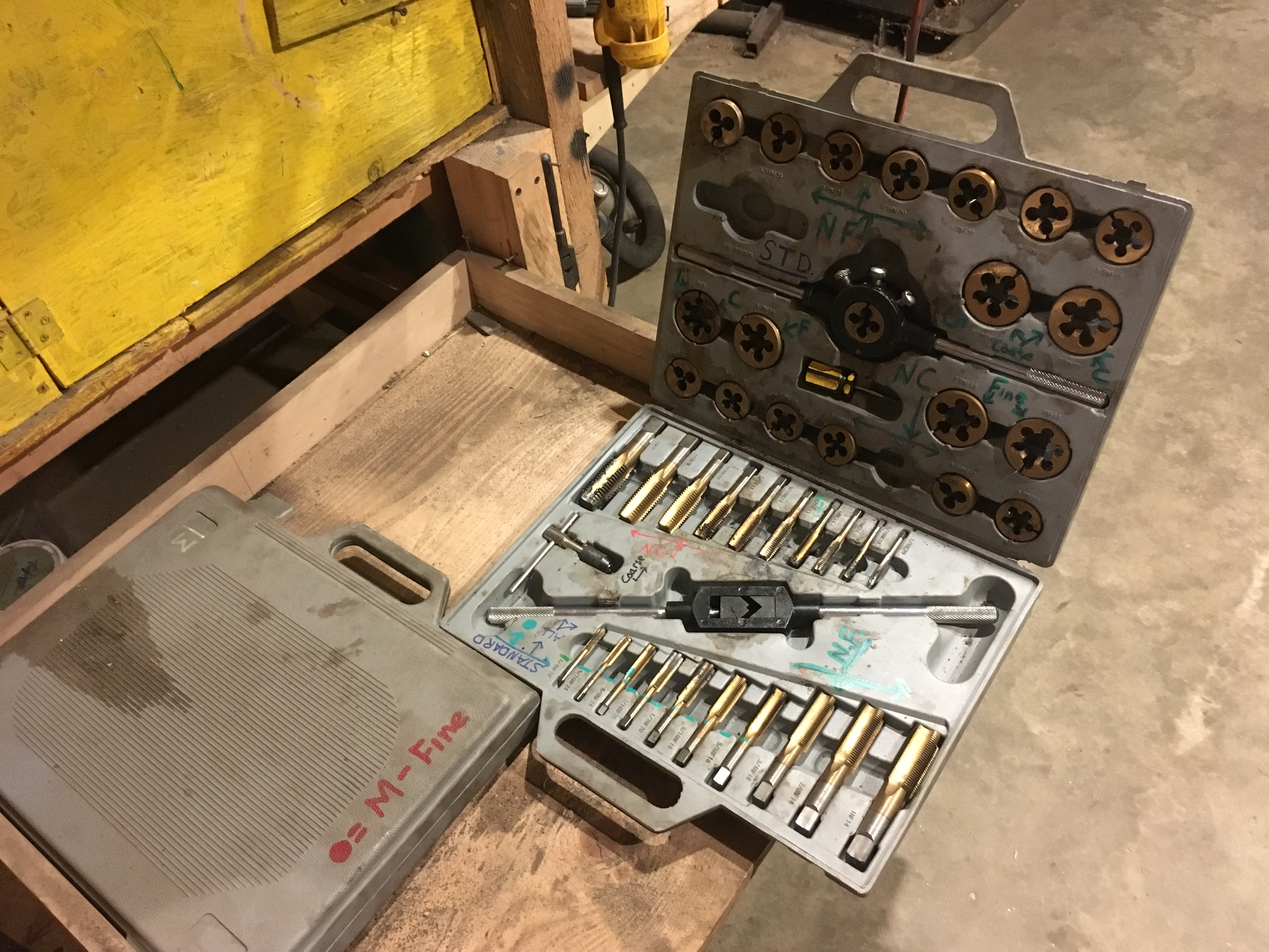

These are the tap&die's I'm familiar with, 1st is a used replacement set of what my father had 60+ years ago, they was ruined in a shop fire so my son found this old set online of like what I lost. The second set is HF one grade above junk, I get by with them, both sets are the stile I'm used to working with and they go from 1/4"-1" then one set is in metric, and both sets are one pass and done, but the HF sets takes more effort.

Oldpath, when you tap large threads by hand, it takes a lot of horsepower, so they break it up into 3 taps to make it easier on your arms.
/ Tractor backhoe - homemade #1,225
When you get in the real big sizes, you need multiple taps so the thread quality is still good. (like 2,3,4")
