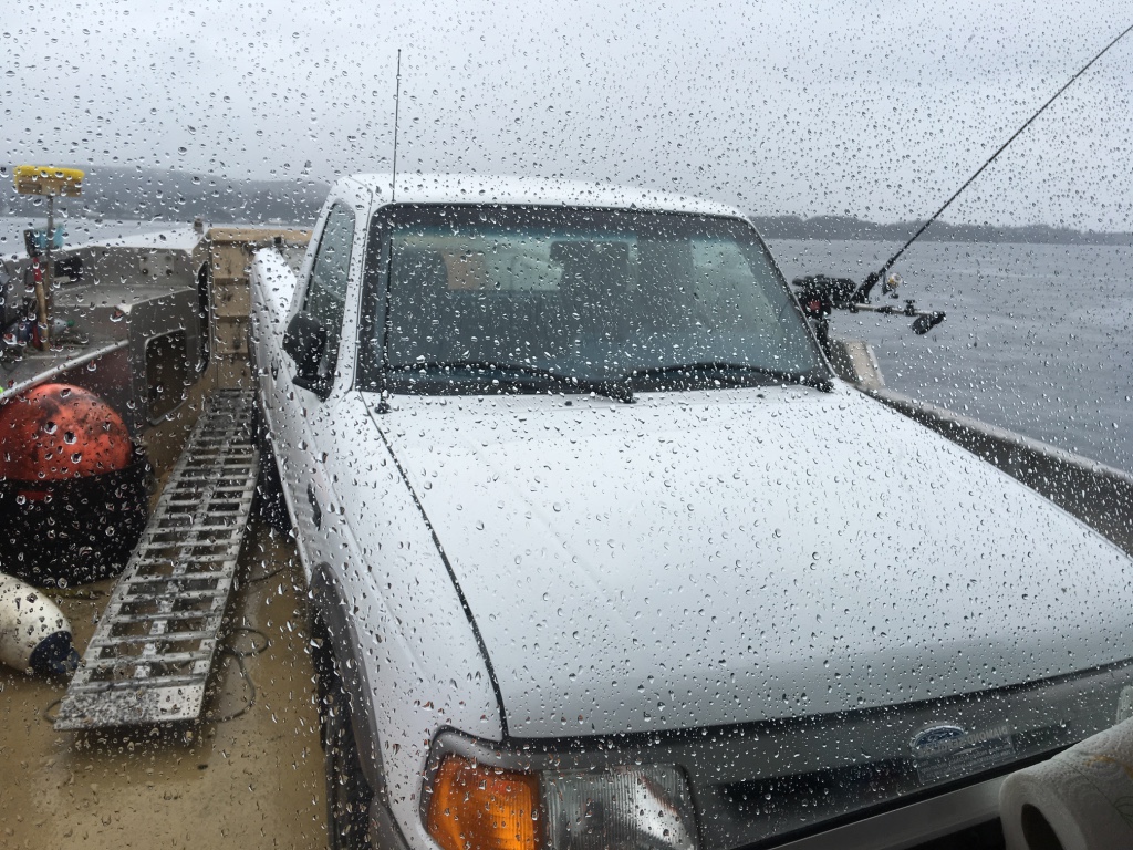

yeah I own two landing crafts and that is how I plan to transport the equipment. The problem with hiring is that this job is way to big for 1 summer's worth of work so multiple trips will need to be made, and the cost of transport just from town to the site on the landing craft that is large enough is $8,000, then another $8,000 to come pick it up which basically pays for a piece of equipment.

And this is also something I have considered. I could load tractor on the boat and take it over to cabin, then come back and have a forklift put the implements on and then use the tractor to get them off once back out at the cabin. Just have to figure out how to secure them on deck in a way that i would be able to get them back off with the tractor.
Pull implements on with a Come-Along wire winch. Lift off light implements with tractor's FEL. Or pull off using tractor's logging winch or a nylon tow strap.
Use ratchet straps or 1/2" nylon rope to secure implements on the boat. I know how potentially dangerous sea passages in a laded boat are.
