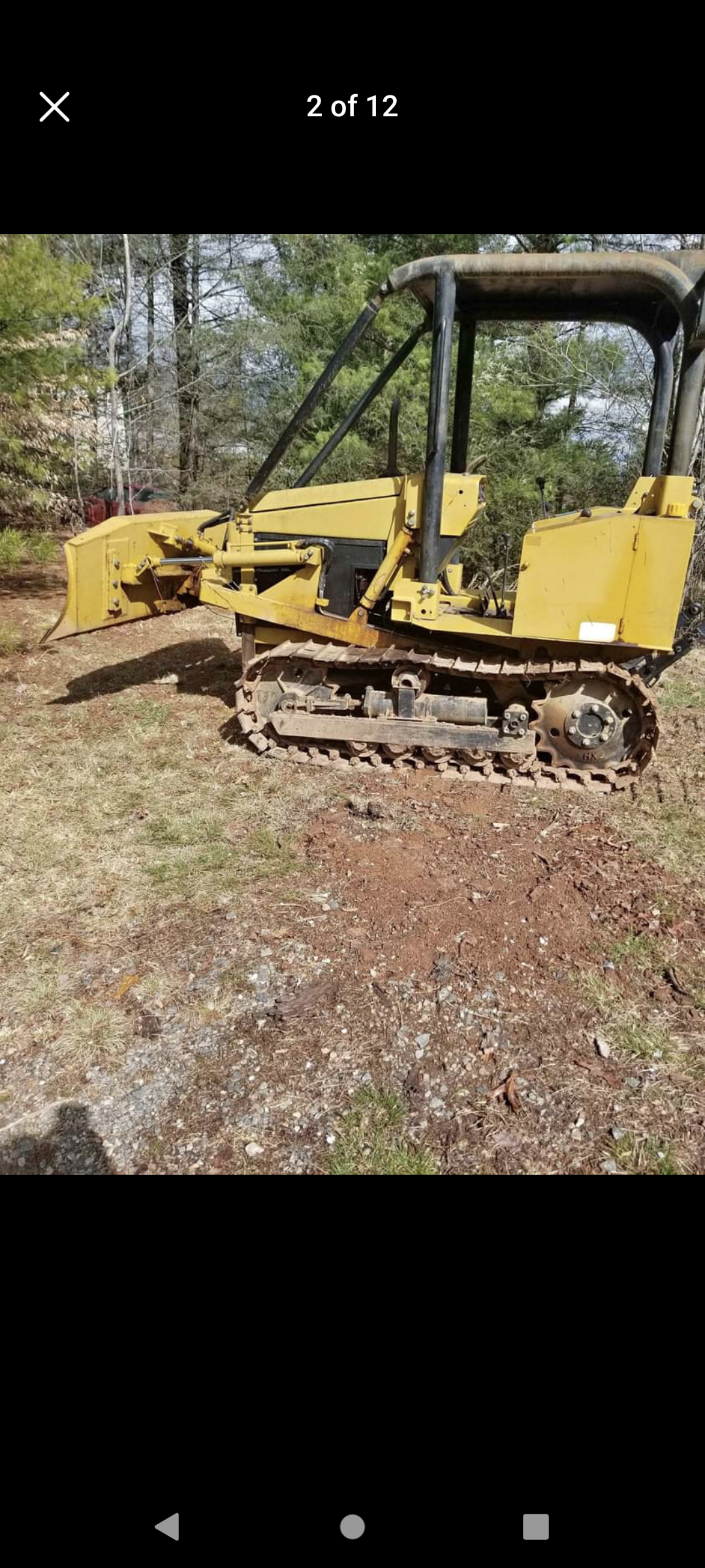

Track king dozer34020
Hi new to this site and would appreciate any information about the dozer listed in the thread title. I recently got one for free it's a 02 model and and runs good only has 73 hours on it but unfortunately the left track is not operating as it should drive wise or steering wise. I have read that a lot of these Chinese dozers are basically made in the same factories and just sold under different names. I can find next to no information about this dozer. Ant help would really be appreciated. Thank you

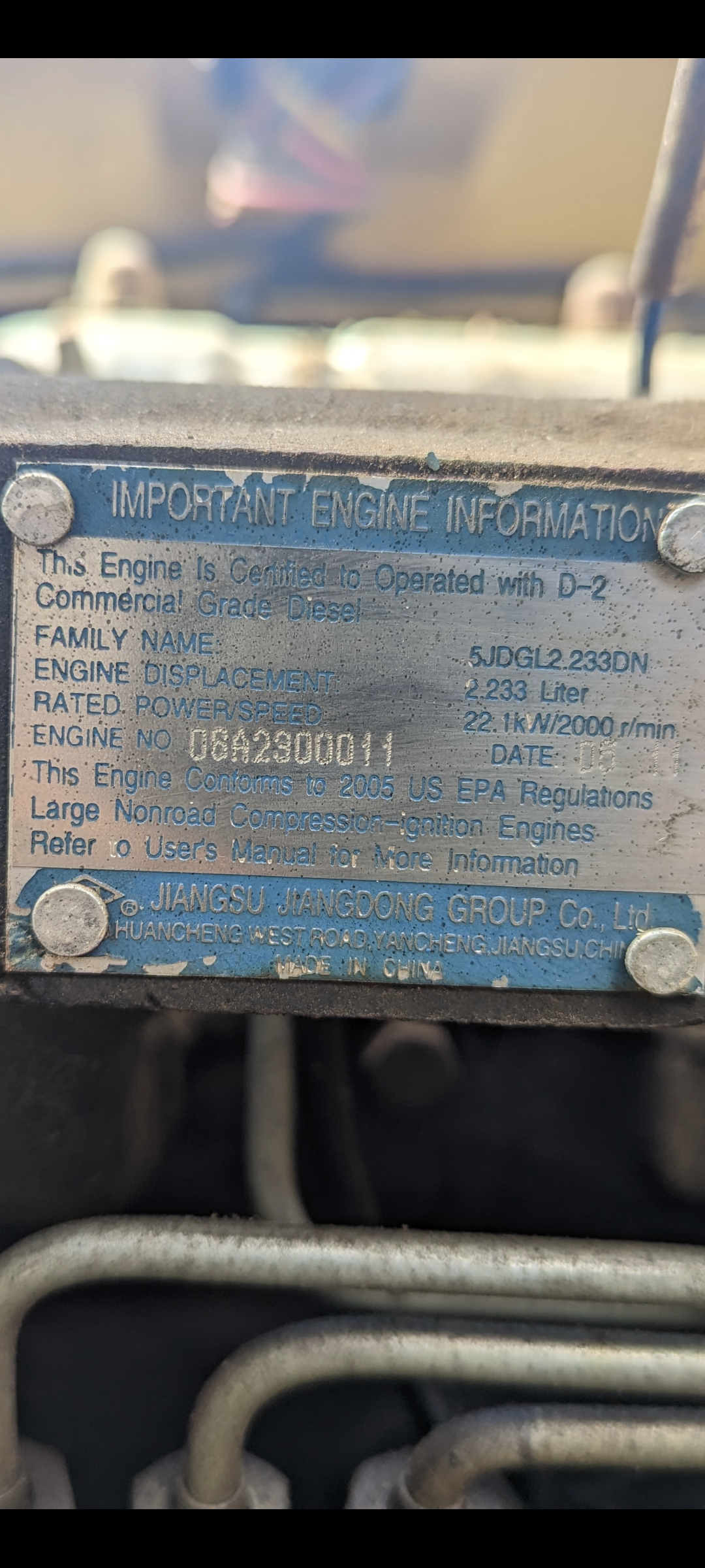

/ Track king dozer 34020 #4
If you will PM me your email address I will send you an operators manual (there is no shop manual available for these machines, but the operators manual includes parts). Do you know what engine you have (make and model number)? It should be on a nameplate on the left side of the engine. Better yet, take a good picture of it and post it here. Does your machine have the standard clutch pedal or the hydraulic shuttle clutch (no clutch pedal)?

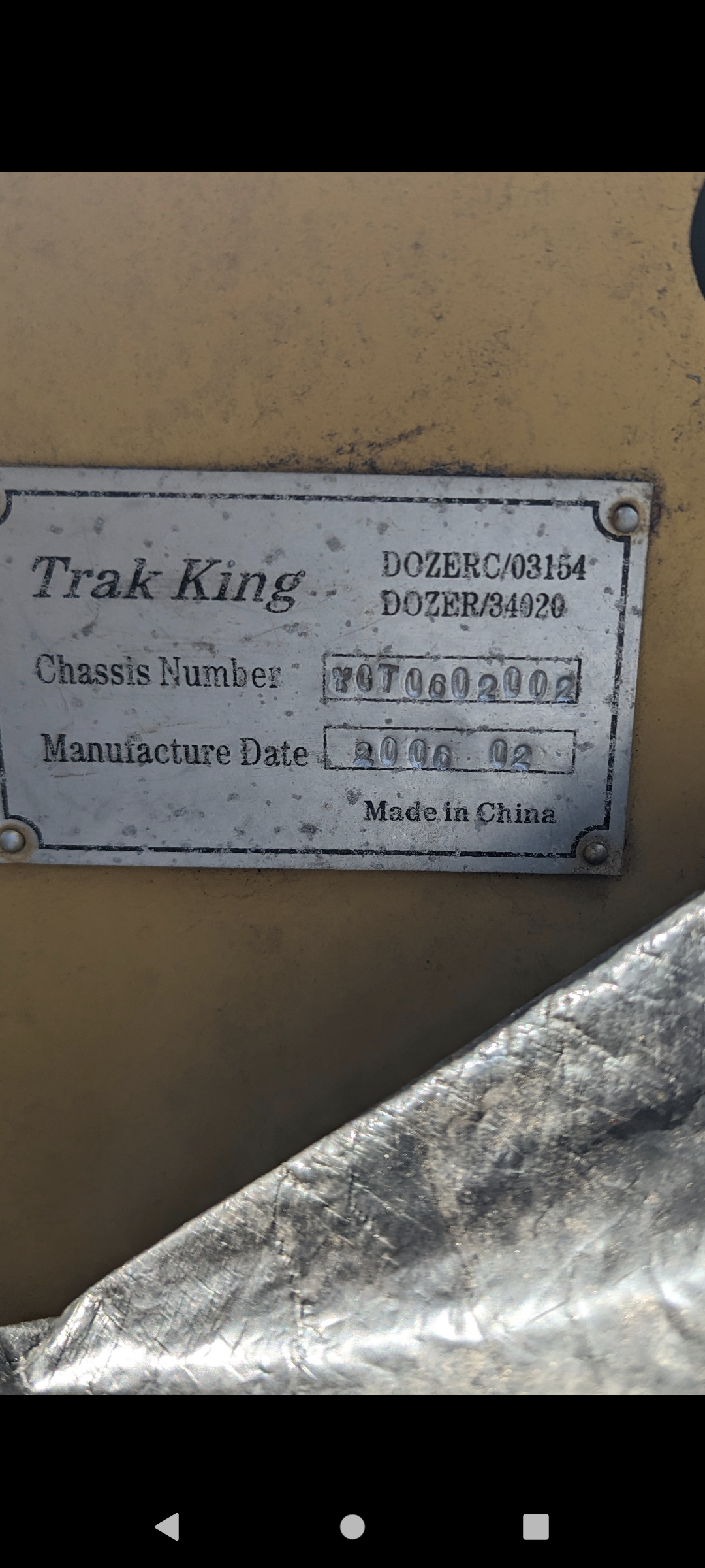

Mr Bob here is what I could find
Thank you sir. I really appreciate your help. With what I have been reading I'm assuming the steering clutches are dry clutches. Am I assuming right. Also are any part still available that you know of or am I going down a rabbit hole trying to repair this thing. Thanks again for your help.
