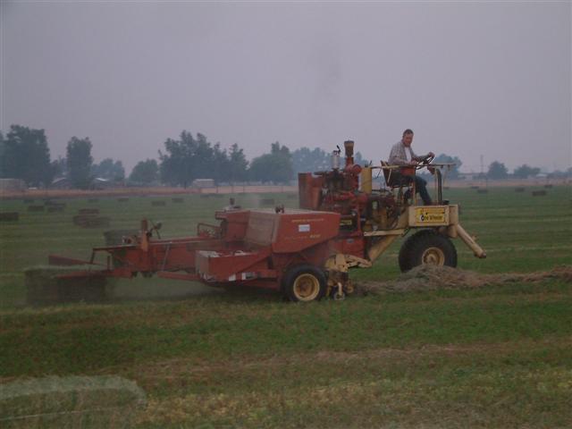

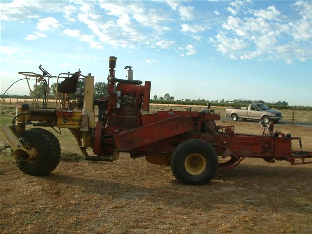

Or one like this
My neighbor bales his 30-acre alfalfa field with this baby (a 3-twine New Holland baler, diesel-powered, hydraulic motor drive on the front wheel). He bought it in Fresno and towed it with his Ford van about 300 miles North to his place. His biggest problem was driving over the Sacramento River bridge on I5. Pretty hairy.
