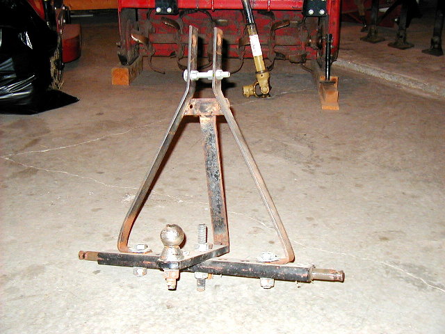

DDT, that's a good looking hitch receiver. How much does it weigh? Of course, if you're using a quick hitch I guess that doesn't matter a lot. This is a real light weight 3-point hitch I made about 5 years ago for my B7100. I wanted something light enough I could pick it up with one hand to put on the tractor quickly, and I didn't want to spend any money; just made it from stuff I already had laying around. Instead of a receiver, it's a convert-a-ball so I can quickly change to any of 3 ball sizes.

I always paint them black, so it don't stand out from the rest of the tractor. and don't want to get rid of my receivers, just the hitch, any reciever will work in it.
bird, It weighs 33 LBS acording to the bath room scales ( with out the recievers)
I finished my new one last night, it is ready for paint (black), so I can use it with or with out my quick hitch. as you can tell I don't like spending alot of time in hook up mode.

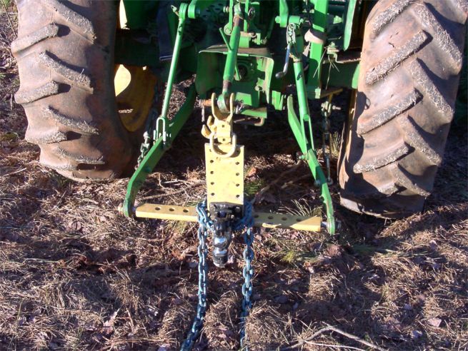

Here's a picture of a tow bar I built. I needed something that would work for a pintile hitch, and using a reciever mounted pintile hitch would get heavy. The vertical member that doesn't show in the picture is a 1"x2" steel rectangular bar. I didn't make the plate with the holes in it, I cut it off an old receiver mount that somebody else threw away. Finally I welded a D ring and a grab hook for light duty pulling. Heavy duty pulling gets done from the drawbar to keep the atachment point below the rear axle. To whit, note the Chalkey Chain.
The color, if not identifiable from the picture, is my second most favorite color - New Cat Yellow.
