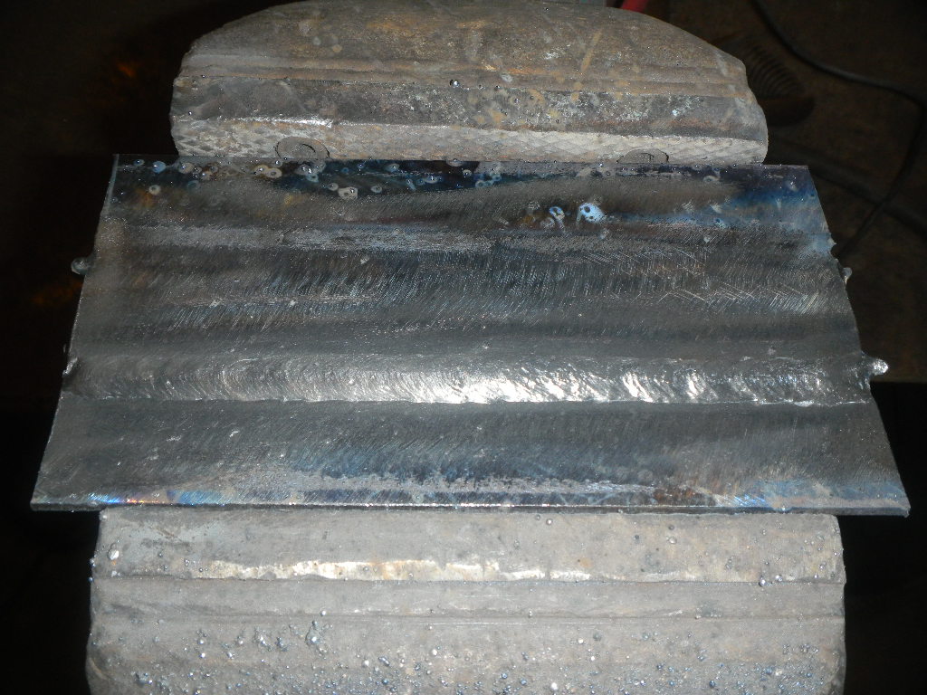

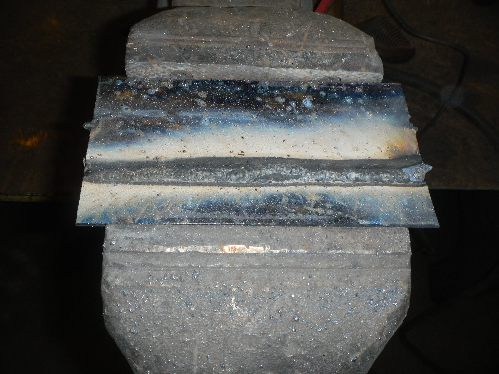

/ Total welding newie here #63
what difference does it make if it's cold lap or not? :confused:
Mig welds are notorious for cold lap. When using the Mig process you want to run as hot as you can handle it. No one knows how much penetration the weld has when cold lapped. It's just a roll of the dice when the weld will let go.

/ Total welding newie here #65
I do not "Hope" it's cold lap I know it is. Do you see how the toes of the bead are on top of the base metal? They never fused with the base metal that is why they lay on top.
/ Total welding newie here #66
I will add that you can help to keep that from happening you can preheat the part, use 100% co2 or the best cure is to use more amps.
/ Total welding newie here #67
It fused, I can see the puddle in the base metal when I'm welding it. I go ahead to preheat then back and dwell to keep the puddle hot thats why the weld piles up higher than necessary. These are things you learn to do when there's no knob to "11" (a situation that they would never teach in school). Agreed more amps is better but it can work.
Also that weld looks like it does because the two braces are not centered. And I dwelled there. The (right side) weld is going around the bend it's not the same as the left side weld. Agreed more power would have welded nicer but it this isn't a welding class, there's no grade, and it aint gonna bust.
I have preheated parts in the past with a roofing torch, that works too, of course, but its a lot of unnecessary steps for this item. True this is a heavy piece for a 120v welder. The beginning weld is the pre-heat, thats why it piled up high I was dwelling there, heating with wire:D. When I get to the other side it's now hot and a big fat fillet welds nicely. I suppose I could have started on the fillet and finished in front but thats 20/20 hindsight. This item was welded in-place (on the ATV) then rattle-canned and DONE!
If this was a production item, it would be welded properly on one side, with no fillet on the backside. A production welder has to do it per the drawing, pass inspection, or the part is SCRAP. I do understand you pro welders but you're applying unnecessary specifications from your world that are not required in mine. I can weld it on the backside, do more passes, whatever I want.
The only way it's going to "fail" is in "welding inspection" but I don't really care. There's 4 inches of weld (on each brace!), gimme a break it's 10x as strong as it needs to be…..:thumbsup:

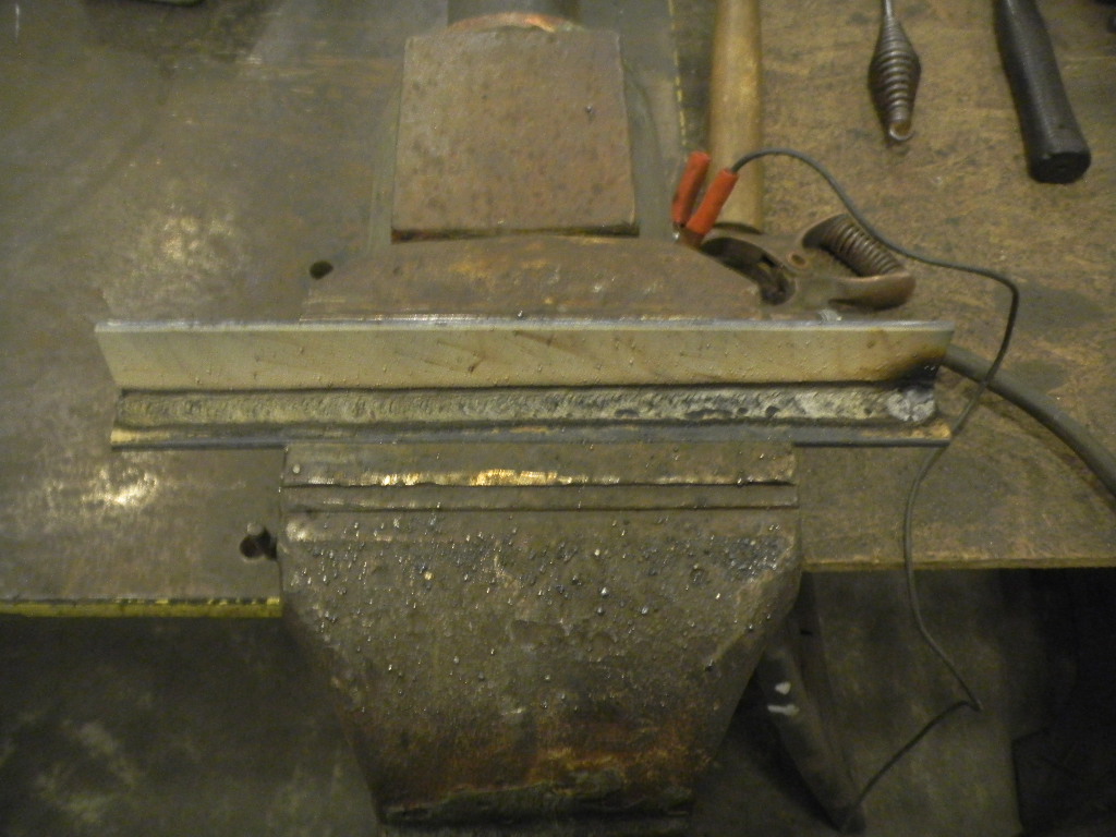

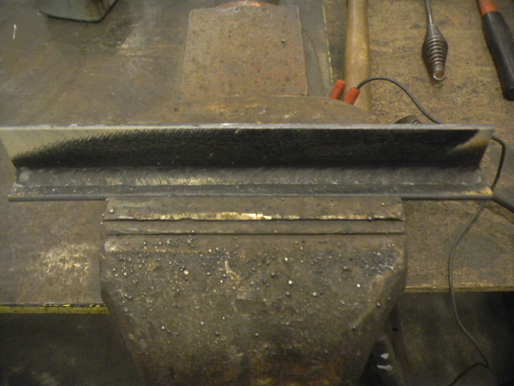

Your assessment of my stuff is useless, the welds are good, and my eqpt. is good. I use my generators for more than welding, they are really great units, quiet efficient easy to start, easy to toss in the truck.
I don't care if dwelling isn't a proper welding term.
I did this weld with the Multimatic 200, on 240v from a 5000w (10hp) generator. I was disappointed that I had to use the MM200's "1/4" thickness" setting but that's all the generator could put out. But it worked, and I wonder if it was better toi be on the 1/4" setting, the heat was so concentrated, going round and round. I am proud of this repair though.
376162d1400644046-total-welding-newie-here-img_7819the_weld-jpg
And I honestly don't care if there is something wrong with it but as you can see I'm willing to be humored. I actually feel a little lucky it turned out this well. I had to rotate the shaft with one hand while welding with the other. This was about 1 week ago.

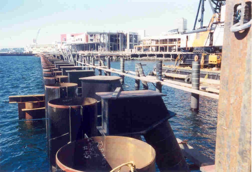

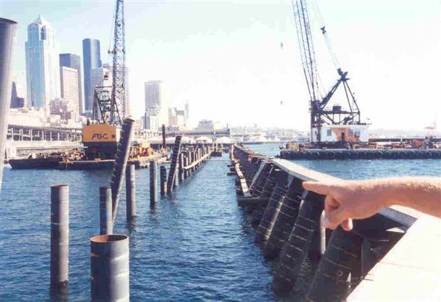

It's a strange thing looking at welds. On this project down town Seattle I was the field superintendent. I fired 12-weldors on this project just by looking at their welds. Every inch of weld on this project was UT'd. We did not have one failure:cool:. The crew would weld all day, then I would go out after they left and look over every weld. Mark the sections I didn't like. Have it replaced the next day. If it happened twice to the same weldor I'd get their money. We were subcontracted to PCL out of Canada. The Port of Seattle hired Lease Crutcher Lewis as the construction management group. PSI was the 3rd party inspection company. I would not call for the welding inspector until I was satisfied with all the welds just by looking at them. When the job was almost complete there was a meeting, I wasn't there but my project manager was. The rep for Lease Crutcher Lewis made the statement that it was strange we had all that welding but not one failure. He thought there was something funny about it:eek:. The rep for PSI went through the roof. Threatened to sue for slander.

It's a strange thing looking at welds. ??. Mark the sections I didn't like. Have it replaced the next day. ?..
I hear that, and understand it. The money is there, the contract specifies the standard, you have enough good welders to choose from, your schedule and budget allows you to weed thru them and get the very best. While I'm interested in this process of perfection, it's not required on a hobby & maintenance tractor welding forum.
