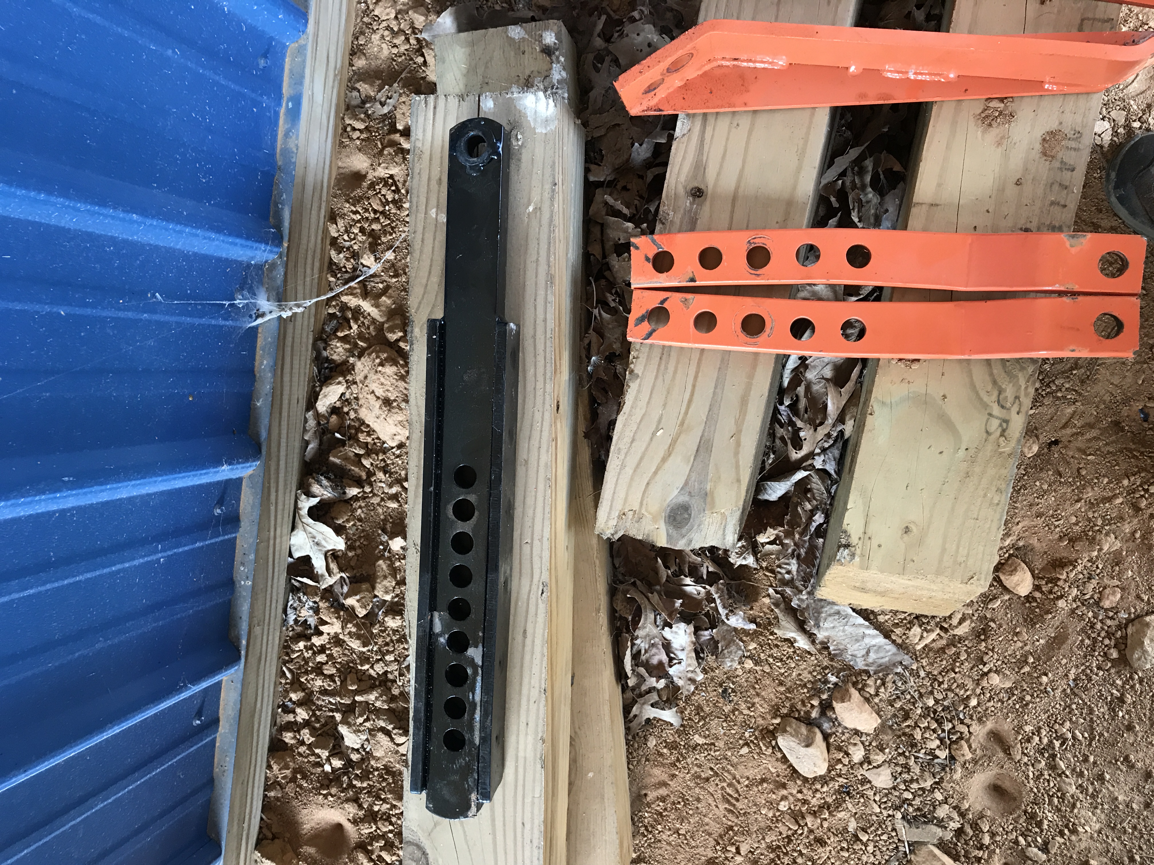

Good news, fellow WoodMaxxers. We've got our WM8600 up and running like a son of a gun. After a disastrous beginning when we didn't know how to lock the hydraulics on our new tractor and bent the upper link arms, we mounted Maxxie to our old tractor, a Deutz 4506.

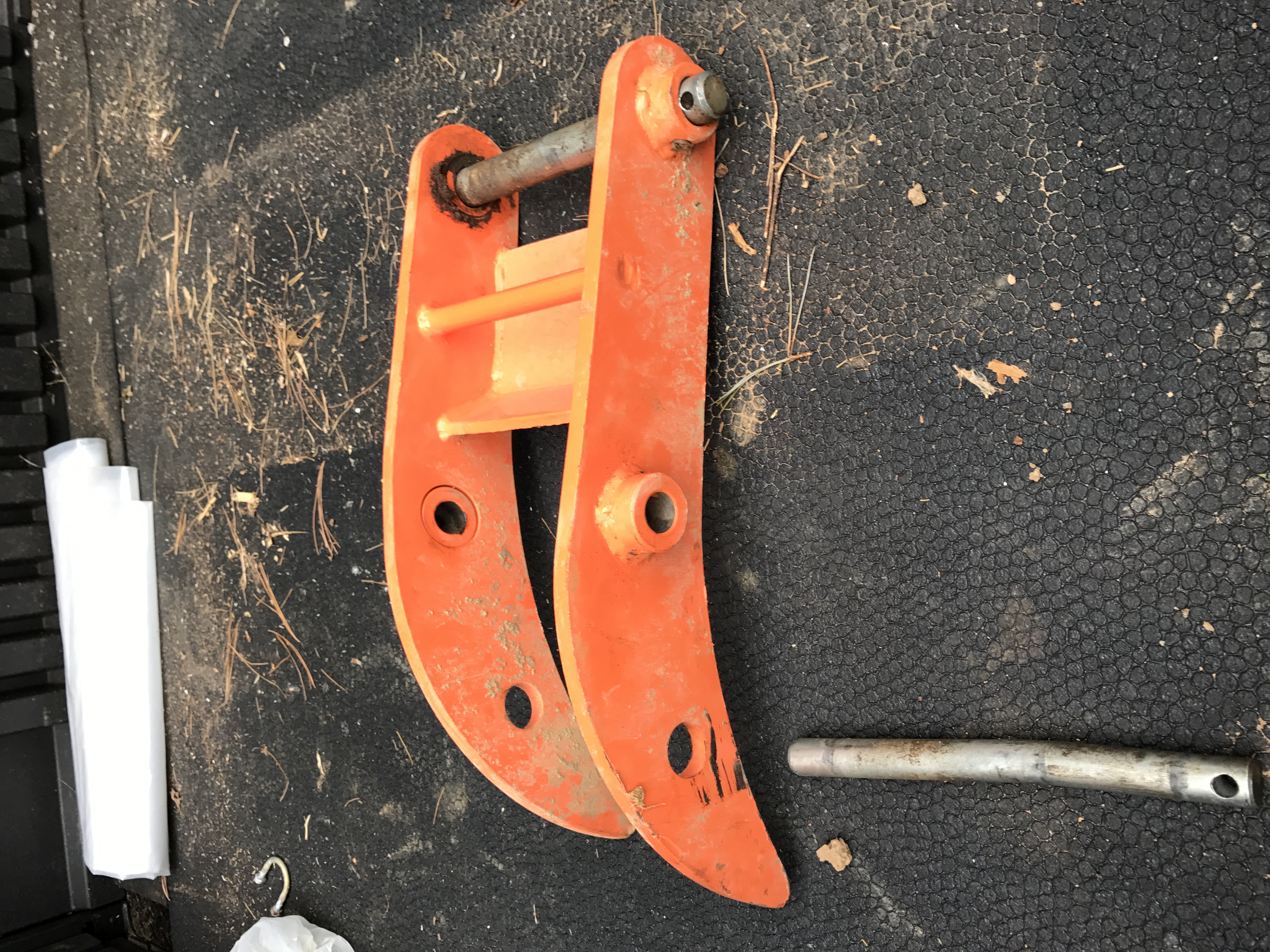

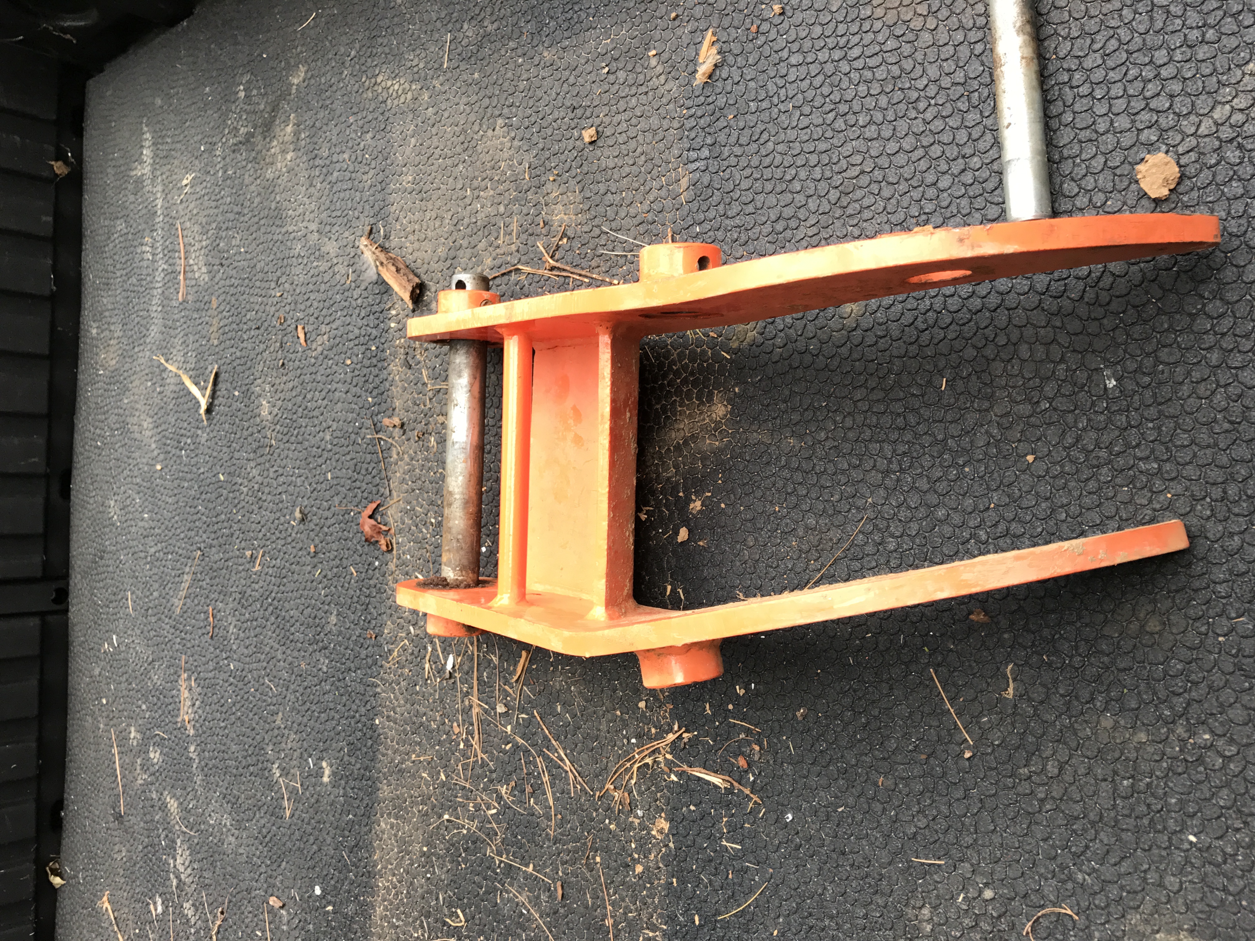

When I bought Maxxie, I bought a ripper. We started out with that and had fairly good success with small stumps and a minimum of dirt removal. The larger stumps demanded more digging, loosening and rocking to break loose so we went to the 12 inch bucket. I am really glad I got the 12 inch instead of the 18 inch bucket that is optional for the same price. I think the ripper will still be useful for ripping out hedges of Yaupon and the like.

Common issue with bending parts of the top link. They’ve changed the design a little since I bought mine in 2013, but it still bends parts. The fix is to convert it to attach by a subframe. I have the old Chinese hydraulic valve they used to sell with the unit which makes movement very erratic with the boom up/down and left/right movement. The controls are like on/off switches vs graduated movement effecting speed.
