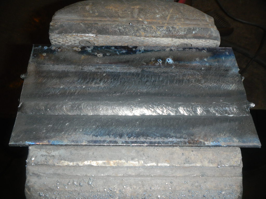

Speaking of welding sheet metal. A lot of guys don't believe this can be done. It is a challenge:shocked:, you have to find the sweet spot for stick out real quick, and maintain it.
.045" NR-212 10-GA lap joint, and fillet weld on a CC only engine drive. Some people say it can't be done on CC, you have to have a CV machine to weld something this thin.
