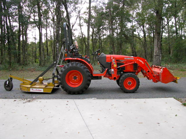

GManBart has given good advice. I will add a little to it.
You need four wheel drive (4-WD) for snow work and woods work.
The most useful of tractor accessories is a Front End Loader (FEL).
You will want 5/16" chain grab hooks on the FEL bucket which will grab both 1/4" and 5/16" chain. On a compact or sub-compact Ken's Bolt On Grab Hooks are hard to beat.
Stability is increased two ways: by adjusting the tractor wheels wider and by adding liquid to the rear tires. Some models have axles adjustable from the factory, in other cases wheel spacers are installed. Partially loading the tires lowers the center of gravity.
(If the wheels are adjusted wider it will be more difficult to access your woods.)
If you are going to work in the woods, avoid a mid-PTO. They tend to collect brush,vines, dirt in the woods. Run your PTO powered attachments from the rear PTO which is part of the Three Point Hitch.
"Easy to get attachments on and off". Everything is relative here. Light tractor attachments for the FEL are 60+ pounds, implements which mount on the Three Point Hitch are 300+ pounds. Some implements, such as a rear snow blower, require connection to the tractor's Power Take Off (PTO) which means you have to connect the implement PTO shaft to the tractor PTO splines which is always an awkward and greasy evolution even with practice.
There are multiple factory and aftermarket connection options, in a very wide range of prices, debated here. In my opinion, from the factory, Three Point Hitch pin-adjustable stabilizers + telescoping Lower Links are the best option. In the past these have been available only on larger tractors but they are becoming more available as options on compact tractors.
Aftermarket, the most expensive option is the Delta Hook set. If easy attachment is really high in your priorities you will want to research Delta Hook.
Sub-compact tractors come with a Category '0' Three Point Hitch. Implements for Category '0' are limited. Compact tractors come with a Category 1 Three Point Hitch. More implements, new and used, are available in Category 1 than all other categories combined. I recommend a tractor/loader with a Category 1 Three Point Hitch.
I operate a Kubota B3300SU Tractor/Loader, which Kubota sells as an all-up package for $20,000. I bought this Kubota because the decisions were made and it is almost complete (you need bucket hooks) and because the Kubota dealer is just six miles away. I work in the woods. This tractor has 14" ground clearance.
I am sure other tractor producers offer similar packages.
