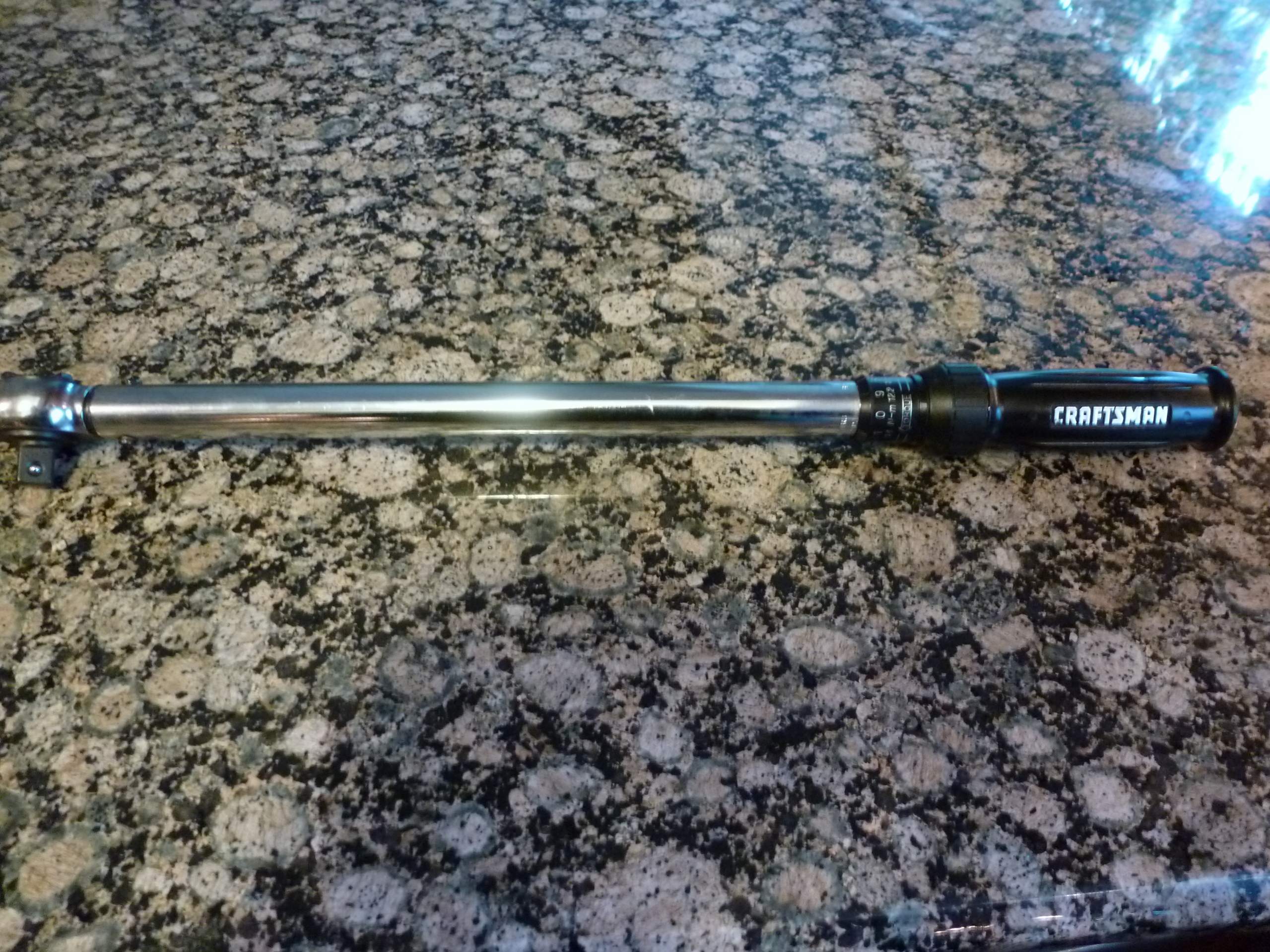

well after getting all this good advice, I thought I really ought to get my "old" unused Craftsman torque wrench out and inspect it, didn't even know what I had.
Not smart, I know.
And lo and behold it sounds like the one a few of you have, rated up to 150 pounds. Might have what I need and was simply clueless.
Not smart, I know.
Don't be too hard on yourself.... I know I'm overdue to do a proper inventory on my stuff too ! :laughing:
Perhaps you were just testing the full 150# setting, but if this wrench has been stored set like that, you need to relax the spring. Drop it to 100# for a day or 2, then 50#......
Either way... try and find somebody local that you can test wrenches with, esp. before doing something critical (ex. cylinder heads).
Rgds, D.

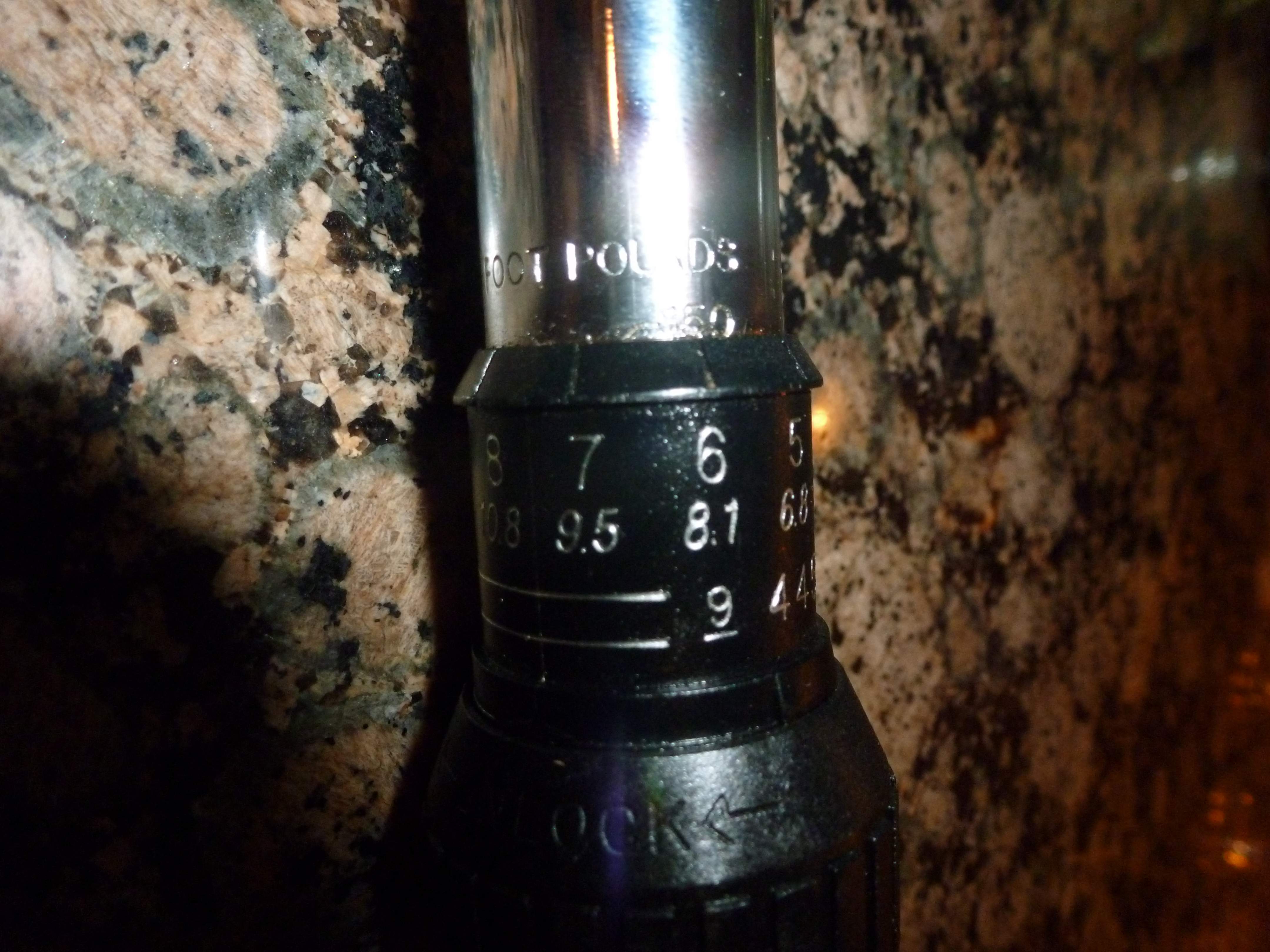

thanks, when I was looking at the wrench and it was set all the way high, I knew from this discussion that I needed to fix that. Kind of like a decompression chamber, but for springs...
Now I have to look up what the torque setting is for my Land Pride mower bolts and see if 150 is enough.

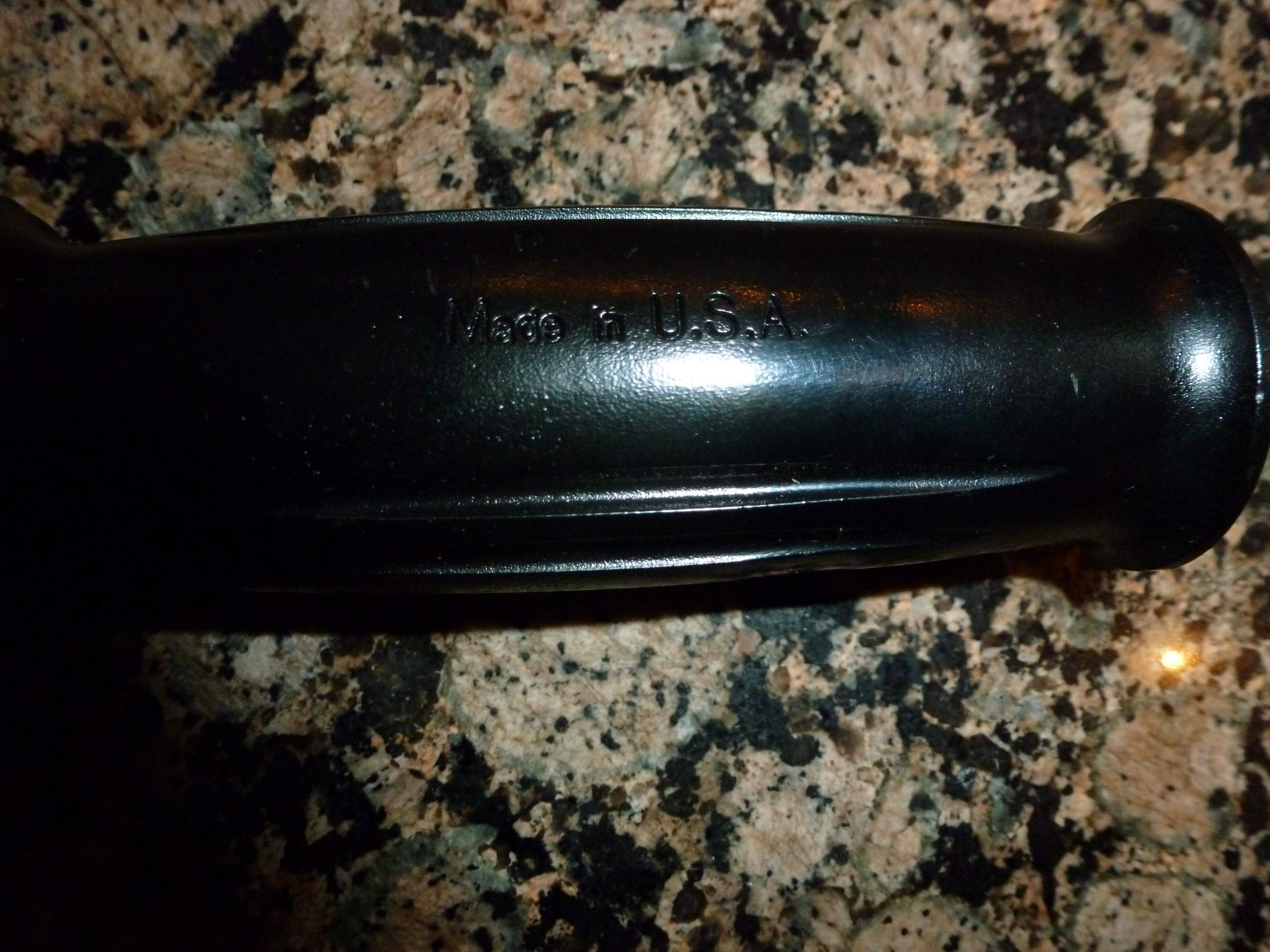

here's a silly moment. I can't read the little markings on the shaft, the thing was screwed out too much. So I see Foot Foundry, and now I wonder where that is, but at least it's in the USA.
Seemed an odd supplier to Sears... and of course as I turned the knob down and all the words could be read, it was Foot Pounds, not Foundry... and a lot of reference to newton meters, but when I saw
the 150 become visible, that's what I wanted to know. I wonder who made this for Sears some ten years ago.
/ torque wrench recommendations please #31
Best info I can find on the web is that Craftsman torque wrenches are made by JS Technology in Georgia (a Danaher company).
Well at least its USA
