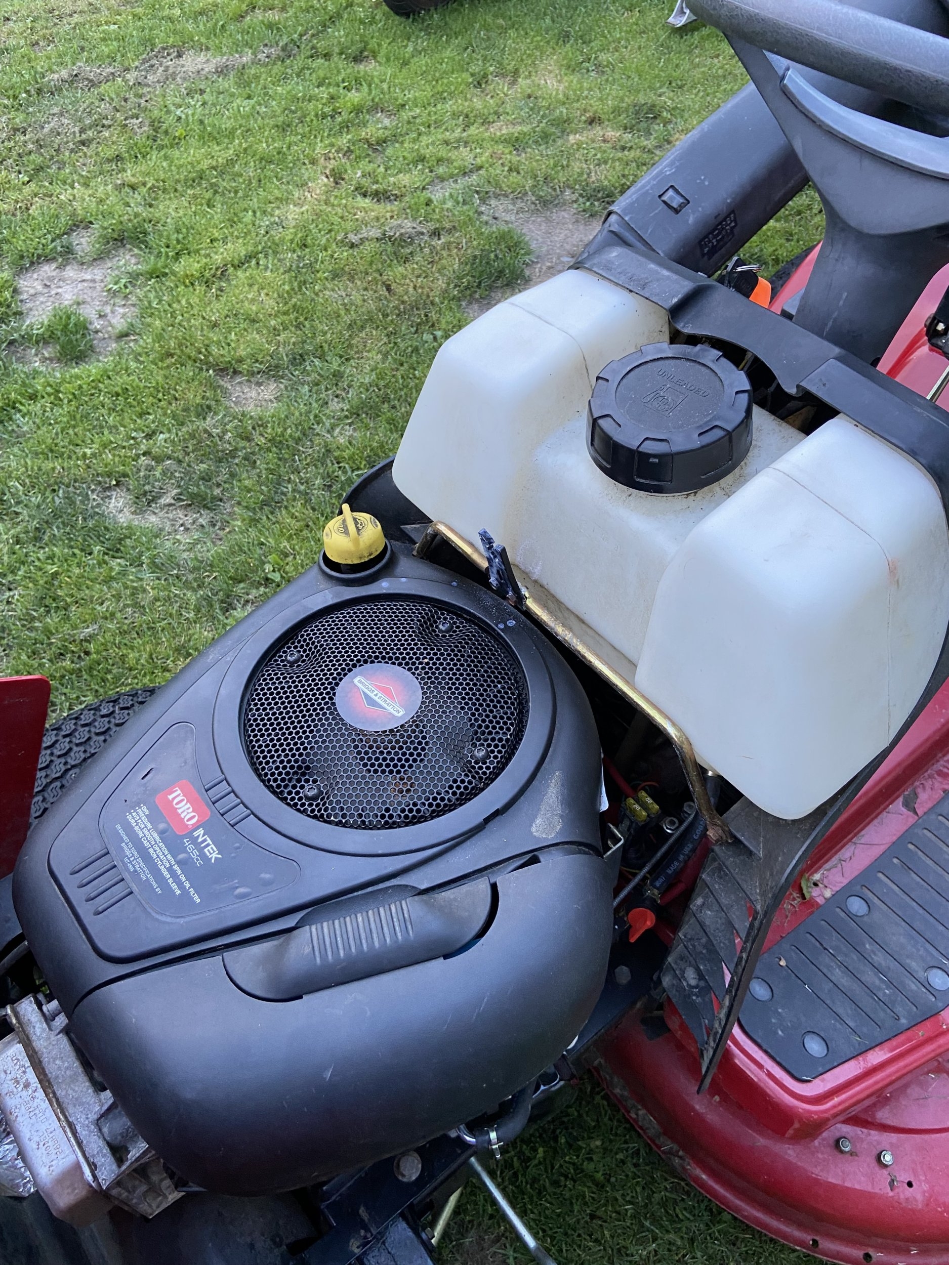

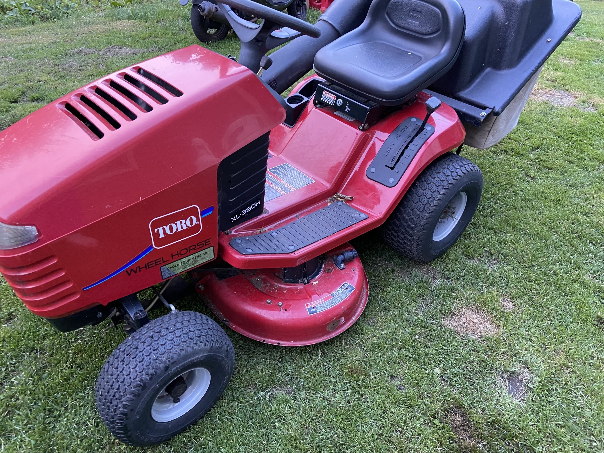

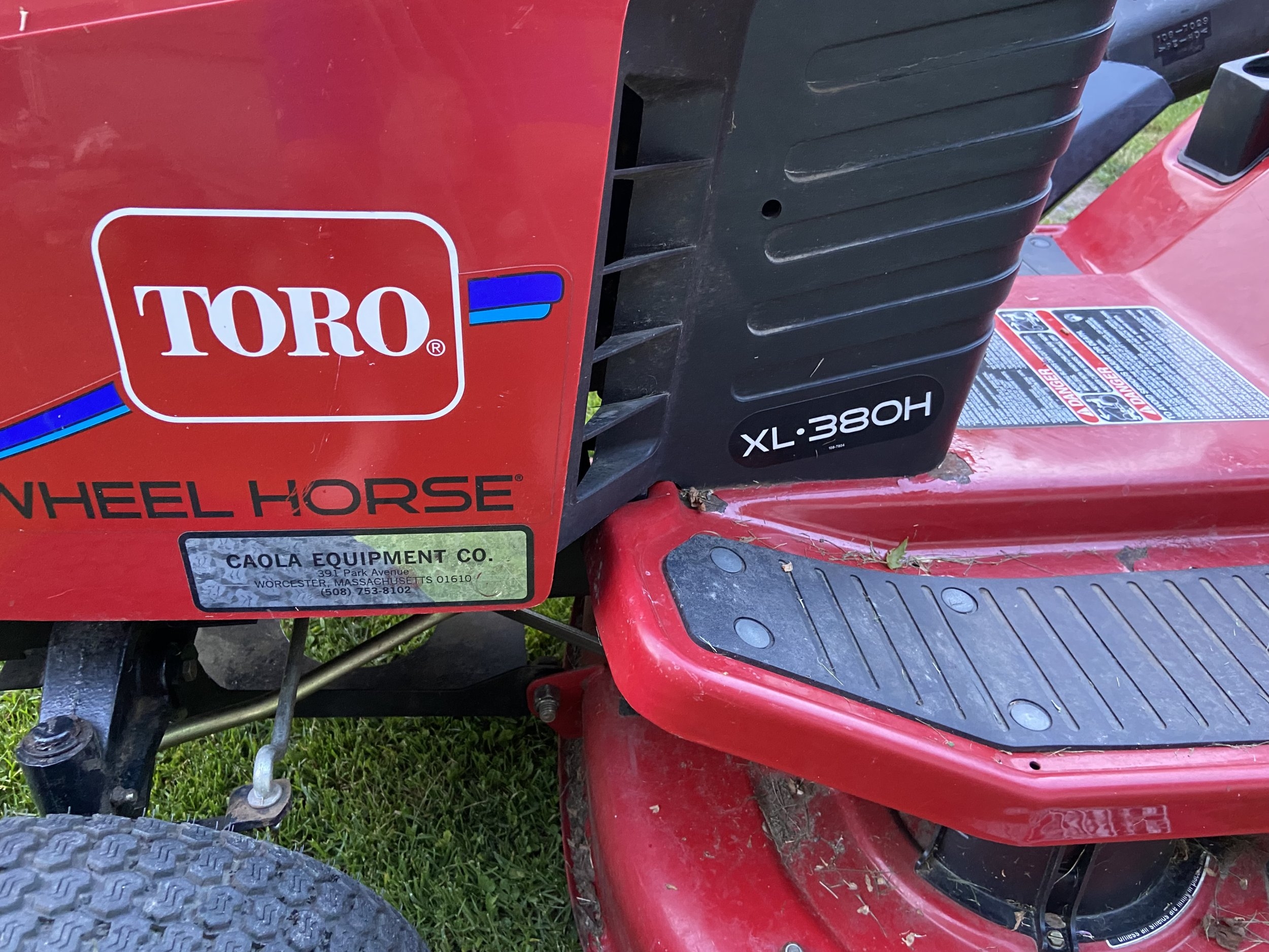

I have a Toro Wheelhorse that sat for a year and I’m trying to bring it back to life. Drained the old gas, got a new fuel filter, out on a new carb …and it starts right up and drives around in flat surfaces. But the minute I go up a hill or engage the mower deck, it sputters …assuredly because it’s not getting proper amount of fuel? Carb only appears to have one air/fuel screw and I’ve turned it out and in but no change.

Briggs model: 286H77 type: 0165 E1
