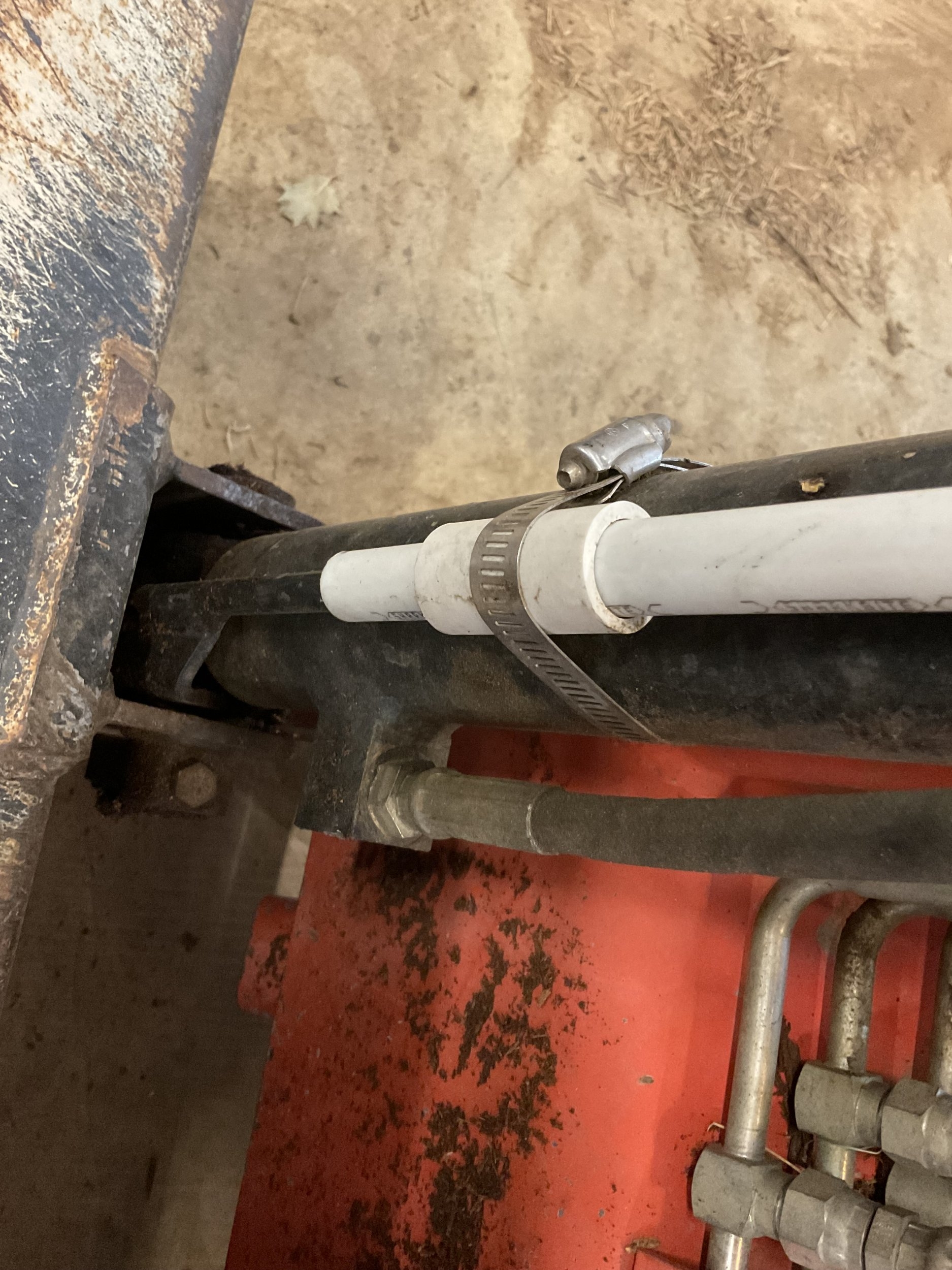

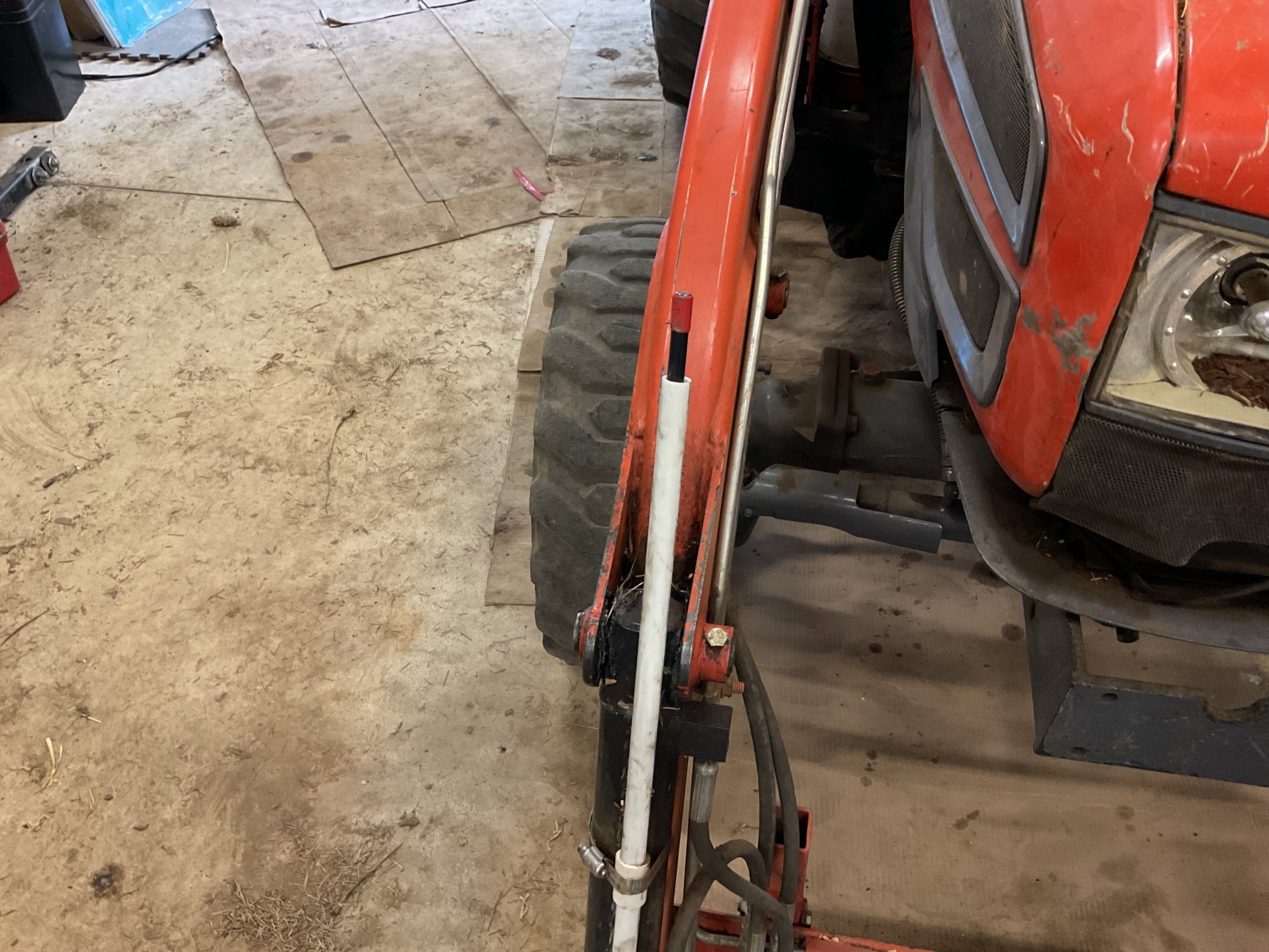

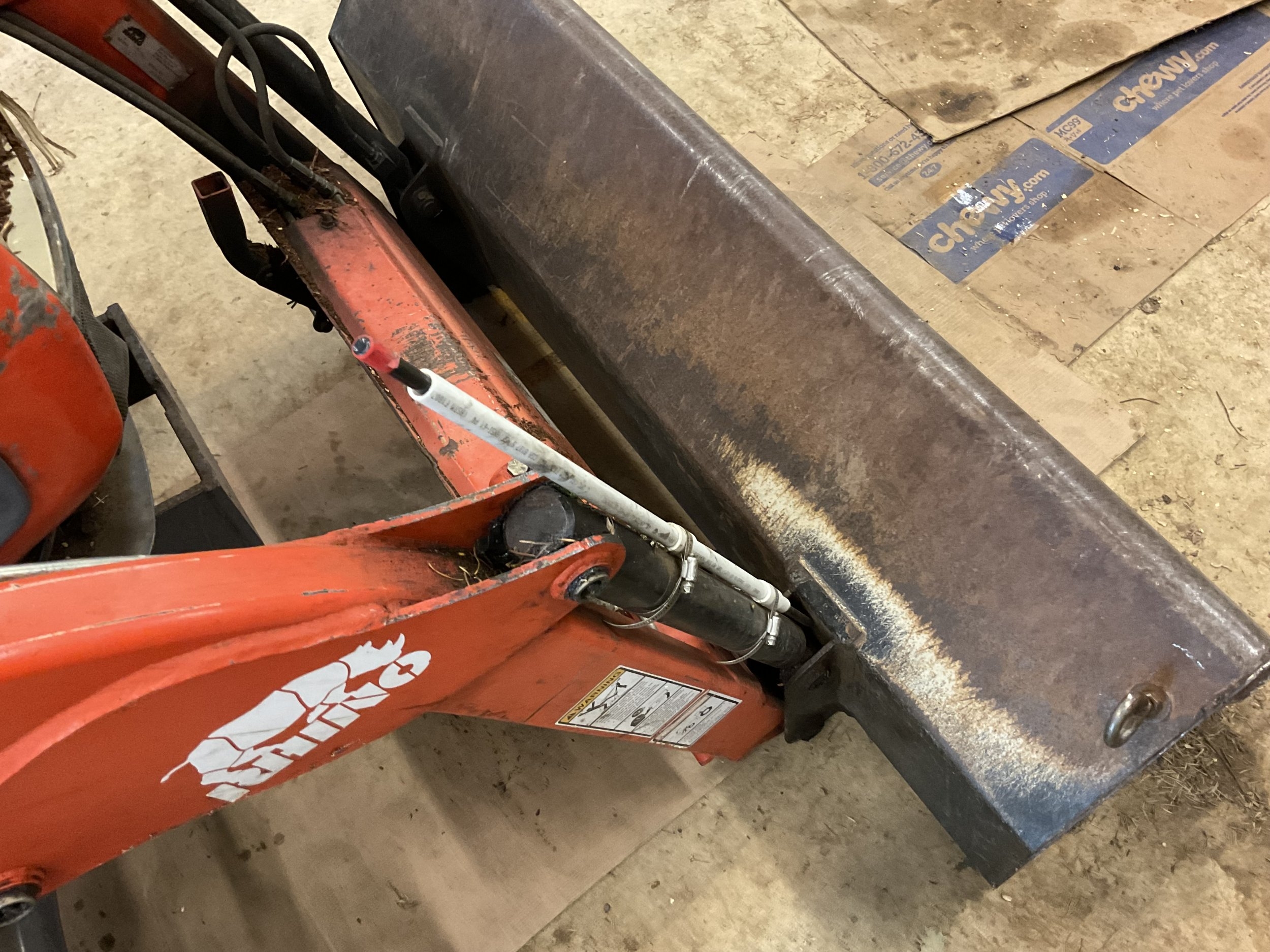

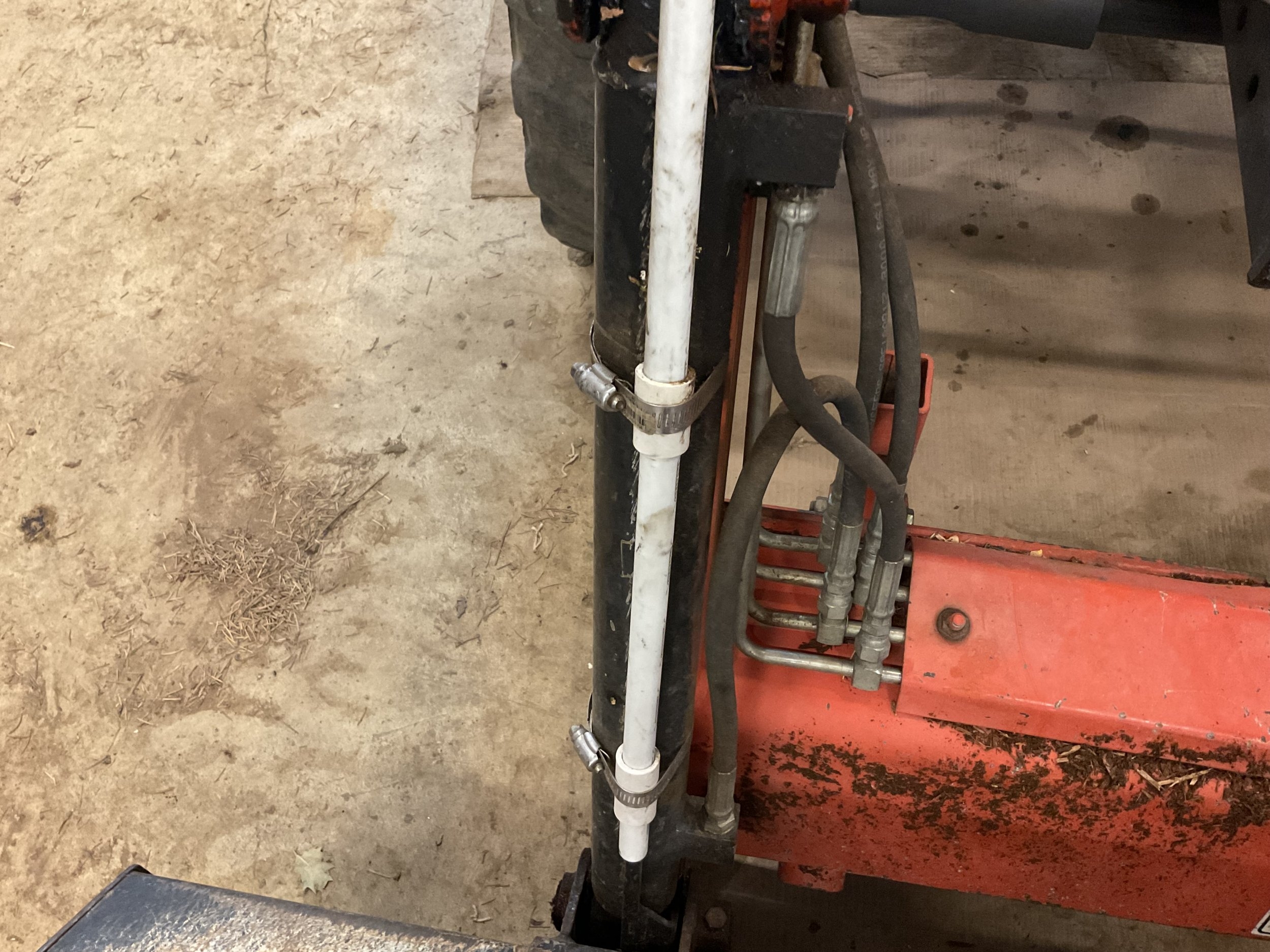

This is what I did. I ordered the rod from my Kioti dealer and then fabricated the rest from PVC pipe the pictures tell the story!
We have a CK25 2005 model! IMG_5388.jpegIMG_5385.jpegIMG_5386.jpegIMG_5388.jpeg
