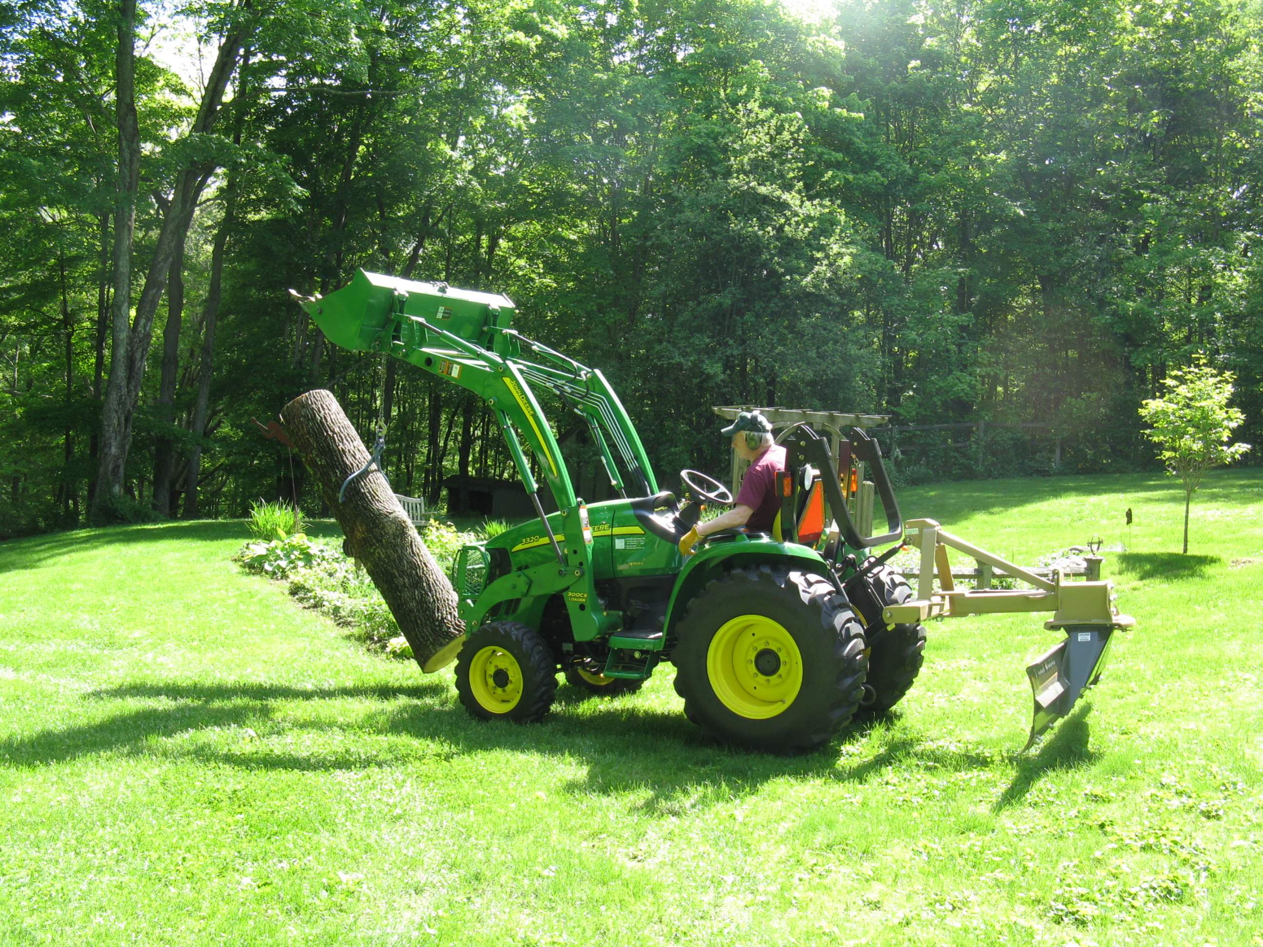

I'm pretty sure a lot of you guys have already learned this, but here goes.
For 12 years I had used my 540 loader on a 5200 for moving 7-9 foot logs to the landing. But that bucket had only a cutting edge and when used with a set of tongs and chain...just a couple degrees out of level would cause the log to slide to the low side. That meant carrying shorter lengths so the bucket would be closer to the ground. Or most often drag it out and get the usual load of dirt and grit that just chews up the saw chain.
So the picture shows the 3320 with a toothbar carrying a 7 foot piece of ash with a chain and tongs. Pretty level ground here, but out in the woods you find that the toothbar teeth limit the movement to only about 8 inches. Thus a lot more control without a feeling of instant rollover. This still is a dangerous move and requires a decision to go/no go based on conditions.

Wow- just looking at that picture makes me nervous- may want to put up the ROPS...

Mustang, you bet, the rollbar is up when I'm going to work. I had just pulled out of the garage so my wife could take the pix.

Wouldn't be safer to just ratchet strap the log across the bucket? MIght take longer, but I am sure you will live longer too!
I did that once with a 4 wheeler so I could work on it, part of the 4-wheeler was still on the ground and darn near rolled the tractor over and it wasn't even moving.

Luv that bad a-- Landpride R/B 3584 :thumbsup:

I'd rig the log so it would lift more horizontally...keep the loader lower.

Uh got a set of pallet forks? Im not a member of the saftey club but even this looks dangerous to me.

I can see a new implement on your future.... grapple :thumbsup:

Why not just skid them with the 3 pt? unless you don't want to rip up your yard or get them a little dirty.... I've skidded 2 -30 foot tree tops at the same time branches and all with the JD2520. I could not and would not carry logs like that at my place, I would end up on my side!!!!! I could see picking them up like that to place them for cutting but that would be it....:confused2:

Man if you are doing that on a regular basis...put a thumb on the bucket!That looks like a accident waiting to happen.At least weld on some hooks to the top of the bucket and chain...horizontal.

Another vote for a thumb on the bucket. One of the best investments I've ever made.

Very nice tractor. Looks like at least some clamp on bucket forks are in your future. :) Very handy for all kinds of things besides picking up and carrying logs.

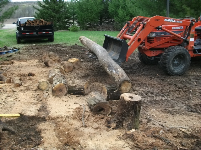

Here's how I do it on a very regular basis.

Well Guys, thanks for all the comments. As I said in the Opening Post, this use was dangerous and you have confirmed that feeling...as well as provided ideas for the next attachment needed for the job. Options mentioned were pallet forks, bucket forks, grapple, bucket thumb and Loader buddy.
