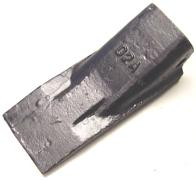

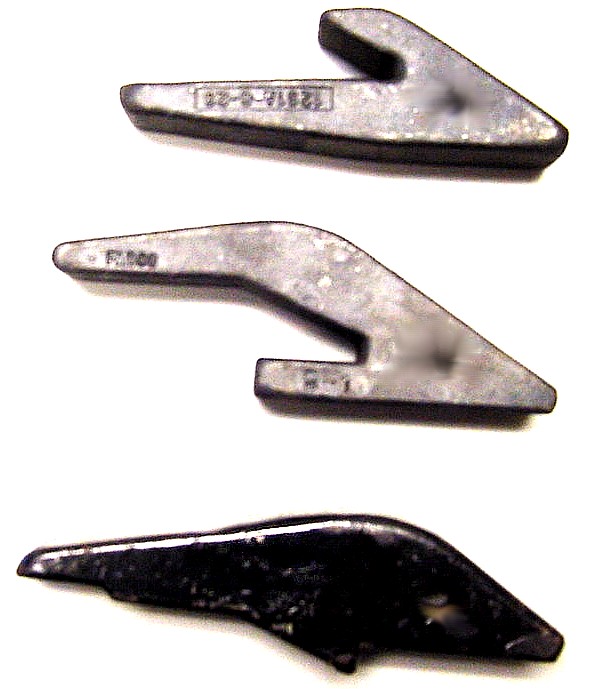

well I don't want to start a new tooth bar thread so I though that I could share the source of where I purchased my teeth and shanks.
This was this best price that I could find. I ordered 6 shanks and 8 teeth with shipping to maine it was $88.00 Now to find time to put it together
RippermTeeth
20ATooth1 1/16"
$3.25​
20WOShank Flush Mount 1 1/16"
$9.00​

I just when back and looked at the pictures again and noticed that you welded the tooth to the shank in the crimp hole. Why? will they fall off if I just crimp?
Thanks
Phil
/ TOOTH BAR
#17
philbuilt said:
GIJOE,
Thanks
Phil
The tooth is not welded to the shank. These are not crimp on teeth. What you are looking at is the end of the pin that is driven through the hole to hold the tooth on the shank.
Joe

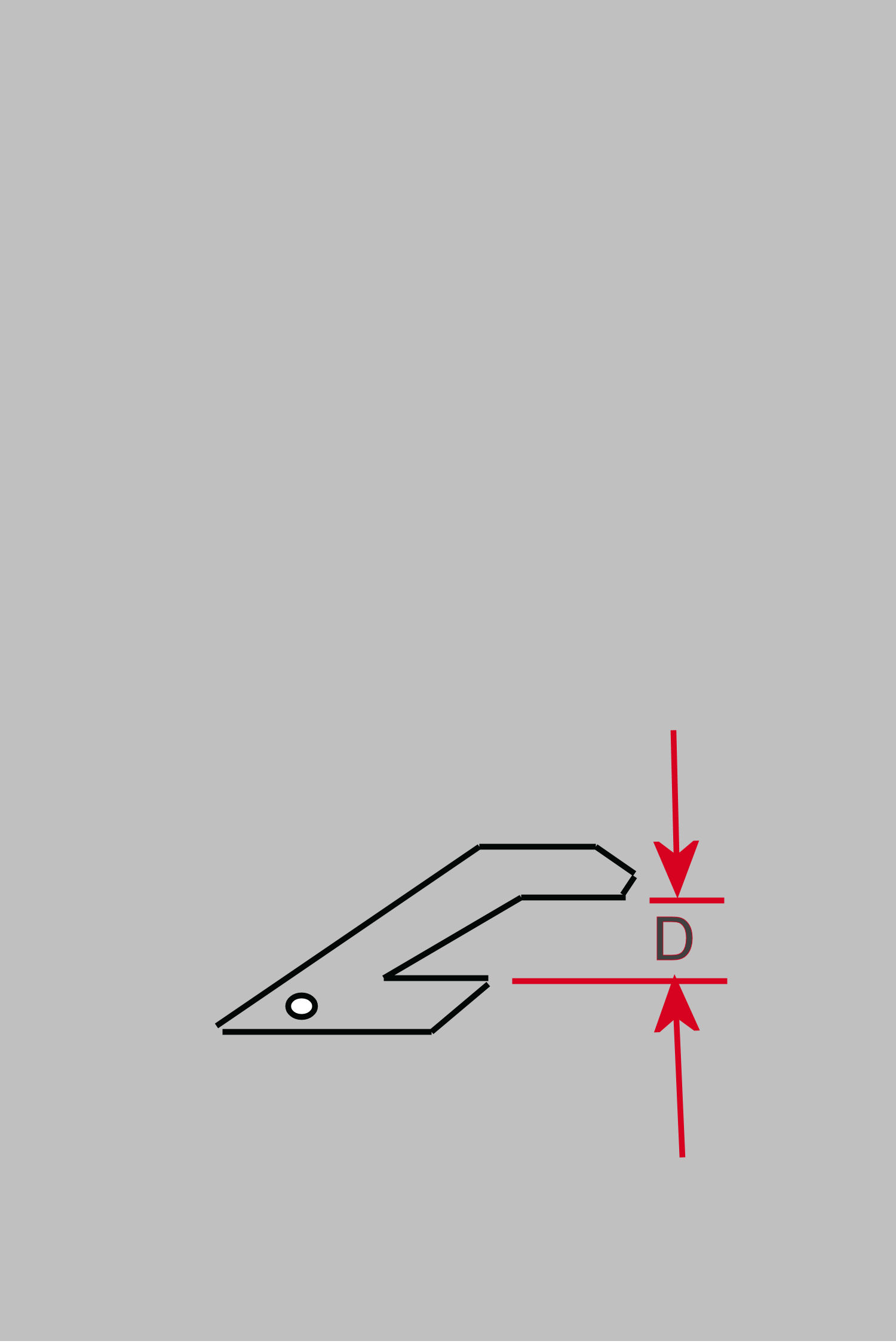

Joe, based on the Fabco TB-1001-23 specs, these shanks look like they may fit my B26 bucket with the bolt on cutting edge. I'm hoping you can take a critical measurement "D" shown in the attachment.
/ TOOTH BAR
#19
RichT,
The measurement you ask for is 1-3/8". hope this helps.
