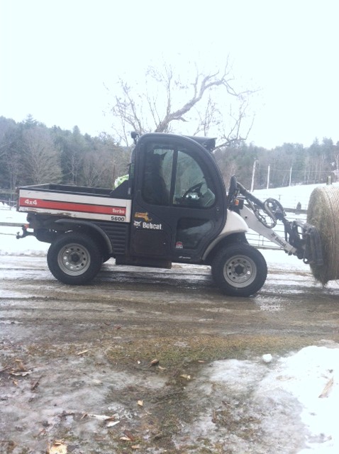

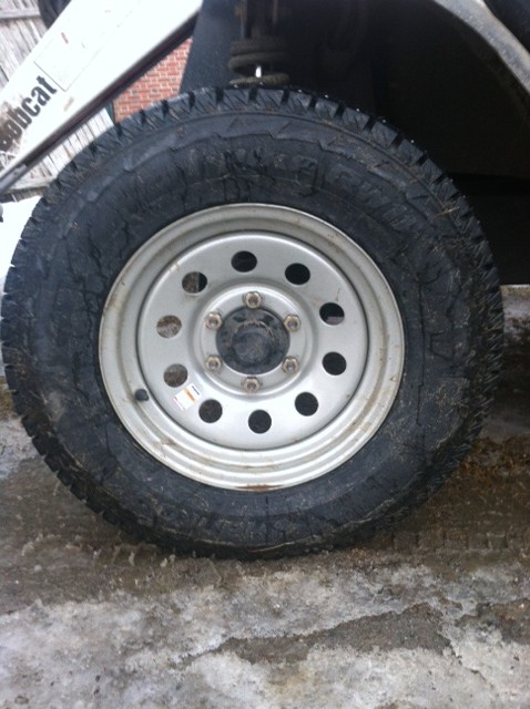

I got the rims but I am having trouble getting studded tires - how much do you think the studded add versus M&S winter tires?
I am plowing-snowblowing and moving 4' round bales with studded tires on steep driveways and rough pasture for feeding bales. For 6 years I used chains on front tires, often had rear end slide sideways on hill or lacked rear traction when front end was in ditch. So far studded tires have eliminated those issues but I never tried Hankook snow tires without studs?
Best part's are ride is so much better in rough conditions and added confidence crossing spots I had trouble with in the past. Also not having to worry about tire chain coming apart.
I did use bucket to clear a concrete feeding area the other day of packed hay and noticed the narrow snow tires do not give me the same traction as the skid steer tires in those conditions.

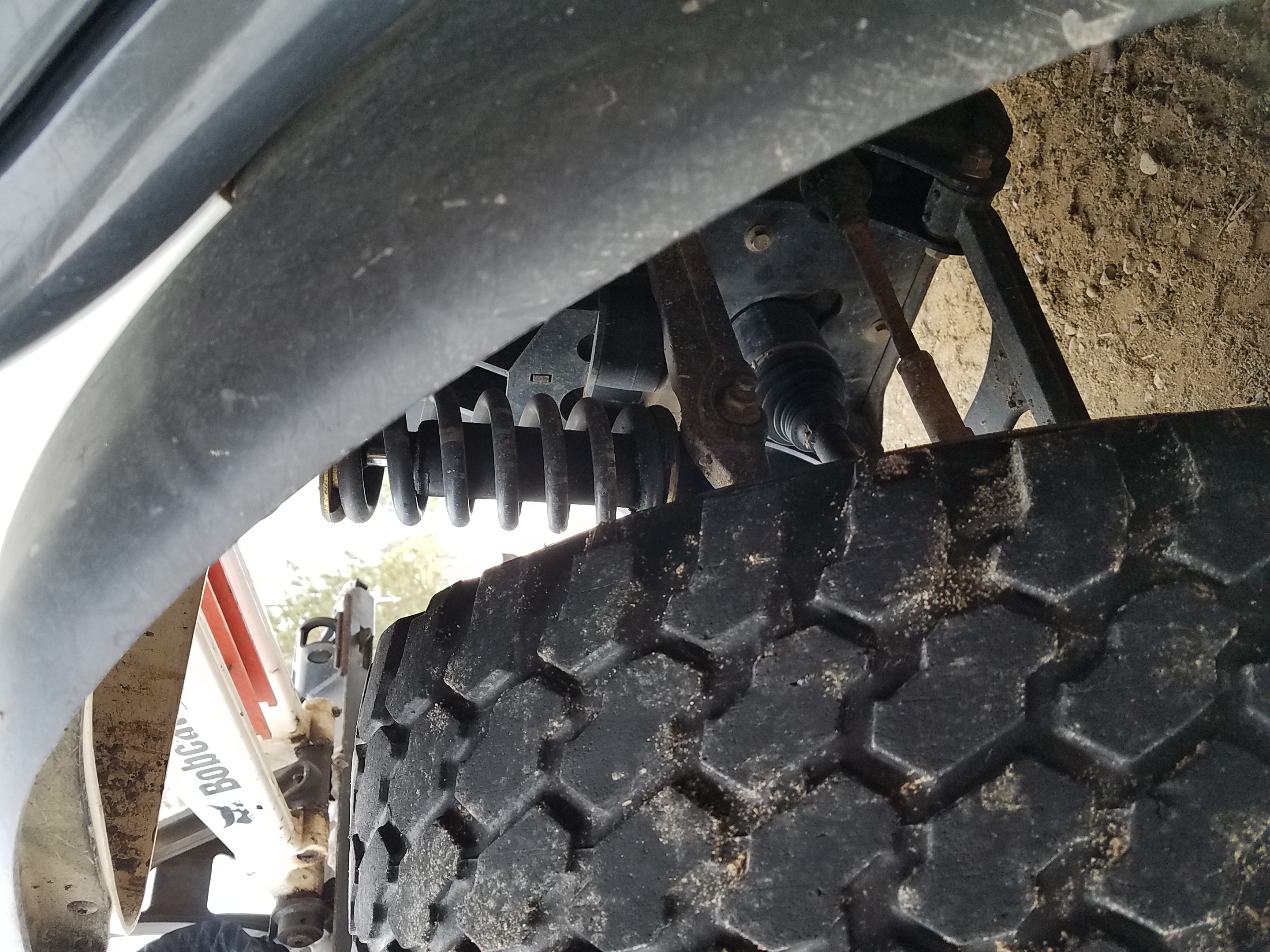

Old but always applicable thread... In the past I've always used chained-up LT tires (8 ply) during snow season. We get LOTS of cake ice and I would certainly be down the gully without chains. I no longer do snow removal commercially and this year I decided to use my "normal" 8-month tires which are something like 265/75x16 off of my old Tundra. These are worn but aggressive tires. So this is only 12/6 and we've had but one substantial snow (about 7"). Nevertheless, for around the homestead, I've found these tires to be quite decent. Sorta surprised me. Our driveway is also asphault (coated) and my old chained tires did leave scratches...but nothing that I was particularly concerned about. I'm going to hang-out with the chainless approach as long as possible. Makes for a much easier riding TC as well.

Hey Spudgunner do those 265's rub at all? I was thinking more like 245's I have a 2016 5610 and need the all wheel steering. your thoughts

I have not had any problems with rubbing and my machine pretty much lives in All Wheel Steering all the time. But I do not have chains on these tires and I haven't had my Toolcat in every twist possible...so no guarantees. As per my much earlier posts in this thread (pg1/2), I have always used 15" LT tires with chains in the winter. Those have worked very well and height-wise are closer to the stock R-4's (?). Since those old posts of mine, I have retired and I pretty much just do snow removal for myself and some of my neighbors...and I thought I'd leave the small tires/chains off just for experimental purposes. You folks, like us, are due for some good snows this week so by the end of the week I may have the chains back on. (I'm probably about 50 miles S of you.) If you think it'd help, I'd be willing to take some pics tomorrow of the tires at full lock to give you an idea of the clearance. Also, machine is a 2007 "D" 5600. Don't know if that'd make a difference or not. In terms of 225's or 245's...I like the idea of a less-tall tire and would look to see what is most common/cheap. I just had these old Tundra tires laying around...so I figured I'd just try 'em.

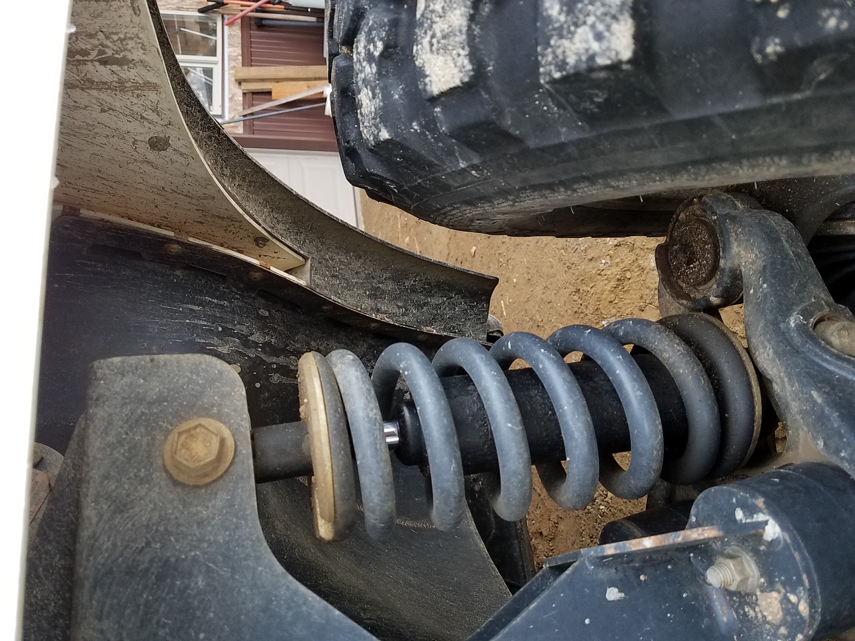

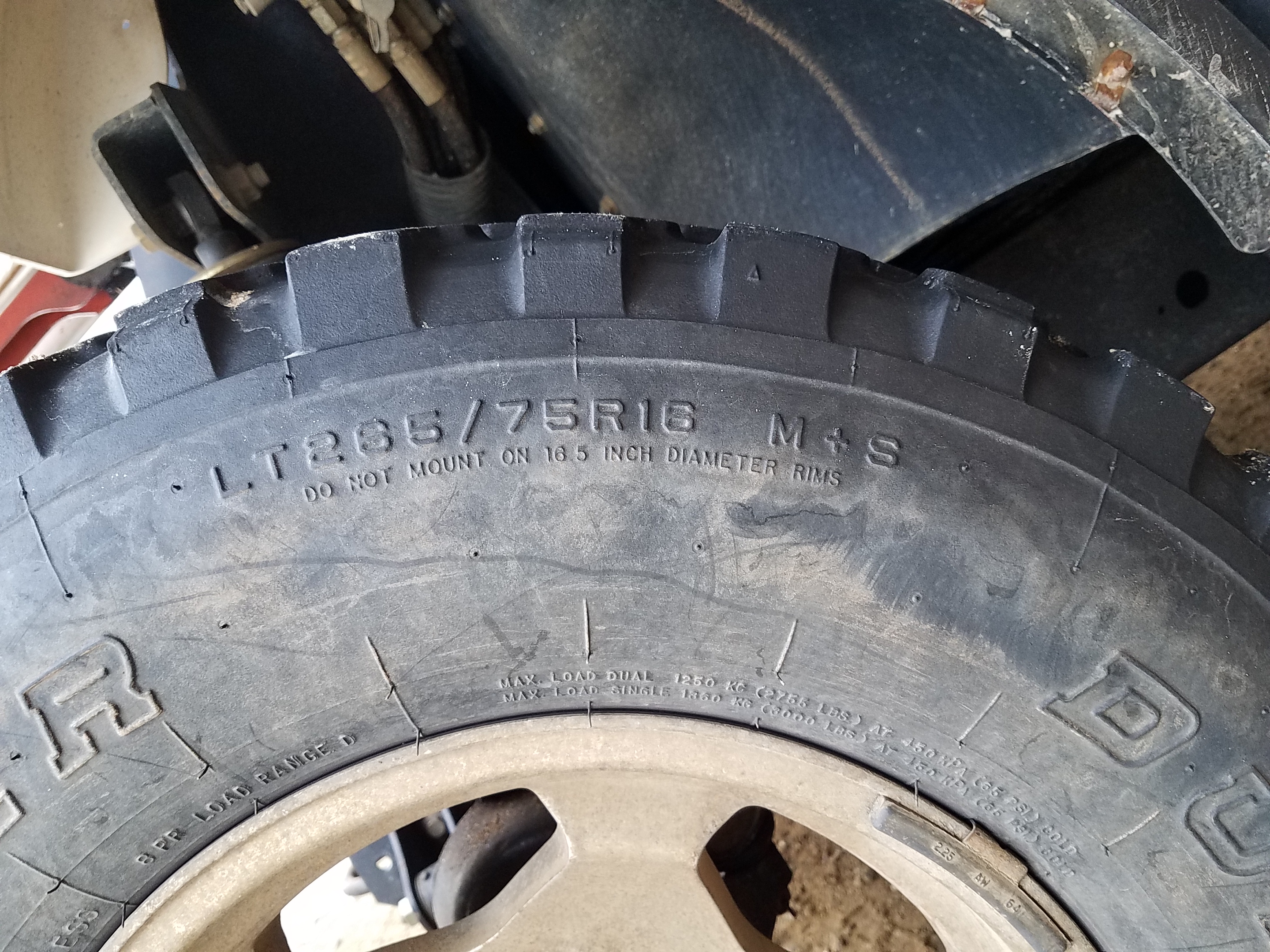

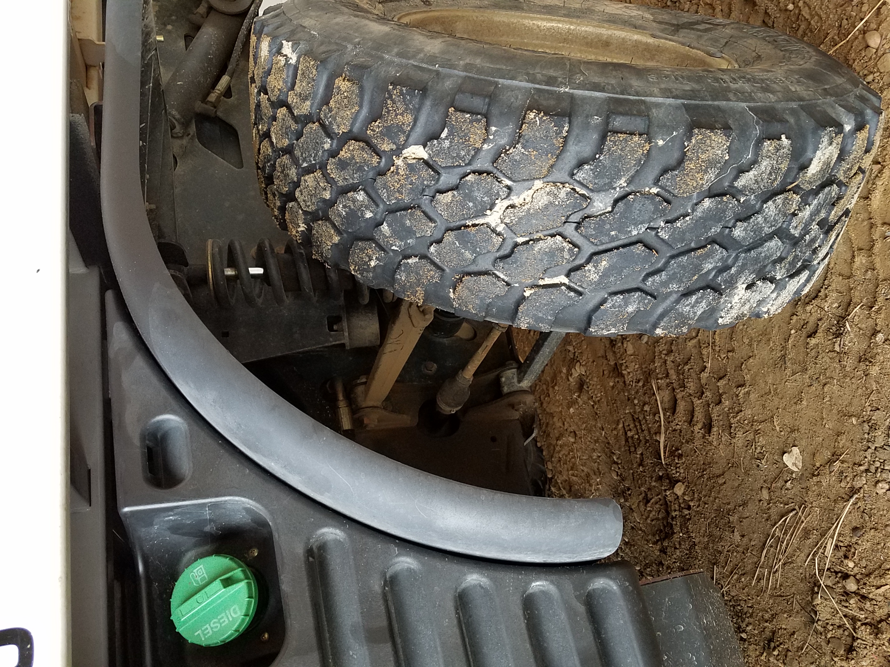

Sorry about the orientation of these pics. They looked fine on my PC but after uploading I noticed that they all need to be rotated CW by 90.
Pic 1 is the machine as-photographed. The blower (SB200-72) is lifted off the ground so as to compress the springs. The second pic is of the sidewall of tires showing 265/75-16. The rest of pics show clearances. The clearances are better than they may look. I did include a chunk of a 4x4 post in some of the pics to give some perspective. Clearance was typically 4.5" or greater. In any event, as she sits, there is good tire clearance. With one or more of the tires dropped into a hole (stuck!) that clearance may go away. Having said that, I've been stuck more than a few times and clearance hasn't been an issue. Pics 3-6 are up front while the rest are the rear. I don't recall how tall these tires are; however, Tire Rack has an nice online chart of tire sizes/heights.
