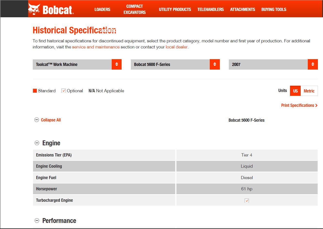

Looks like the F series started in 2007: Bobcat Historical Specs - Bobcat Company

I had seen the Historical listing on Bobcats site, showing the F series in 2007. I am wondering if this is erroneous as The forums seem to announce the 5610 first in 2008 as a D
series. Also, I think that I have seen references to the 5600 D series announced in mid 2007.
Thanks for the help.
/ Toolcat F or G #8
I took delivery of my 2009 D series in Nov. 2008. I'm pretty sure the D series became available in 2007.
