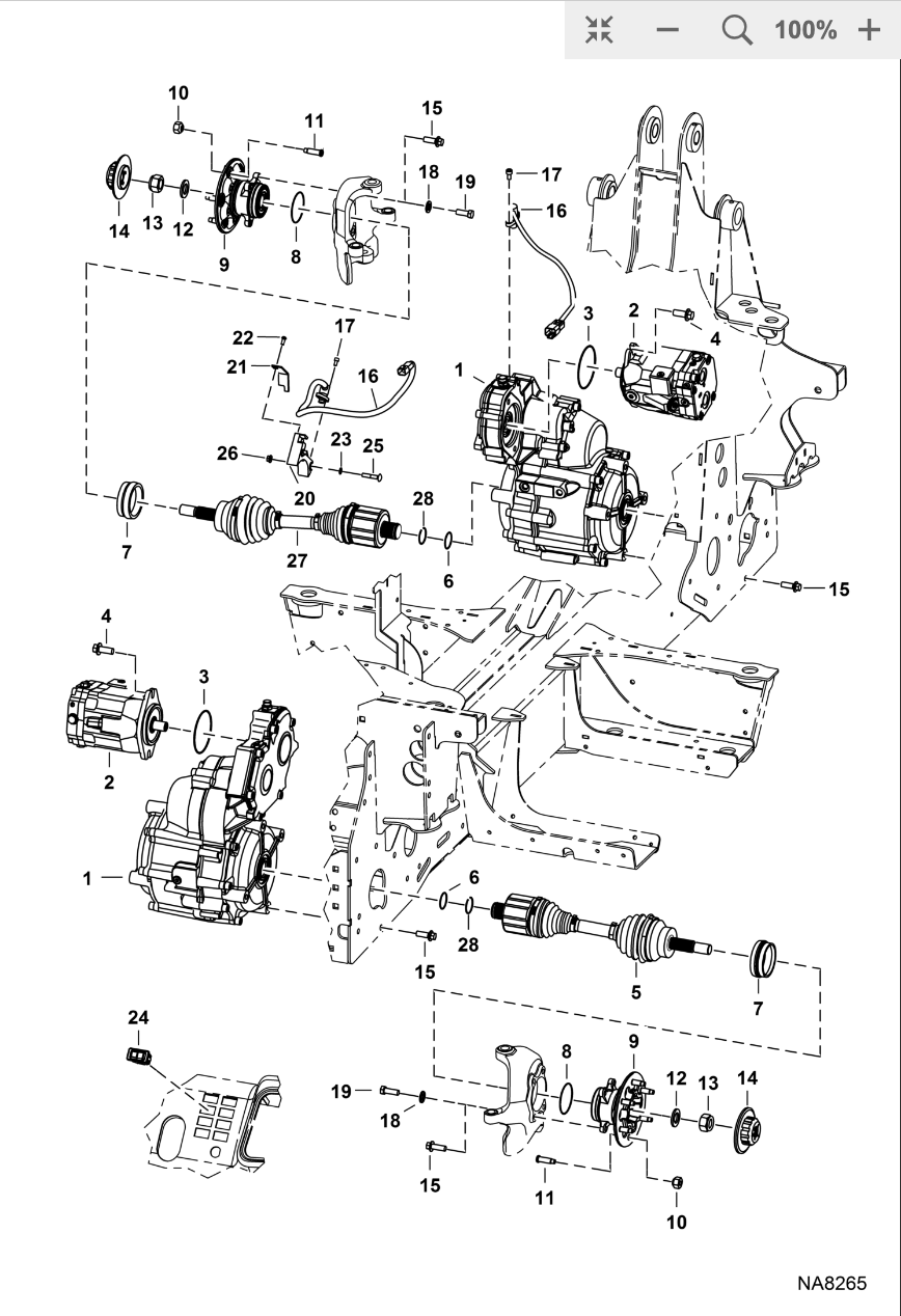

The problem still persists with TC enabled. My only theory I've got left is possibly the wheel speed sensors? Could it be that the TC is not reading the wheel rotation correctly?
Unfortunately the machine did not come with the Service / Owners Manual - I do have one on order, but like everything else in the world, still waiting to receive. Also, the parts diagram online doesn't seem to clearly show where the rear sensor is located.
I can see the front wheel speed sensor quite clearly, but I'm not sure where the rear sensor is located. Does anyone know if it's under the back plate? It's going to take me a little work to get that one off, the bolts are in rough shape.
I'm open to any other theories or suggestions on what to trouble shoot! I did a quick search and couldn't find any other topics relating to the same issue.
Thanks for your time and help!!
I can see the sensor cable is Item 16 - but tough to tell where it's located for the rear wheels!

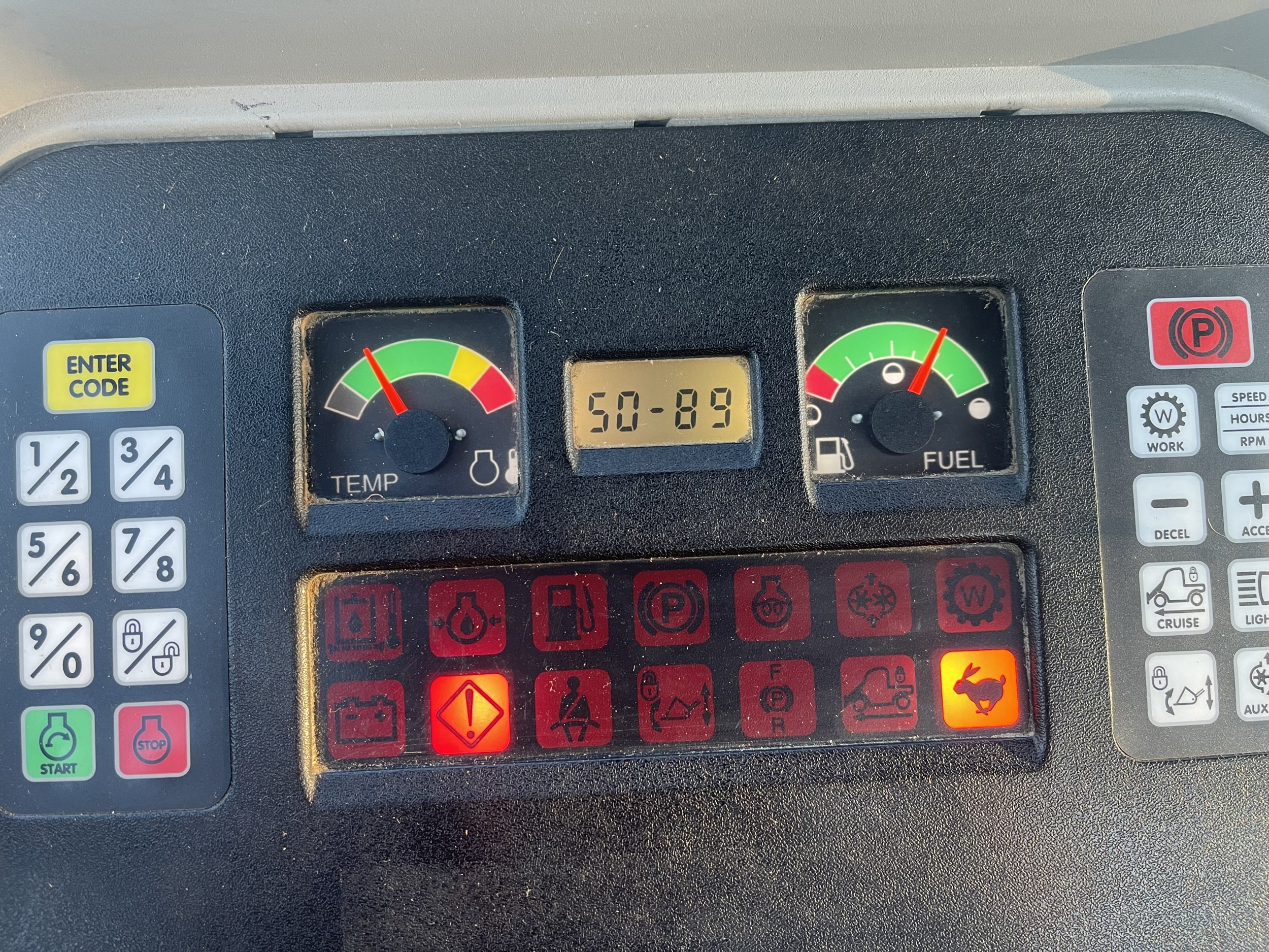

UPDATE: Still no luck on diagnosing the problem - but I did get an error code while trying a test drive today.
Code was 50-89. Can’t seem to find anywhere what that might be related to.

   / 2014 Toolcat 5600: G - Unhappy when Traction Control Enabled #7
My manual only shows code 50-88, not a 50-89. Codes 86,87,and 88 are about the axle speed sensors.
Dealer was able to lookup the code for me. Speed sensor related. He suggested it could either be lack of signal or issue at the wiring harness.
