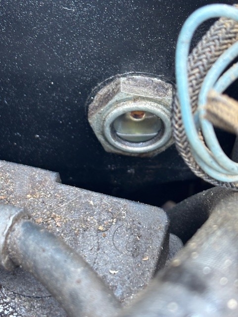

The gearbox is vented to relieve any pressure caused by temperature changes. Any significant pressure in the gearbox would indicate a blocked vent. That could be the cause of the oil leak at the axle, but wouldn't cause the drive issue. High oil level in the gearbox would indicate either a brake piston leak, or a motor shaft seal leak. Either one of these would also put some pressure into the gearbox, but it should immediately be released out the vent. There is a breather at the top of the gearbox, make sure it's not blocked.
If one or both brake pistons are leaking, the oil level in the gearbox will gradually increase whenever the brake is released (when driving). I can't say for sure how fast it would rise, it would depend on the severity of the leak.
I think a charge pressure test is a good next step. If that checks out I'd test drive loop pressure. Have you tried to run it with all four wheels off the ground?

Interceptor, thanks for sticking with me on this problem. No, I have not jacked up the TC yet but I just realized that if I do, this would possibly tell me if the brakes are the problem. I saw the vent on the front transxale, was not blocked (eyesight) but I ordered a new one last week and will put it on when I receive it. I don't think there was more 100-200 ml of oil that dripped off the check plug but it did spit oil 8 feet away (lucky I was not facing front of it)(I have had an oil shower before on a CASE 580 wheel check plug). Transaxle oil looks pretty nasty. Tomorrow should reveal more info. Thks again.

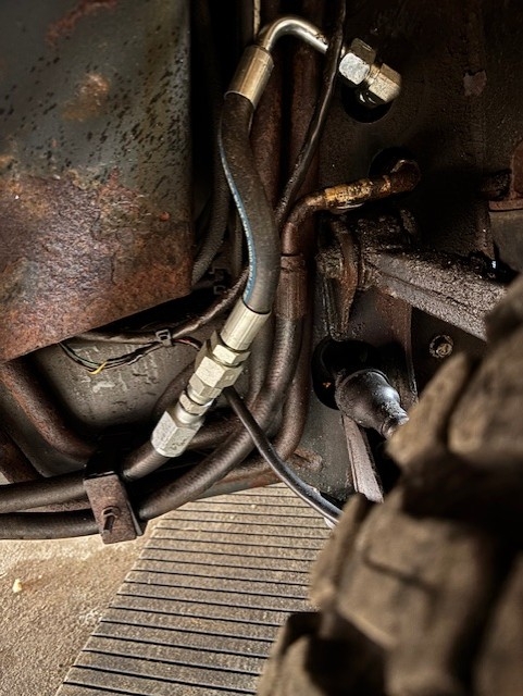

I unplugged the front top motor hose from the drive motor to see if there was flow restriction with the repair and there is plenty of oil coming out the hose. The TC was in neutral, I did not expect that much oil pressure. Still working on the hose change. The other end of the hose is in a really tough spot to get to.

We dropped the front transaxle on the floor with the drive motor. Is there a way to just test the drive motor (to see if it turns when going forward/reverse with the hoses) ? The new hoses are in place on the pump side.

No, I don't know for sure. All I know is, when I jacked the TC up, only the rear wheels were turning. But on the ground, it would move forward or backward when cold, getting warmer it would stop moving making a weird sound, then I would increase the throttle and it would start moving again and eventually stop again. It did not feel as the brakes were on. I have the front axle on the floor now. Before I open the drive motor or the axle, I am not sure what I should do next. I never to got to try it with the new hose on because the mechanic who changed the hose decided to drop the whole axle down mainly because he was not able to unscrew the bottom bolt of the drive motor. Had I been there, I would have screw the new hose on and gave it a try. Anyways, I guess I could still try the drive motor to see if it turns while it is on the ground but I have to figure out what other hoses I need to block or connect. On the drive motor, there are the 2 big hoses and then there are the 2nd speed hose and the case drain(I think), then on the axle, there are 2 hoses. I suppose, 1 for the brakes (I can probably block that one) but there is another I don't know what it is for. That's where I am at.
