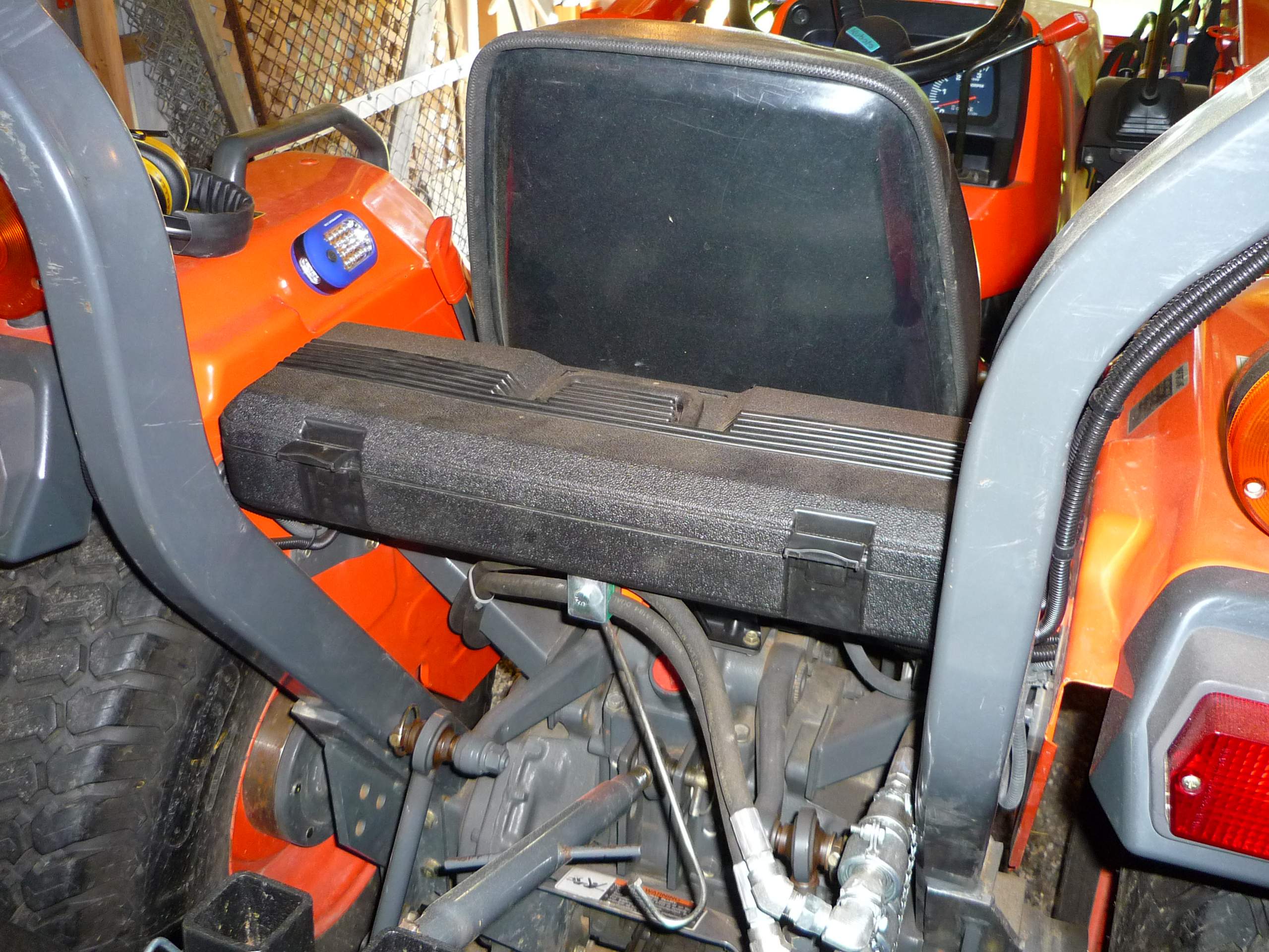

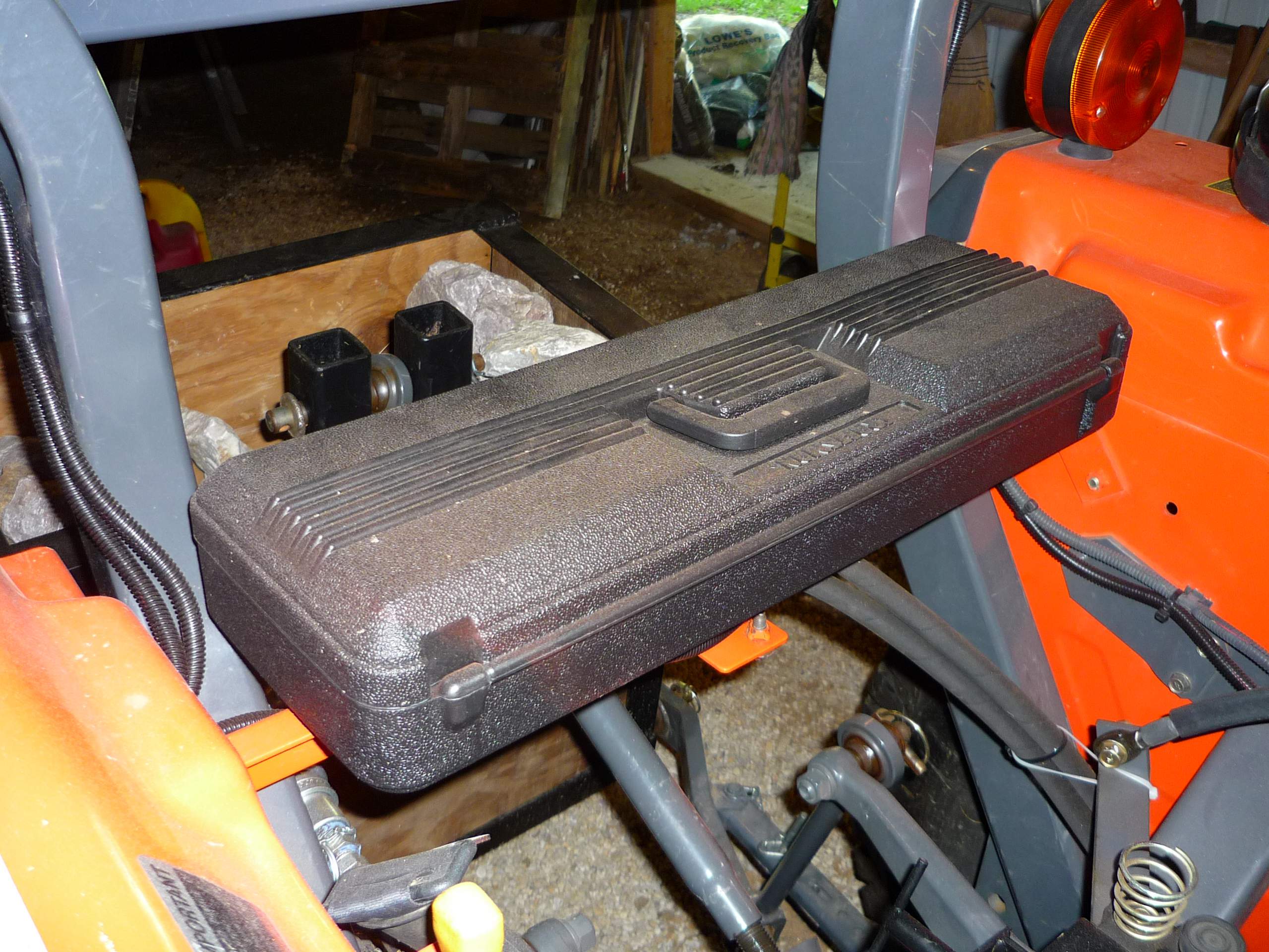

What's so special about that box other than it's orange? Based on how the holes are on the bottom I don't think it will be a direct bolt on without drilling your own holes. Plus, the step mount is at a bit of an angle to the rest of the tractor and I couldn't mount my new box straight with it so the holes I drilled are at a bit of an angle. I think I had to do that to have plenty of room to open the box. Also, that box you linked to doesn't have a removable tray that I can see, which really helps with keeping small and commonly used items separate from everything else.

I don't think you'll be able to mount directly to the frame because the hydraulic lines and filter will be in your way of opening it. I think you're going to have to drill your own holes either way you mount it. I guess my point was that you're going to have to modify either box to mount it, so what is it about that box makes you think you want to spend that much on it?

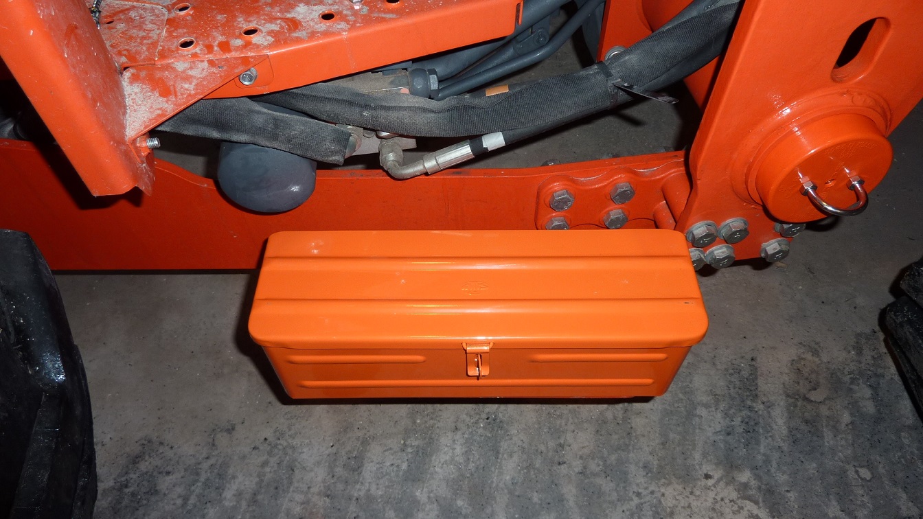

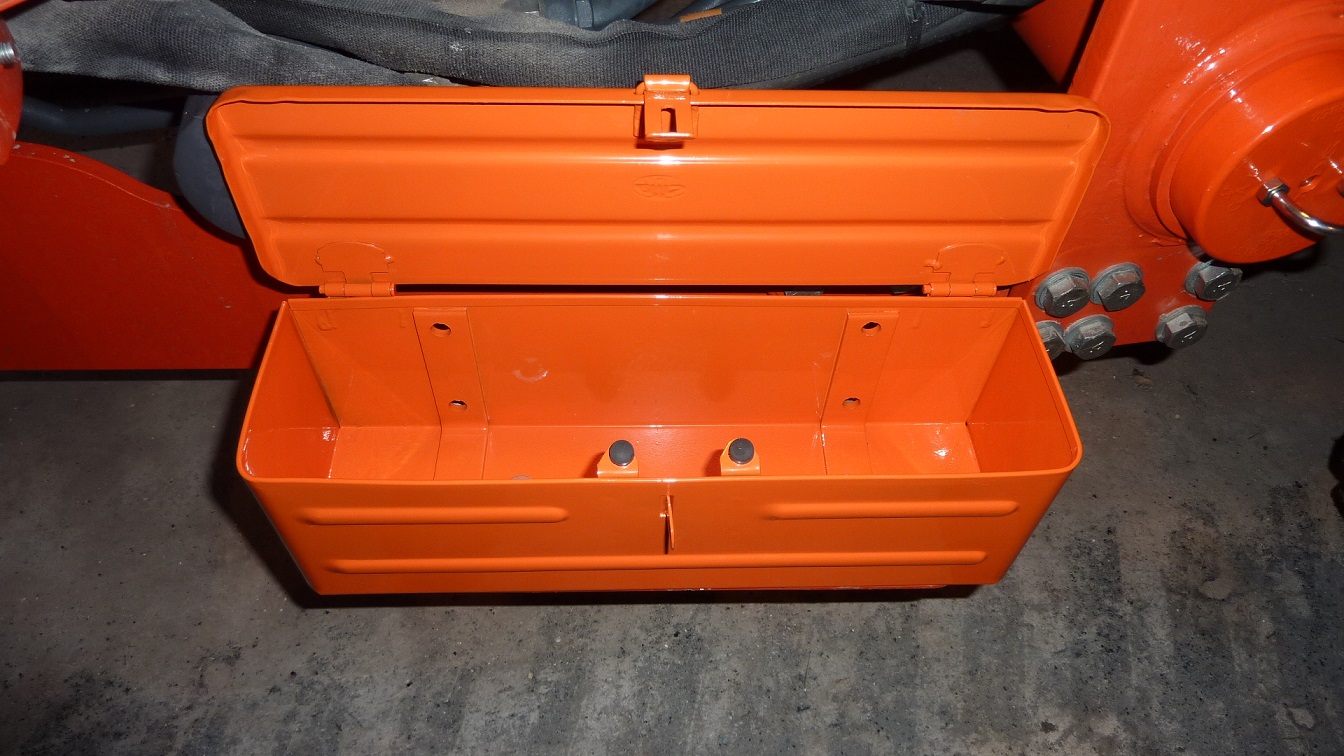

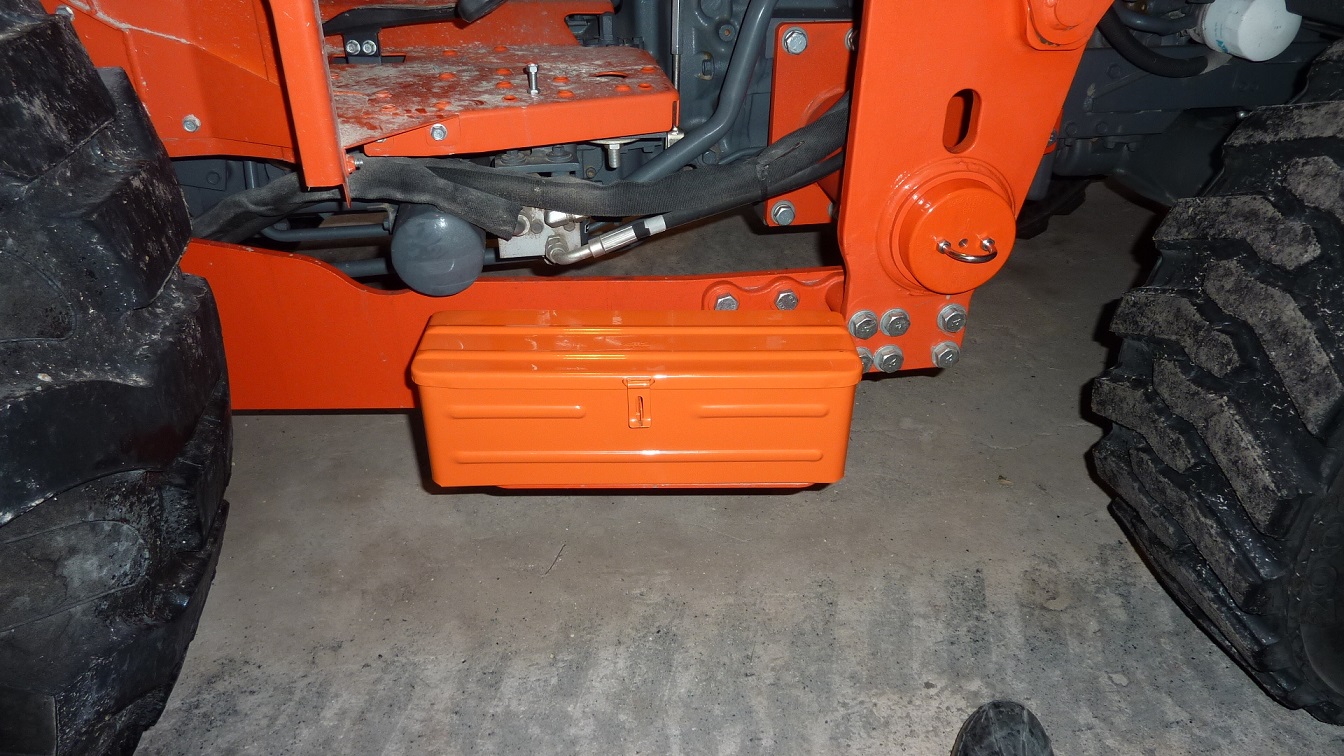

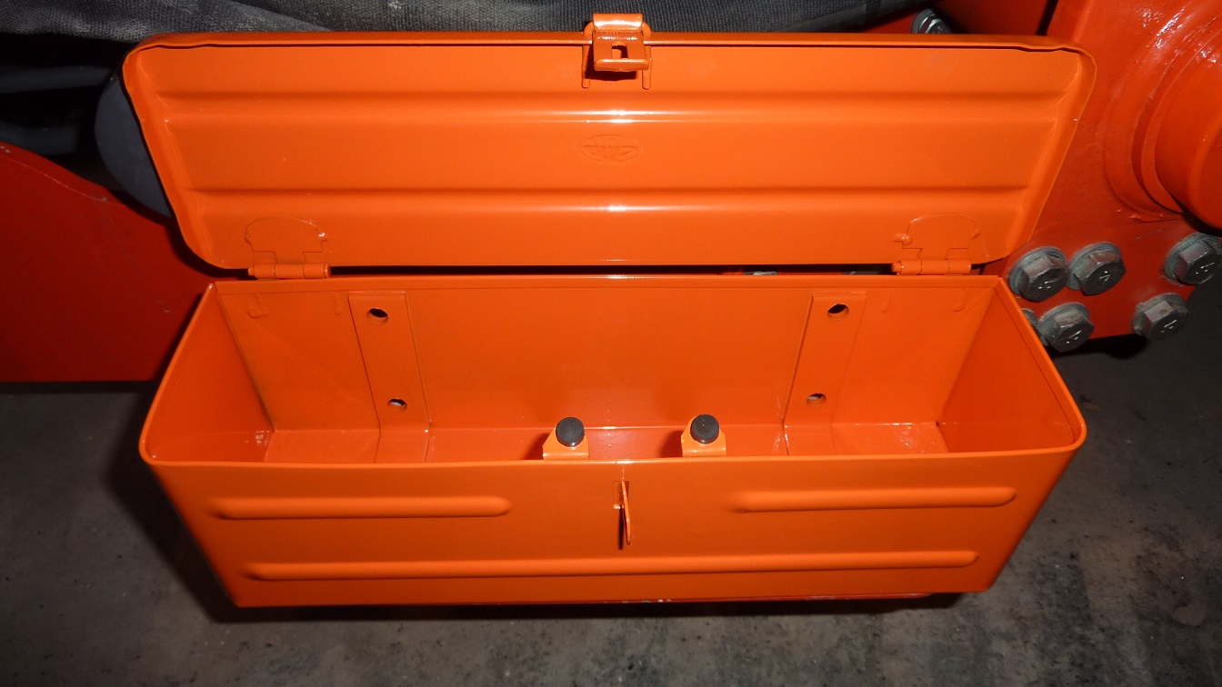

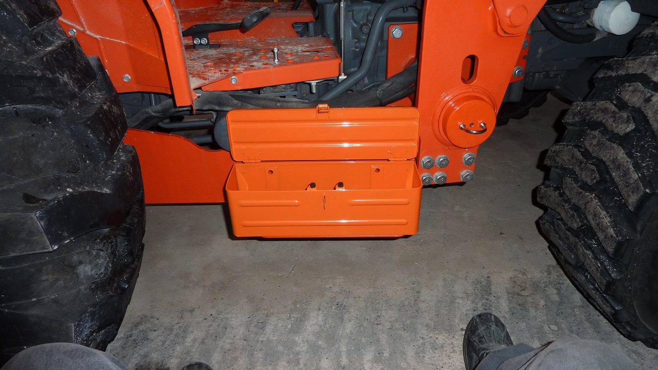

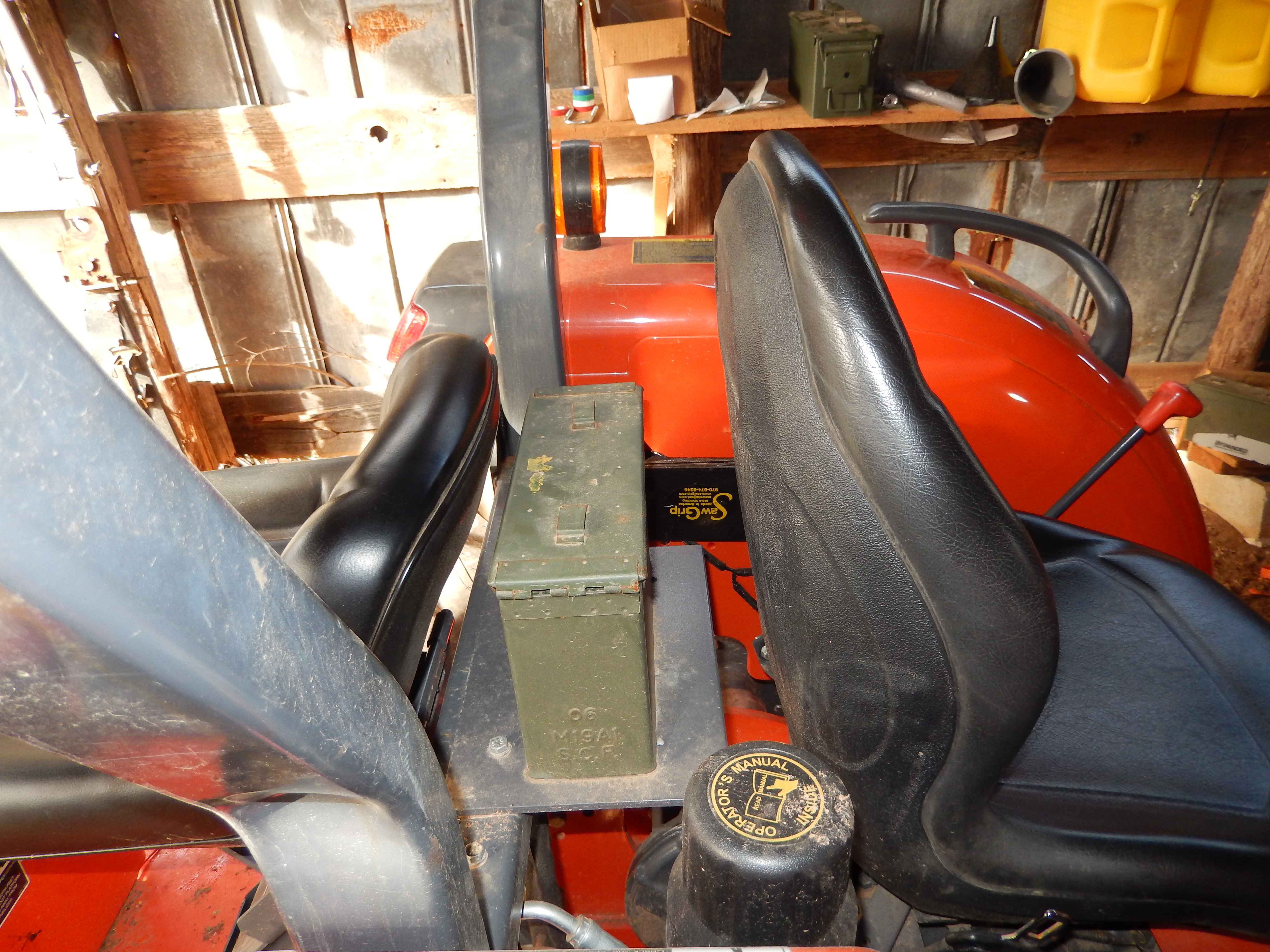

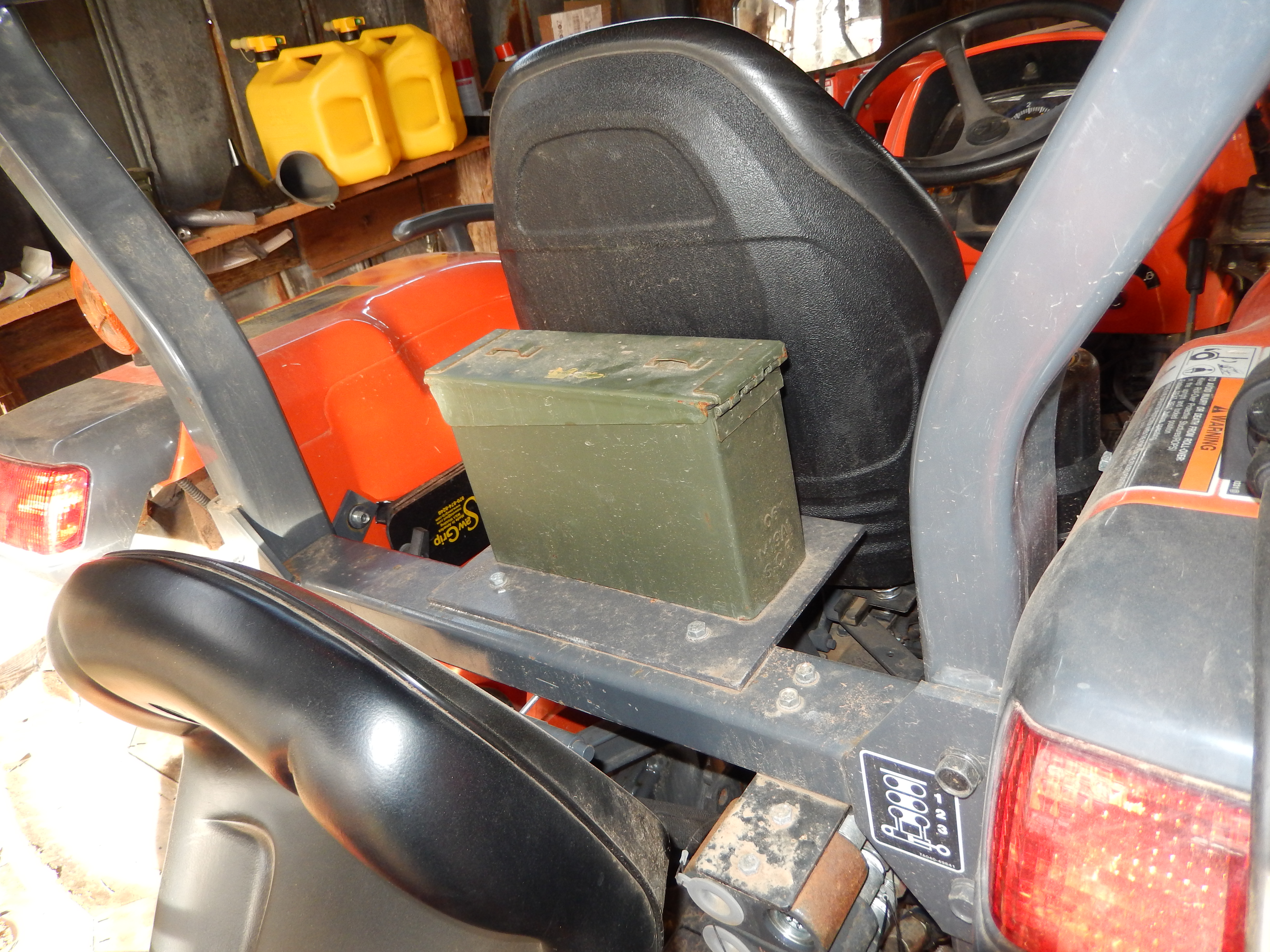

In case anyone is interested, here are a few observations on the A&I Products 5A3OR tool box: As suggested, It will not bolt to the frame of a MX where the OEM tool box is located. It does however fit the step mount used by the OEM box. It required drilling 2 - 5/16" holes in the bottom of the box and reusing the OEM bolts. It took about 10 minutes to install. The box does not extend out past the edge of the heavier gauge step mount plate and is protected from damage underneath. When mounted to the step, the 4 rear holes used for frame mounting should be plugged to help keep out dirt & debris. The box itself is heavier duty than other boxes I was considering. It is made of 18 gauge steel, weighs just under 7 pounds and feels quite robust for it's 16 1/2" L 4 1/2" W 4 1/2" D size. It also fits very well in the space occupied by the plastic OEM box on the MX and has 3 times the volume.
Is it worth the $47 pricetag? I suppose it depends on the individual. In my case, I'll wait to see how well it holds up under use before passing judgement.

The shade of orange on the tool box is a bit lighter than the standard Kubota color. Not a big deal for me considering what it's going to look like after it's first roll in the mud. Certainly not worth repainting IMO. The pics in my earlier post give a fairly accurate color comparison.
