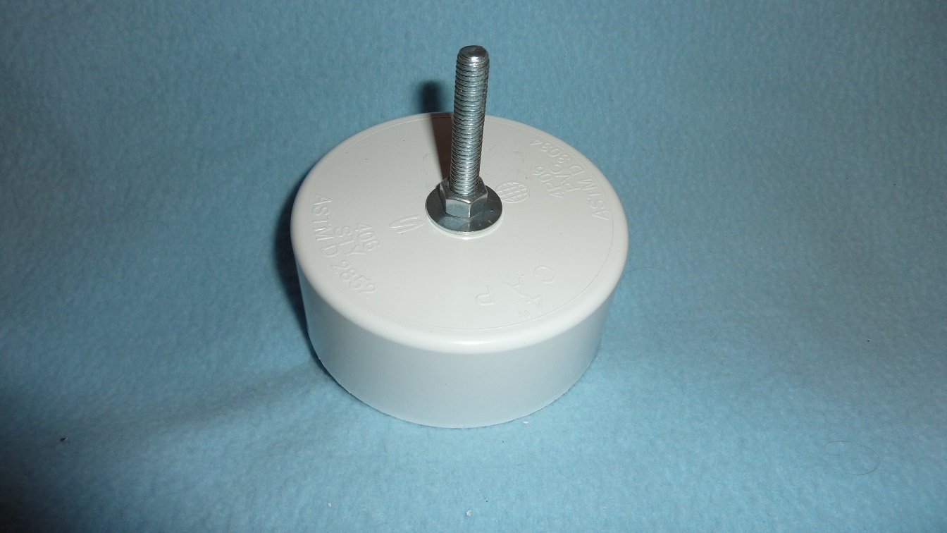

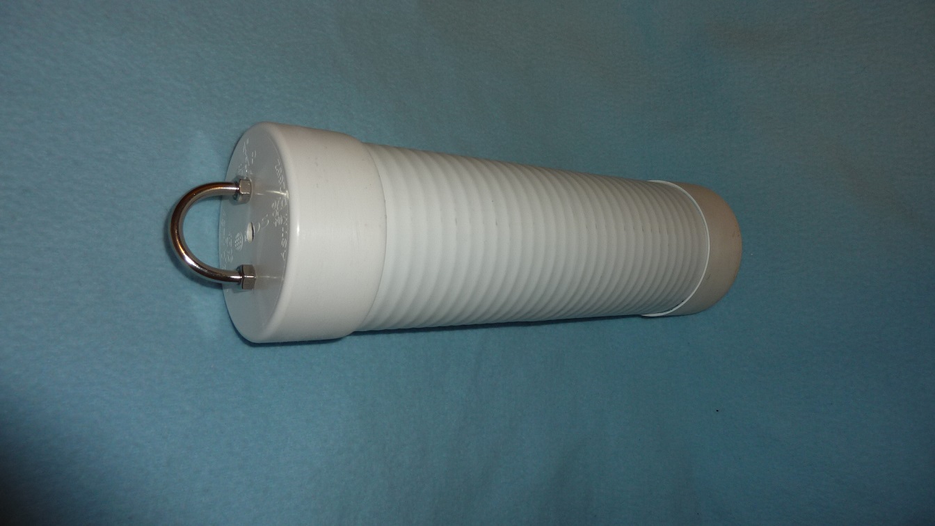

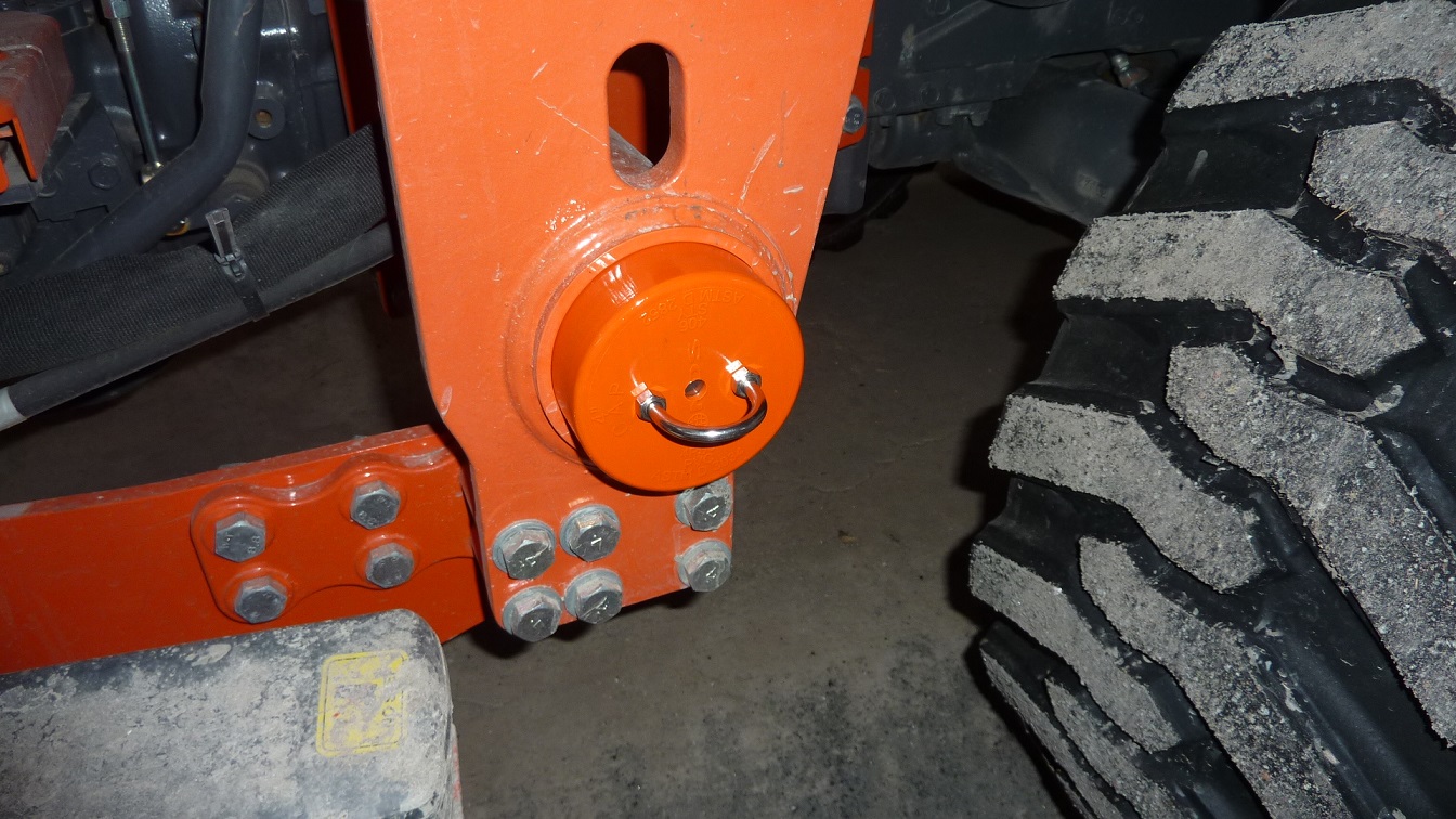

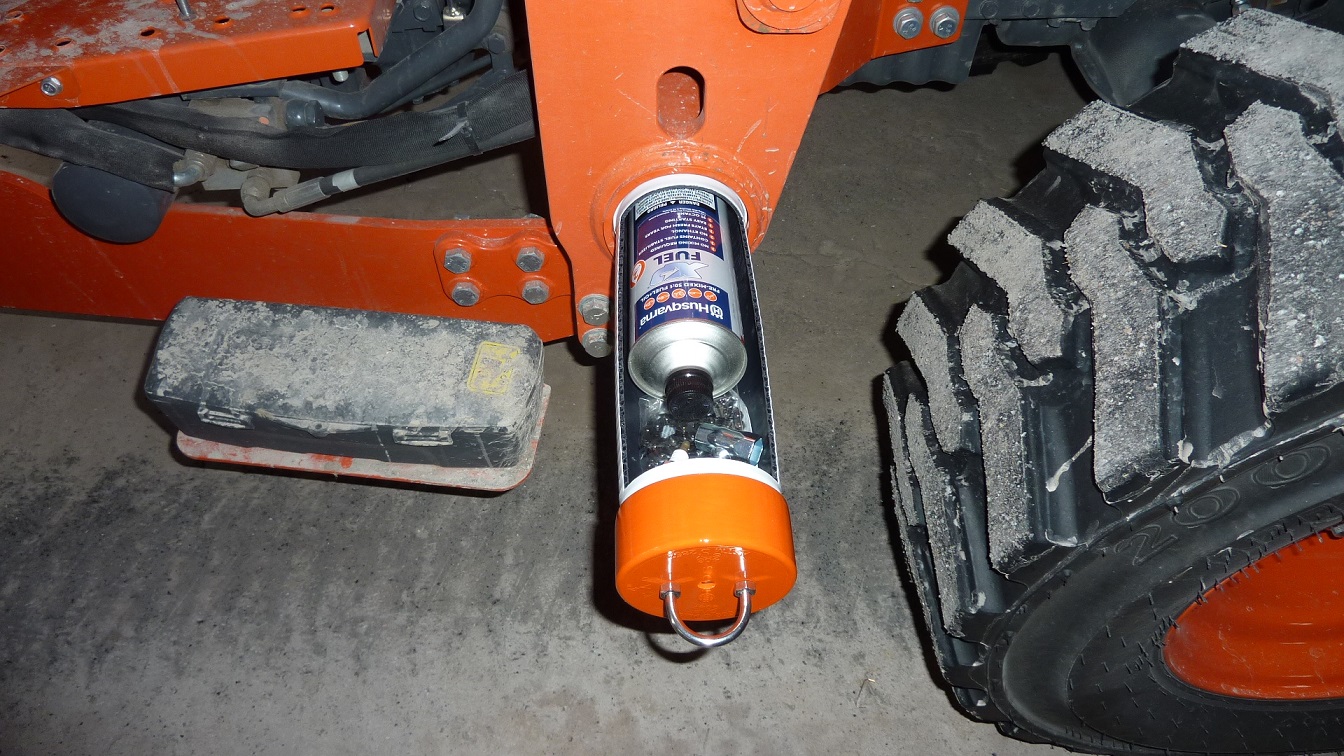

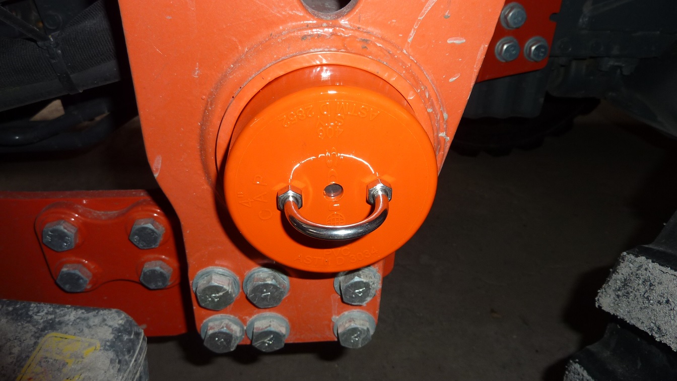

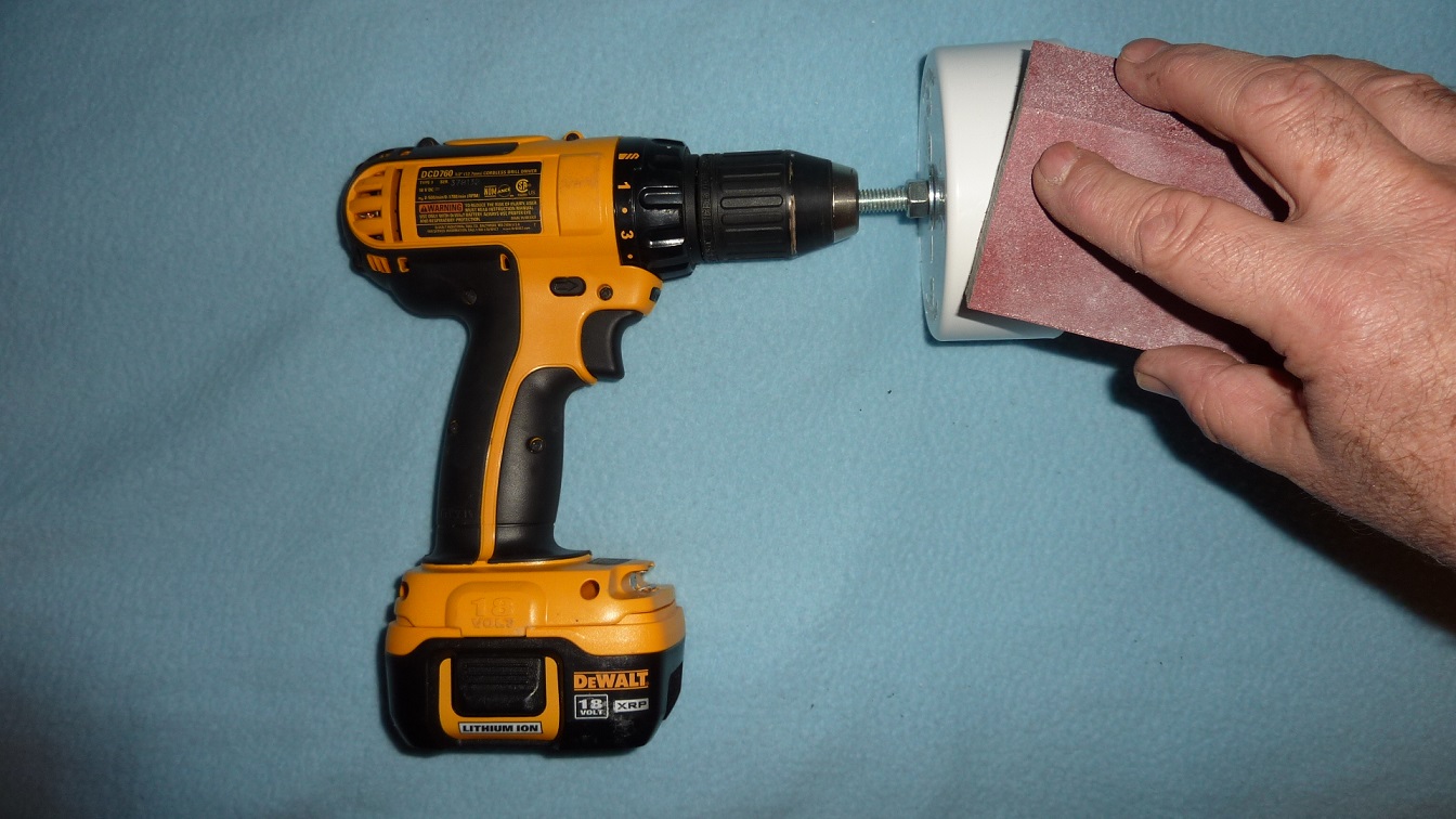

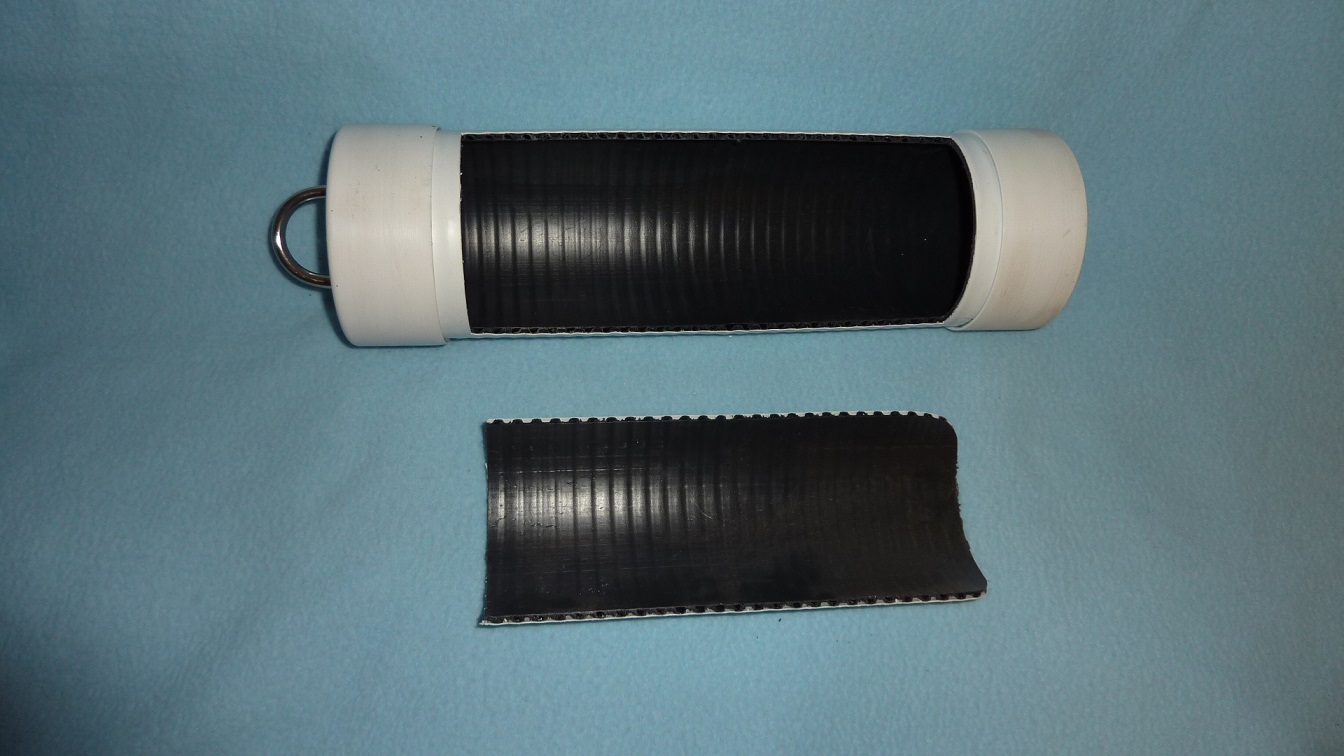

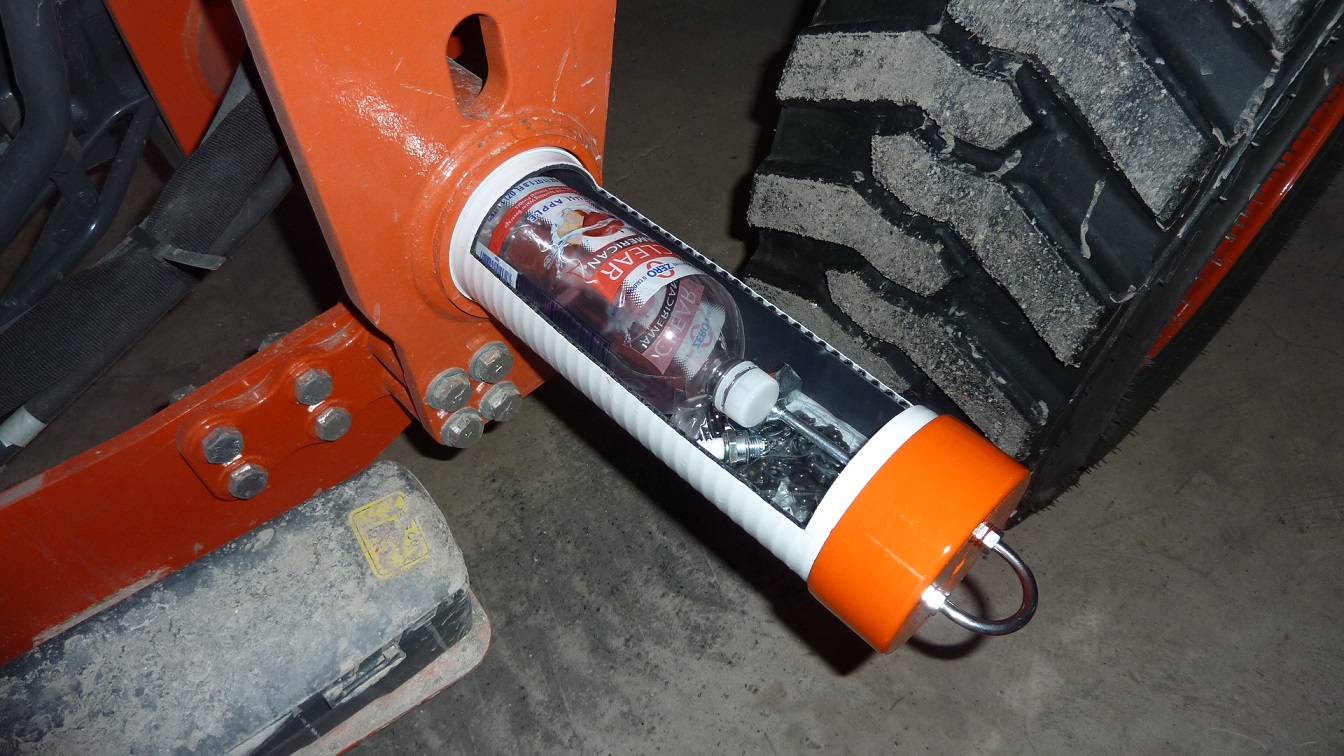

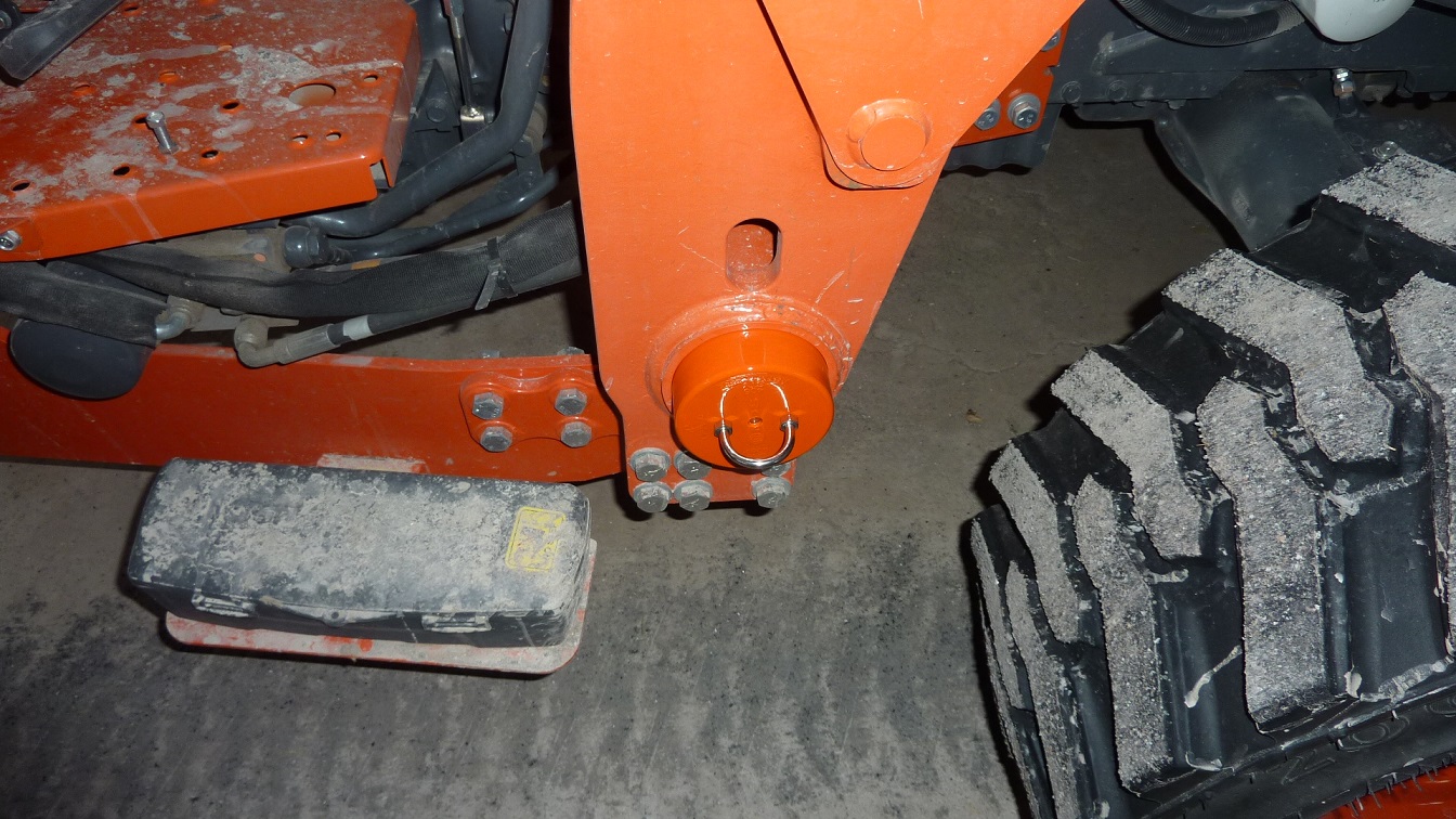

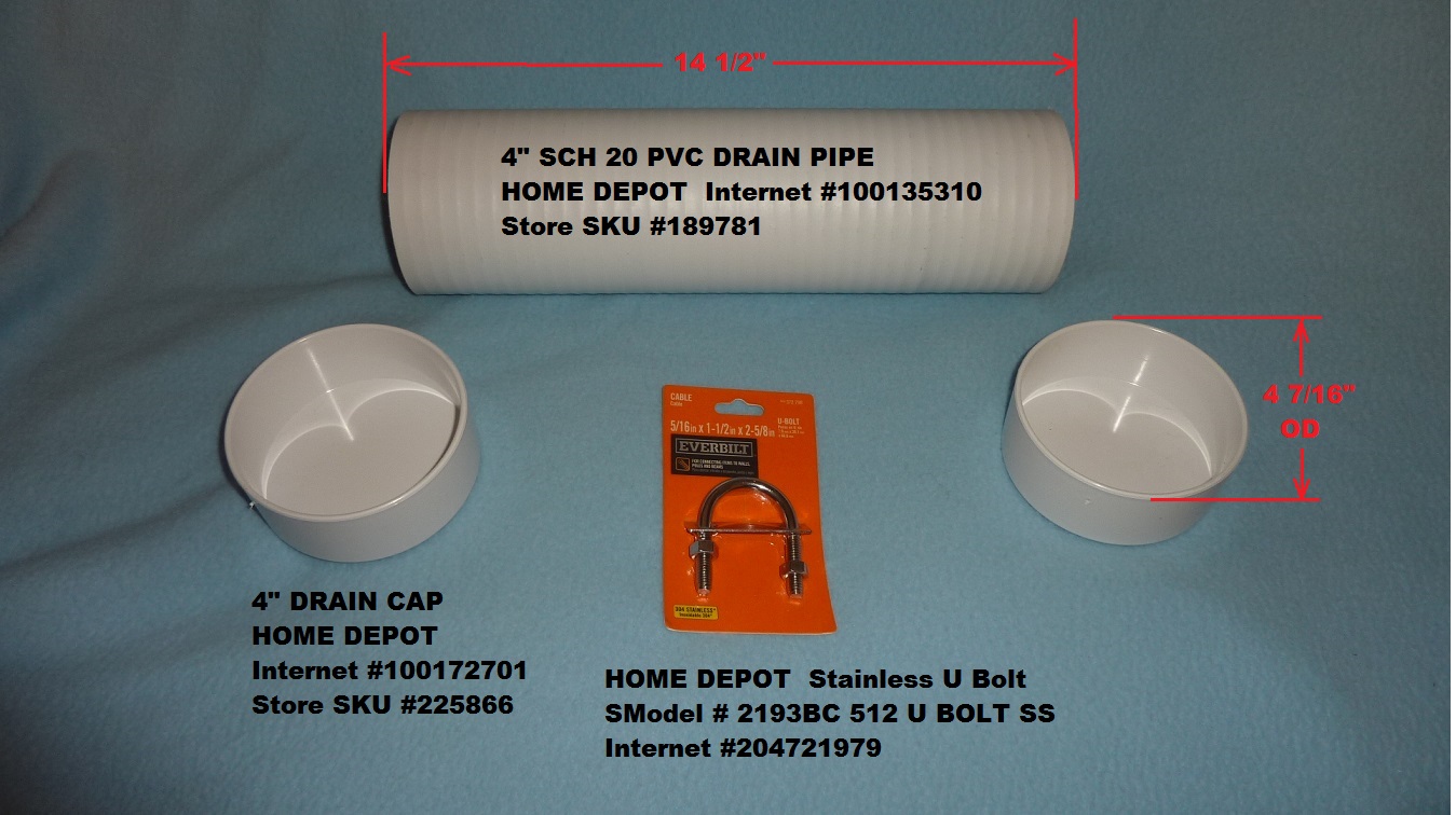

If you own an L or MX series Kubota and LAxxx Loader, here is a simple, easy tool tray project requiring 4 parts all available at Home Depot. The tray will also fit many other Kubota loader mounts with a cross tube inside diameter of 4 7/16". It took about 2 hours to make a pair of these for my MX5800 (excluding paint) and cost around $20. The Home Depot part information is shown in Pic 1. Depending on the individual tractor, some sanding of the end caps may be necessary. Check the fit before gluing the caps to the pipe (pic 4). I had to sand the caps for the right tray but the left one fit like a glove. An easy way to do this is shown in Pics 2 & 3. Check the depth of the cross tube before cutting the drain pipe. The length necessary for the MX5800 is 14 1/2"
Each tray for the MX5800 holds 183 cu in. which is actually larger than Kubota's plastic step mount tool box. It also seals tightly like a bottle cork and keeps out dust & dirt. I use mine to carry chain saw fuel, chain oil, spare parts and an extra 1 liter water bottle. Next I'll have to make up a mount to carry the saw. Some neat ideas were shown recently in another post.

Thanks for the suggestions. I've seen a lot of different schemes to utilize the wasted space inside loader cross tubes. In the past, I've blocked off both ends and used the tube to hold wrenches and other long tools. My "tray" approach lets me keep small parts handy without reaching inside. It also keeps the project cheap and simple.
4" SCH 40 PVC fittings cost more and require a lot of sanding or milling to fit inside the 4-7/16" ID cross tube. With just a little sanding, the SCH 20 fittings fit very nicely and cost just over $20 for two trays. The outside cap can easily be made to friction fit like a bottle cork yet remove easily with just a twist. I've got over 20 hours on the MX5800 so far and they haven't come loose from vibration.
