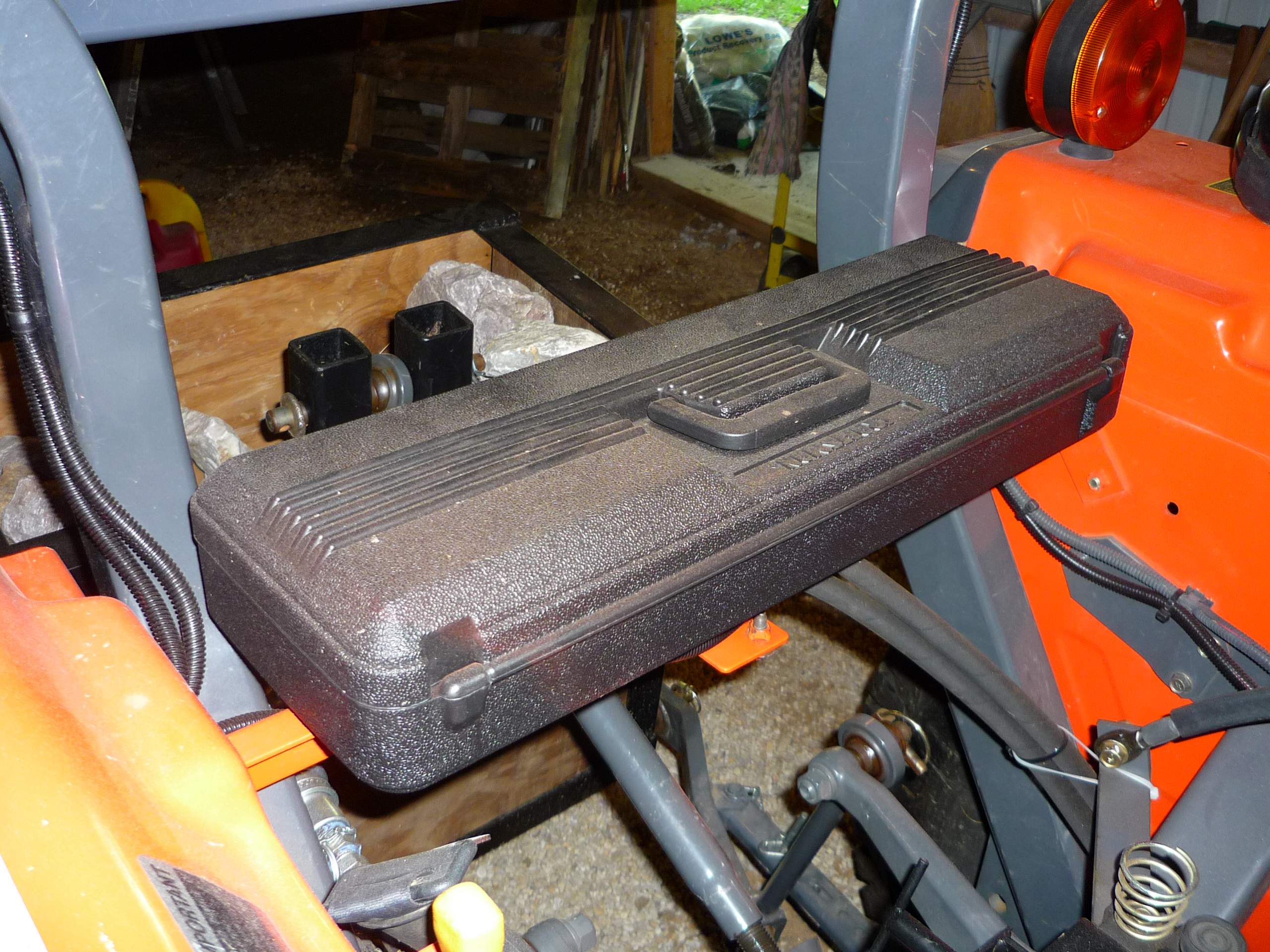

I turned an 1/8 off the diameter. It's 4-3/8 now. I think I have an idea how to lock it into the tractor I have a couple parts coming to see if it will work.

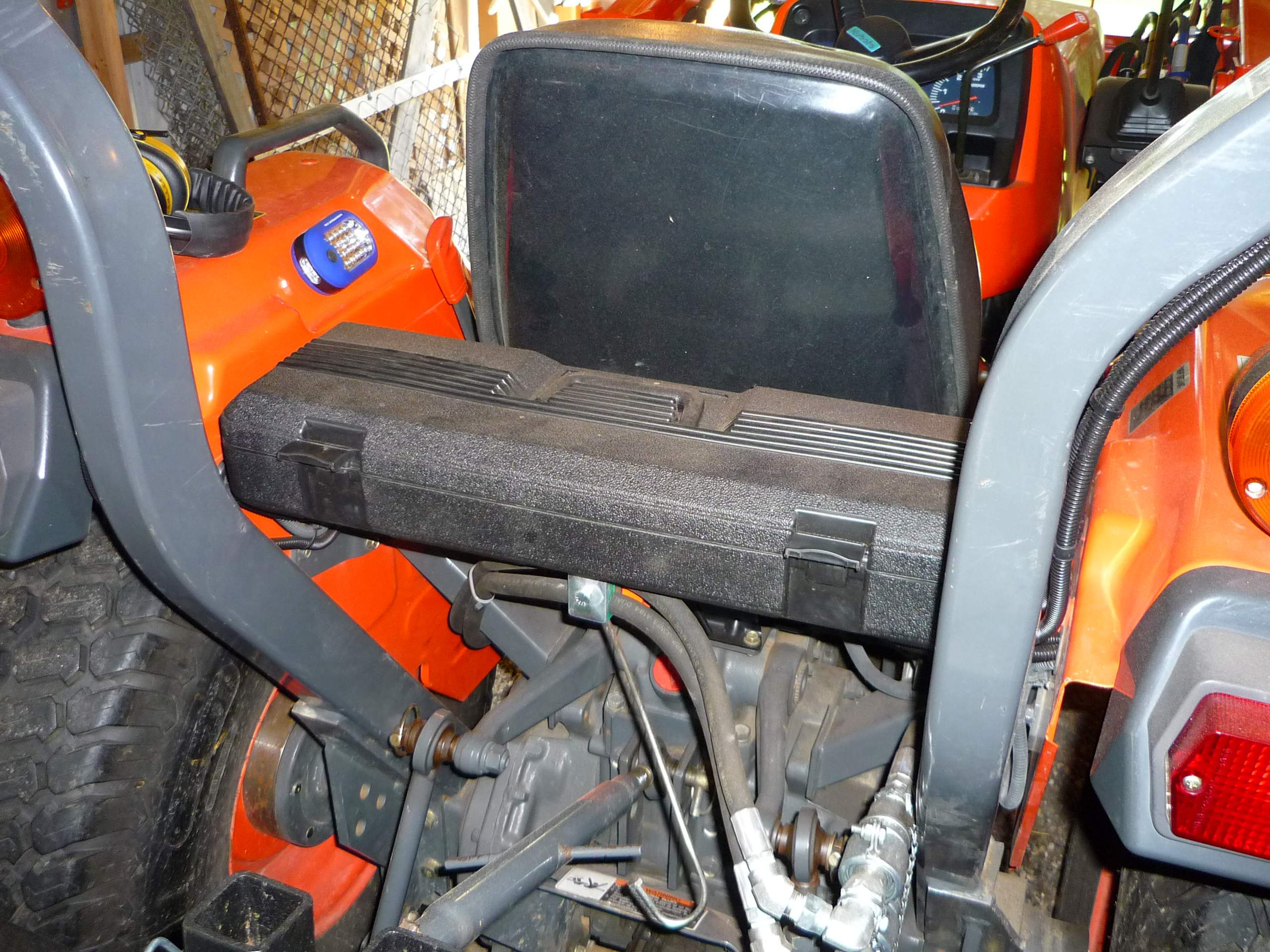

I would be concerned about a metal tool box rusting over time. Which is why I chose a plastic Craftsman toolbox, that and the cost: $10 at the store. My next little project will be figuring out a way to carry gloves and maybe a sweatshirt, keeping them from dropping off the tractor while travelling thru the woods to grandma's house.

I have that exact tool box and it is perfect for it's use. None better for most of us.

I like the way you pinned that. Looks great

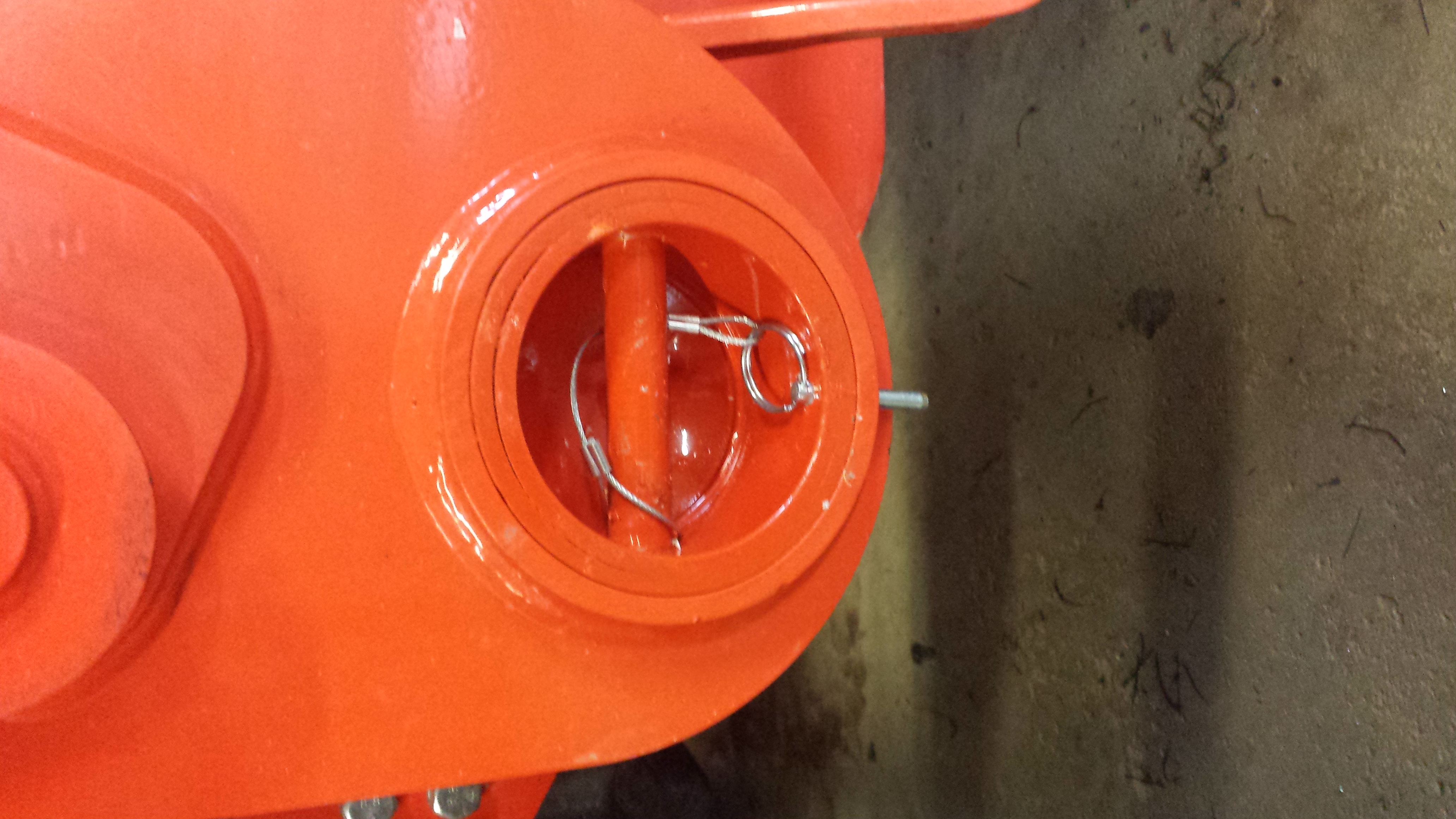

Got it finished up and painted it. Horrible idea to paint it when it fits really well without it. Had to scrap and sand all my paint back off so it fit again. I used a 1/4 cotterless pin and some 1/16 cable and some ferrules I got from Lowe's today. Turned out pretty well and now I'll always have a chain with me.
