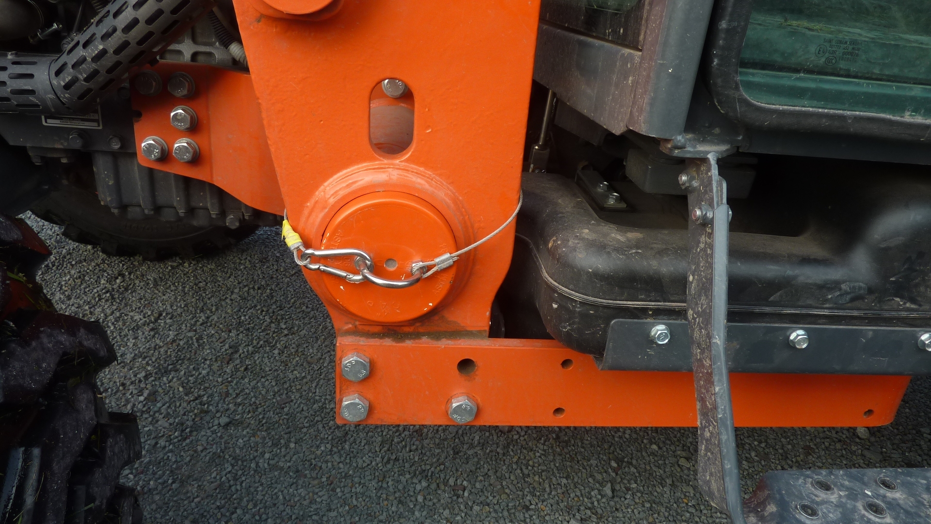

What holds it in the tube?
It's a jamb fit. Most of these cross tubes have a 4" ID. A bit of sanding may be required to get a snug fit with 4" sched 20 end cap.
As a precaution, I use a short piece of stainless wire:
I have 8 of them on the cross tubes of both my tractors and have never had one come loose.
