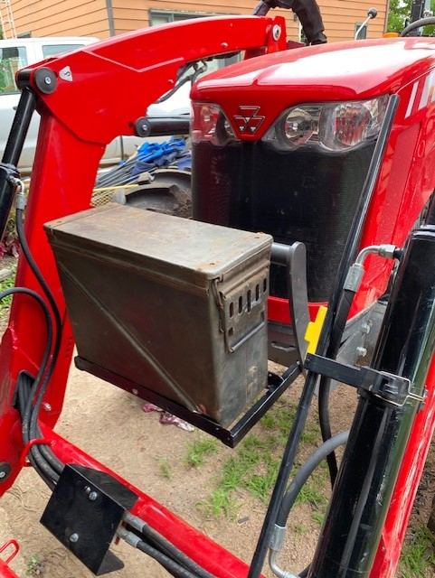

The tool box that Massey put on this tractor is ok for a screwdriver, crescent wrench and a pliers, but not much more, so I did this.
The box is some kind of ammo box and the frame holding it is 1/8 X 1 " angle iron mounted to the radiator guard with 3/8" bolts. Just to prove a point, I put all my weight on it, (200#s) tomake sure it wouldnt fall off.

Interesting...can't recall seeing toolbox attach like that with front loader.

That’s a nice big one. My tractors don’t have the clearance between the grill guard and FEL. Used 50cal boxes bolted to the ROPS. Carrying tools is essential for tractor work.
One note of caution is being under the FEL without a prop is risky. Commercial construction equipment usually has a easy to deploy brace on their loaders. Wish ag tractors would follow the same safety guidelines.

I totally agree that being under the FEL is not good practice, I avoid going there. I lower the FEL to the ground before accessing the box, it's just easier, so I'm not tempted to get under the loader.

Interesting. The Workmaster 40 has no toolbox at all, and I ordered an ammo box with the idea to do the same thing, since the loader sits far out in front of the tractor. Then thought maybe mount it elsewhere, but when it gets here I'll see if it works there..

If you would like, I will take some more pictures of how I mounted it and the framework holding the box.
